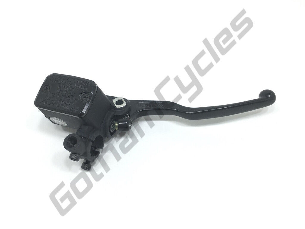

            Brembo 16mm with no mirror mount. Nice part.
            https://www.ebay.com/itm/33333609101...Bk9SR7LBg_ThYw
              No doubt. I've been running one for 10 years and it still performs and looks like brand new. This was recommended to me by vintage brake guru Michael "Mercury" Morse of vintage brakes as an excellent upgrade for the Special's lackluster brakes. The unit is powdercoated so no paint to peel off through the years. That front mounting bracket can also be swapped out for a L or R hand threaded mirror mount.

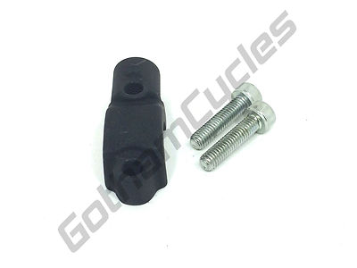

                  Clamp/mirror mount.
                  https://www.ebay.com/itm/35265388720...cAAOSwKrhVXH3U
                    You won't regret it, it has such an overall quality linear feel at the level. Too bad it isn't offered in a 14mm which is the optimal match for the Standard's calipers. I'm running the 13mm version on my Standard, lever is a tad mushy, but still has excellent stopping power. I can lock the front wheel at 40 mph if needed.

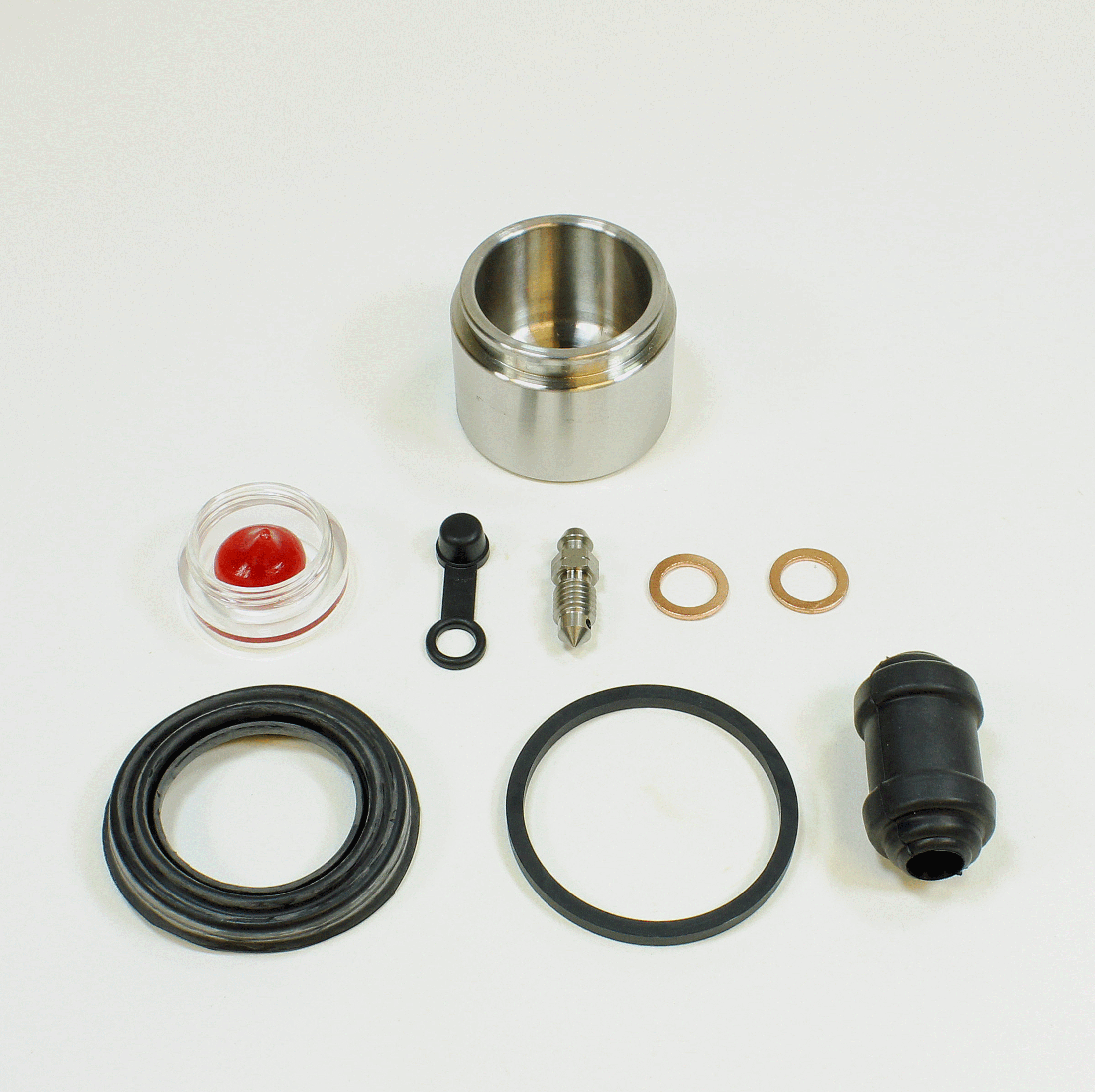

                      Since I will need to rebuild my calipers has anyone used Brake Crafters? I like that it comes with a stainless steel piston.
                      BrakeCrafters front brake caliper rebuild kit with stainless steel piston for select 1978-1983 Yamaha Virago 750, XS1100, more.
                        Phil, you talked me into it. It's on the way. Thanks.
                          Dave, yes I have used product from Brakecrafters and it's top notch stuff.
