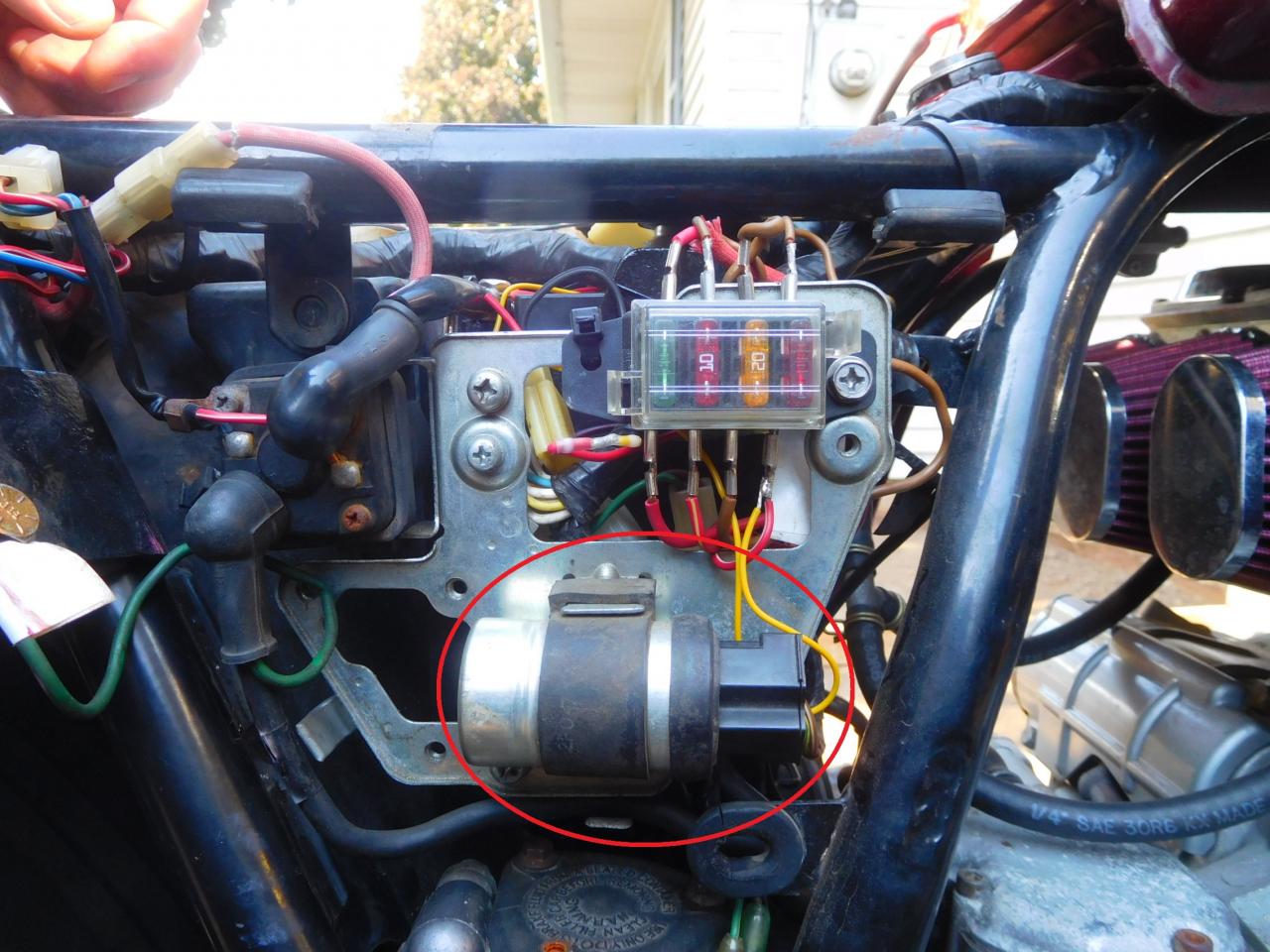

    Could be a bad flasher unit.

      I put a two prong flasher no change. the flasher only has one hot wire is that the way it should be? my wiring set up is just like yours. the blinkers worked great before I worked on bike.

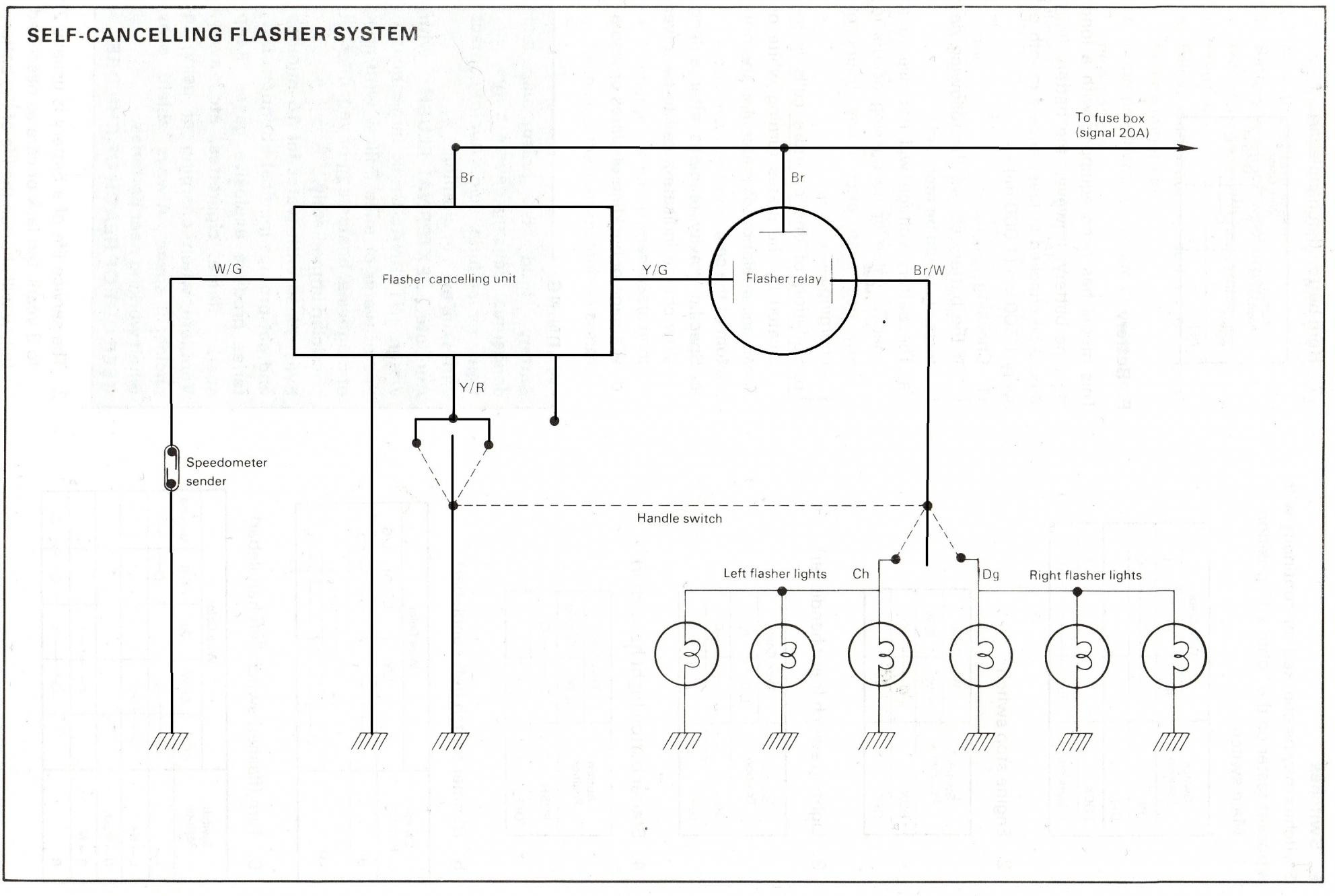

                      • 2058
                      This is the circuit.
