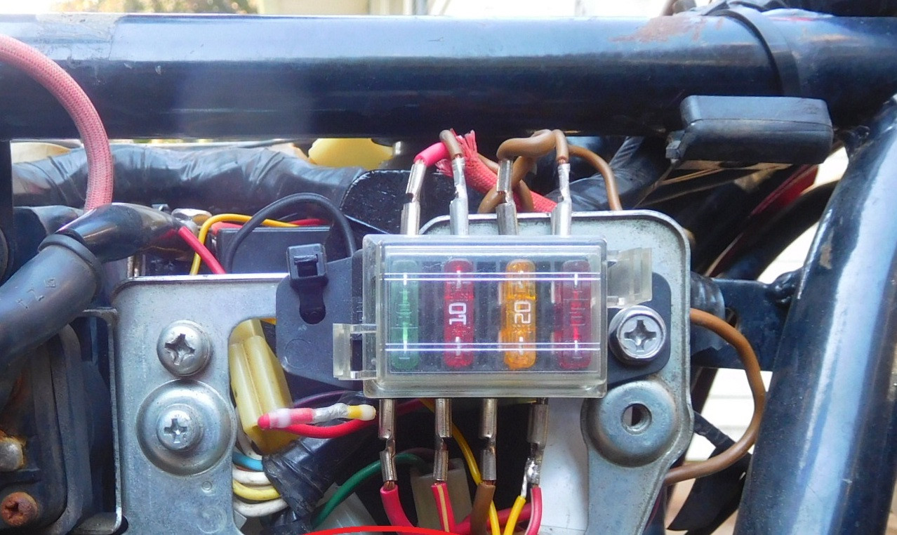

no blinkers on my 1979 xs1100f
    https://www.ebay.com/itm/143445206467
    Click image for larger version  Name:	fuse.jpg Views:	0 Size:	138.2 KB ID:	878748 Click image for larger version  Name:	DSCN0796A.JPG Views:	0 Size:	289.0 KB ID:	878749
    • roger
      • 52
      • al
      well i don't know how but the right rear is blinking, now if i can get the rest to work. help if you can. thanks

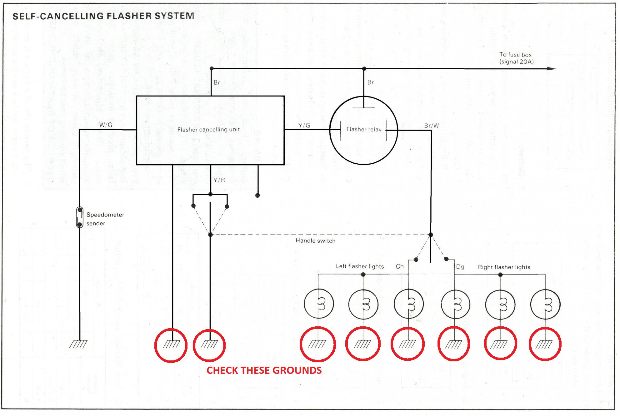

        • 7844
        CHECK ALL GROUND CONNECTIONS!! 90% of the time, that is the problem. Each light has it's own ground wire between the lamp and the frame. Rust will cause a problem, keeping the ground from working properly.

            I cleaned all the grounds i could find. there is only one black wire coming out of the fairing it was loose when i first started and i bolted it to the frame. nothing changed.
              Roger, also keep in mind the system won't flash if a bulb is open. Check the bulbs and the sockets.
