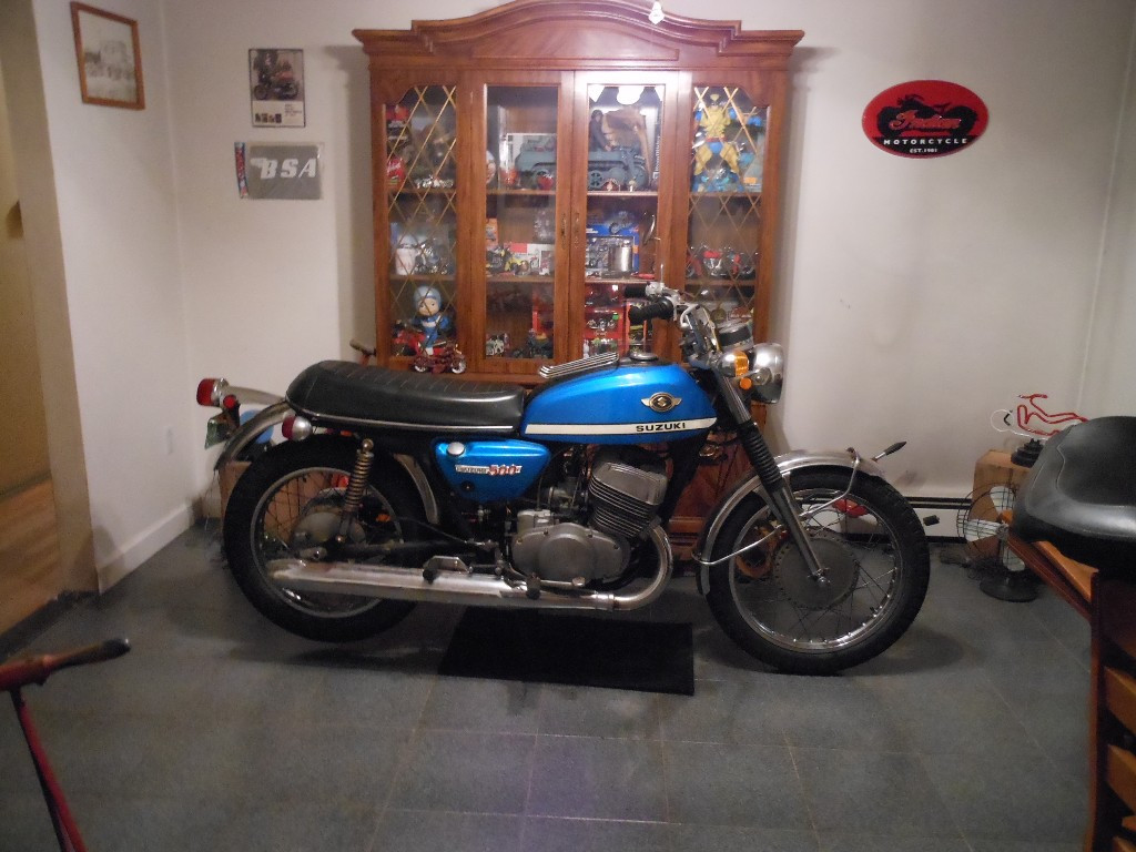

          Nice clean workshop.
            • 1895
            His workshop is the reason I am single.

                I got lucky and found a wife that's as into bikes as me XD Took 37 years though...
