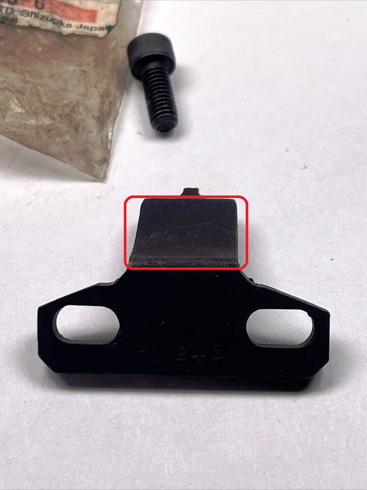

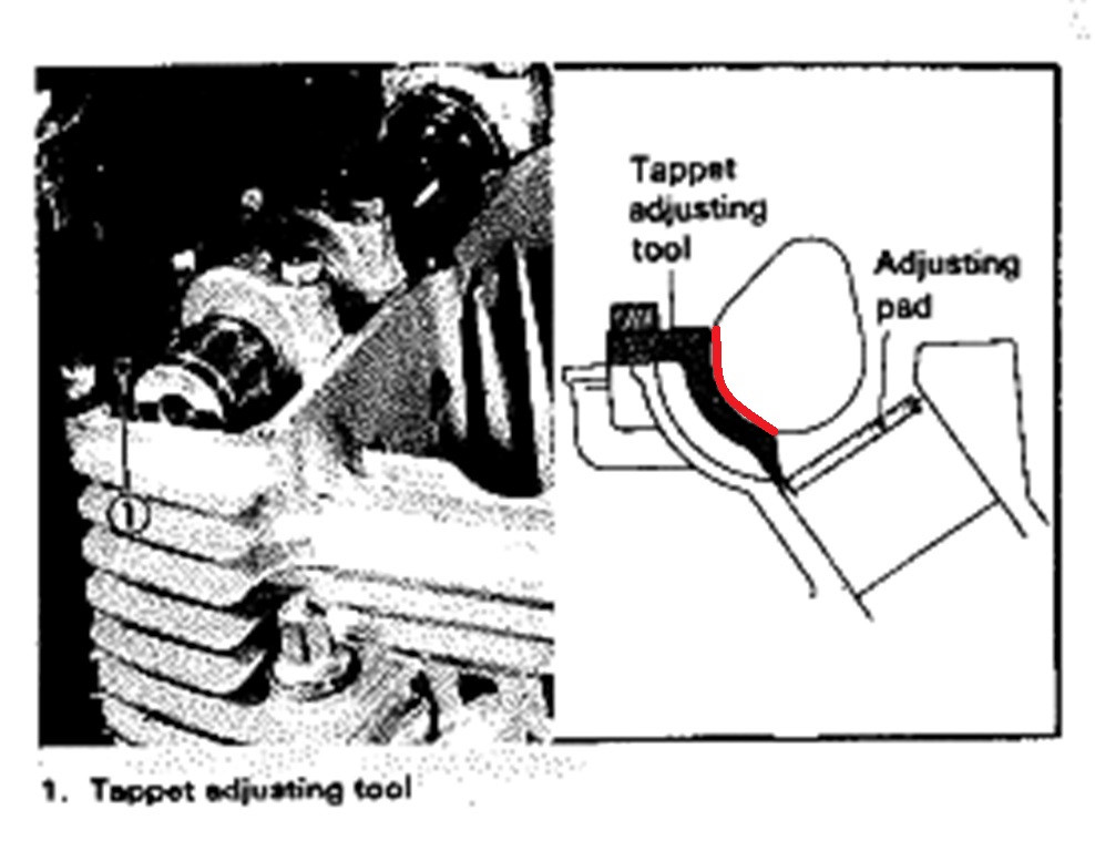

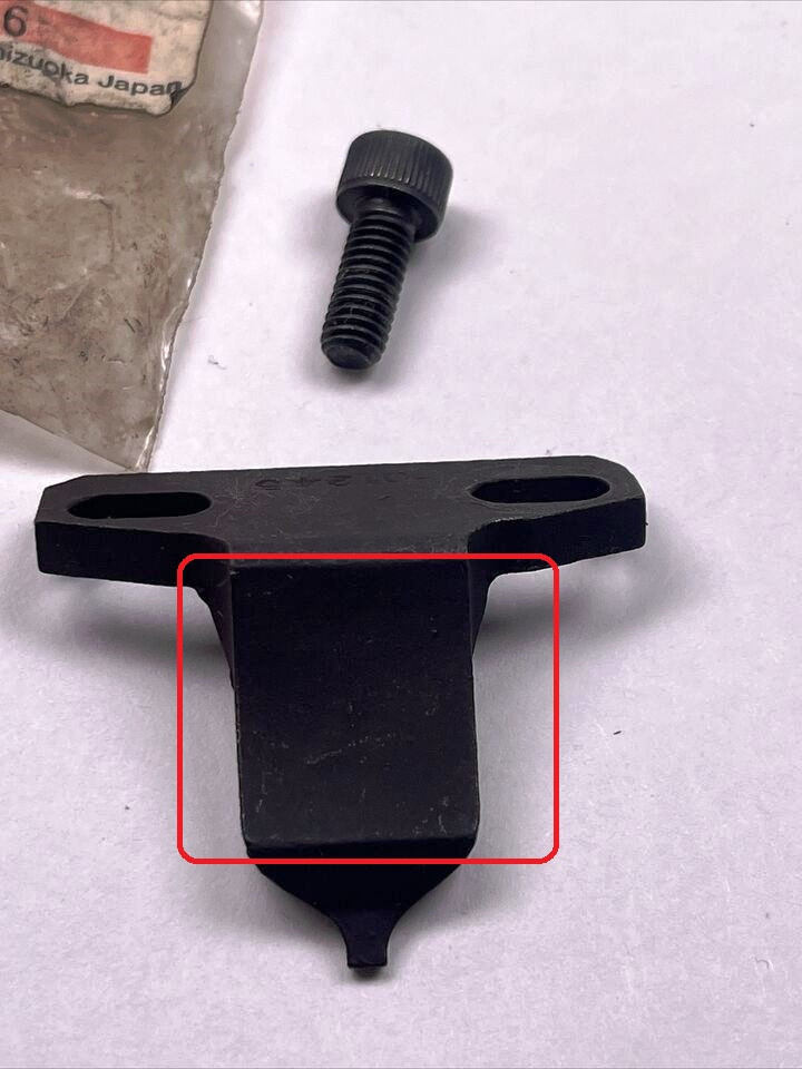

        It should be mentioned that most valve adjustment tools for the XS11 come from Motion Pro. Cheap stuff. The material is not quality tool steel like it should be and the areas that I marked in red are built up for added strength which, unfortunately, renders them useless. They simply won't fit. If you search the forum you will find some people will grind the tool down so that it will fit. It is best to buy a quality tool or use the zip tie method. When it comes in, try it and see if it works.
        Click image for larger version  Name:	toolc.jpg Views:	0 Size:	107.9 KB ID:	878442 Click image for larger version  Name:	toolb.jpg Views:	0 Size:	112.5 KB ID:	878443 Click image for larger version  Name:	toola.jpg Views:	0 Size:	201.7 KB ID:	878444

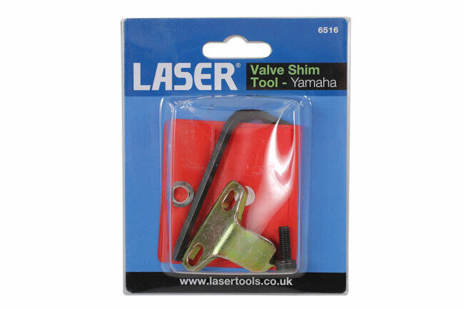

          A better quality tool.
          https://www.ebay.com/itm/18199851391...Bk9SR5K6zrjKYw
