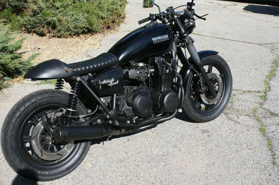

    Hello y’all, I’m new to the forum and Yamahas in general. I’ve worked on a few classic bikes before but they’ve all been Hondas. I haven’t had a bike for the past 2 years after shattering my ankle, but I’ve gotten the itch again so I started looking and stumbled into this absolute treasure.
    I saw it for sale and I knew I had to have it. With a jump pack and a shot of starter fluid, bike fired right up. I plan on slowly restoring it while riding it, since most of what it needs are cosmetics. With that being said, it does need a bit of mechanical work before I can get it on the road, namely the calipers are all sticking and the tank was disconnected from the carbs.
    I just wanna double check the placement of the hoses coming out of the petcocks. When I picked up the bike the crossover line was connected to the front outlet and the small tube that went to the carbs was on the back outlet. I couldn’t really get them lined up properly in that same orientation with the clamps I have (which I do plan on swapping for more oem style ones later, if someone can let me know what that would be) so I swapped them around. Is there a correct order to them? I haven’t connected them to the carbs yet, I just got a bit of work done on it this morning before work, but I’m getting gas on the way home and going to try and get it to fire up this evening.
    Any words of wisdom on how to get the gold accents redone as close to as factory as possible would also be appreciated, but that probably won’t be till after I’ve ridden it for a couple months.

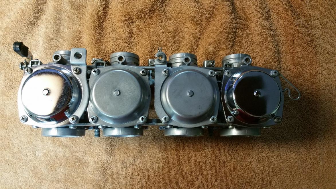

              Anywho, I got the carbs off today. Previous owner claimed a shop had gone through them two years ago and got them rebuilt and tuned correctly. With how easily everything came undone I believe it, didn’t even have to tap out the aluminum rods holding on the floats, I was just able to pull them out. The slides and diaphragms were still in great shape, some of the jets were clogged but nothing a bit of chemtool and thin copper wire couldn’t solve.
              My main concern now is that the needles and seats didn’t look to be in too bad of a shape. With how badly the carbs flooded, I imagined they were going to look a lot worse. I did already order a replacement for them regardless, but is there anything else that would cause the carbs to flood to the point of also flooding the intake box?

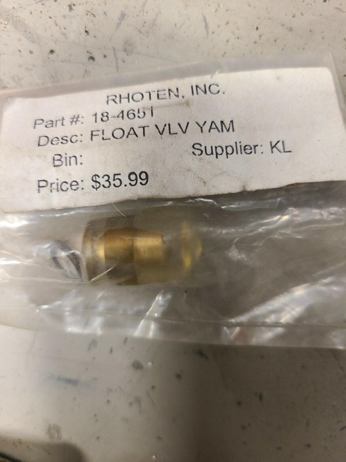

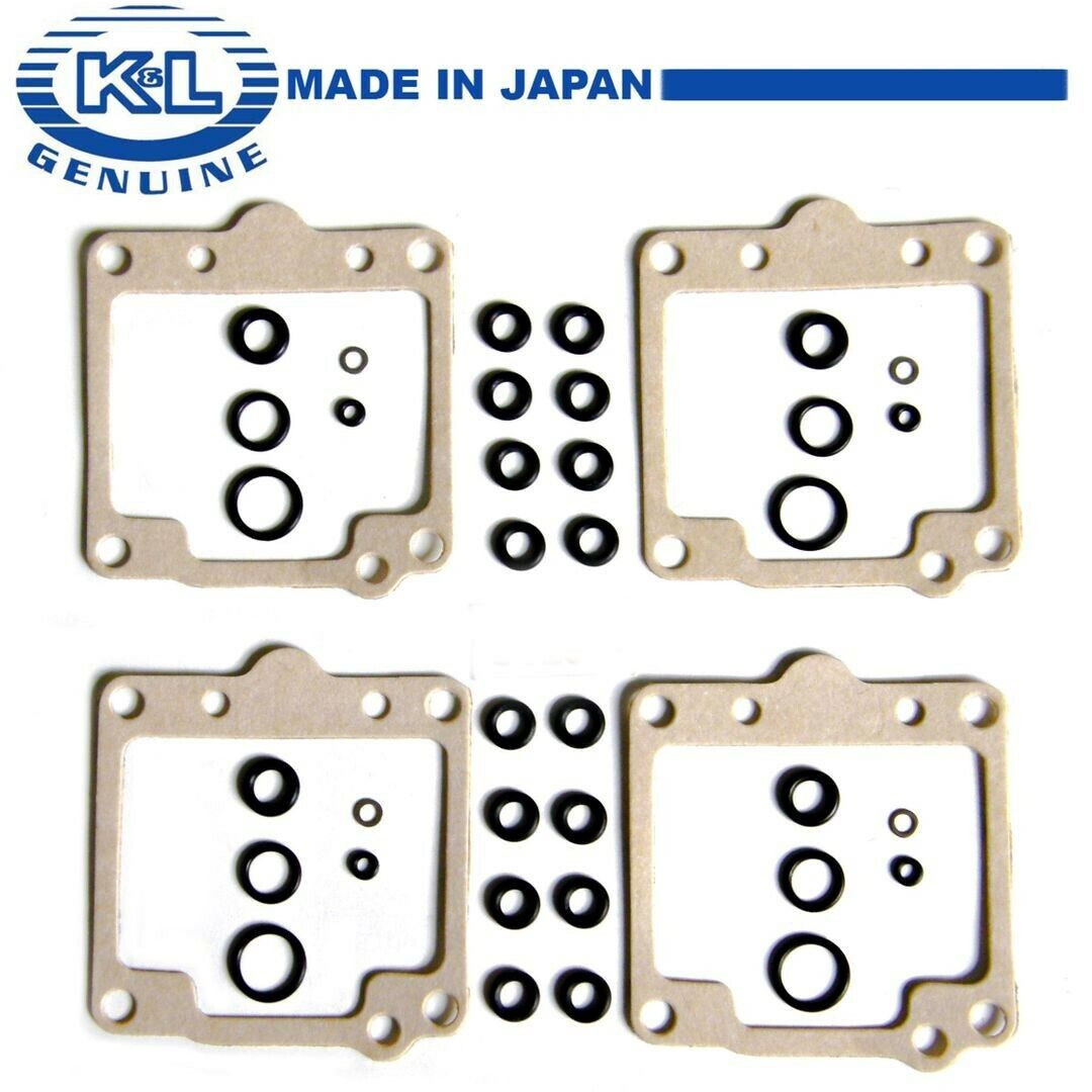

                This is a quality Japanese kit that I am presently running in my XS11.
                https://www.ebay.com/itm/352927647481

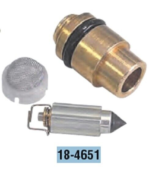

                  And these are genuine Yamaha seats. Arguably the most important part in the carb. Do NOT use aftermarket.
                  https://www.ebay.com/itm/29316334171...Bk9SR9iNuraTYw
                  Click image for larger version  Name:	s-l1600 (14).jpg Views:	0 Size:	37.6 KB ID:	876583
                    I agree when restoring a bike if it comes to you stock then you should leave it stock as so many bikes are ruined by amateur modifications. However, in the case of your missing "Octy" you may want to replace the petcock with a simple manual unit. These only the fit Specials with no air box if that is what you presently have. (I do see a stock air box in your photo so if you keep it this part would not work. It would hit the airbox.)
                      I had to do my research on this. K&L is a company based in California. You can google them and actually can download their catalog. The company that lists these parts in this particular Ebay listing is just sourcing and reselling the same parts that come in the K&L carburetor kits. Such as these that GeorgeFix sells. The seats and needles and filters are the same in the K&L kits. They are all made in Japan. Stating they are Mikuni in this listing is just a way to make people believe they are different. If they are indeed different the kits say as good as oem. These kits 4 Carb kits 81 XS1100SH SPECIAL 80-81 XS1100LG XS1100LH MIDNIGHT SPECIAL 18-2606 | eBay have those same seats and needles included in them as well as everything else needed for the carbs. The only things I don't use out of these kits are the jets. I have tried them just as an experiment to see if I could make them work and they do, but the carbs are just easier to tune and synch with original jets sourced from places such as JetsRus.

                        If there isn't any heavy corrosion or other physical damage the o-rings and bowl gaskets are all you really need.
                          I stand corrected Cajun31. The main clue is the superimposed part number on the photo. it crosses to a K&L part. Japanese made but not OEM Yamaha.

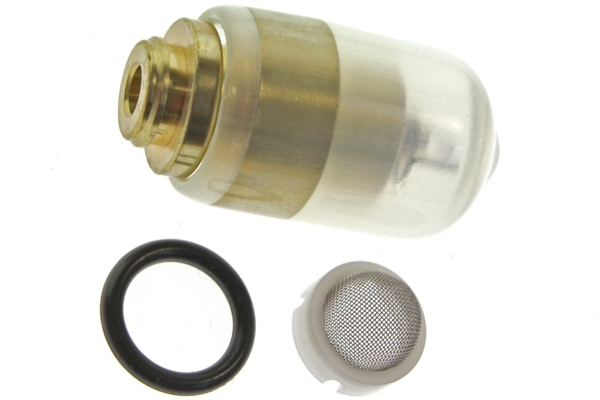

                            OK These are OEM Yamaha/Mikuni.
                            https://www.partzilla.com/product/ya...7a911be38f78bb

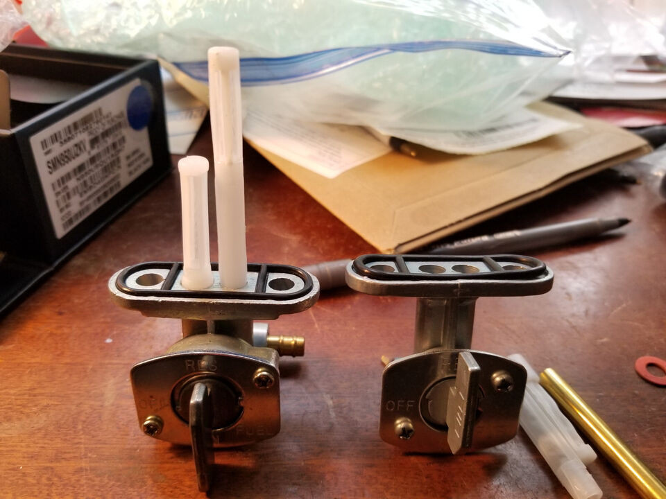

                              Just wanted to specifically address some of your questions. Looking at the pictures you posted one of the needles looks like the pin in the end of it is stuck down. That happens when varnish gets in them. You stated you will be replacing all of those anyway. When those pins do not compress and release properly they can cause float level / gas level issues. If you have not already done so make sure you read the carb cleaning tip that is posted in the carburetor repairs section Carb Cleaning 101 - XS11.club Forums. Your float heights should be set at 23mm or just go by what Kat says about the plastic floats. the key is to set them all with the float bowl gasket removed. There is another method to set the fuel level and there is another tip Setting the Carburator Float Height - XS11.club Forums but requires additional equipment to accomplish. Hopefully you are keeping the parts from the carbs from getting mixed up. Keep all the parts separated by carbs as you work through them. Float heights, stuck floats open, etc... are the main reason for flooding. Do you park your bike on the center stand or side stand. Parking on side stand can make the floats stick open too, if they are not clean and operating correctly. Your octy is gone by your description so you need to get into the habit of immediately turning your petcocks off when you get done riding. I mean even when you just stop for a minute. Having the carbs cleaned and set up right will help but there will still be no guarantee that the carbs may not still flood. Just doing the simple turn the petcocks off will eliminate that. Like I said in an earlier post your bike looks very nice and if it were me my goal would be to get it back to original. That would include acquiring the parts necessary. The octy can sometimes be found on Ebay. Just buying that part is not all you would need though. You also need to make sure you have the mount bar that installs on top of the number one carb to be able to secure the octy. Here is the octy for sale on Ebay rare OCTY "OCTUPUS" vacuum FUEL SHUTOFF--- for 1980 1981 YAMAHA XS1100 SPECIAL | eBay. You also need the bar you see on the left of this picture mounted on the top right of the number one carb.

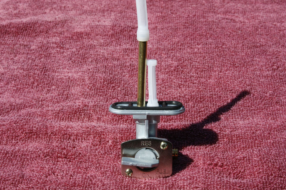

                              Of course you will also need the 8mm screw/bolt washer to secure the Octy. Click image for larger version  Name:	20210518_183408.jpg Views:	0 Size:	181.5 KB ID:	876664
                              Why do I suggest the Octy you might ask? If working correctly as the Yamaha engineers devised, it will serve as a shut off for the fuel. When working correctly when you start the bike the diaphragm opens and allows the fuel to flow. When you shut the bike off and lose vacuum the diaphragm closes shutting the fuel flow off. The standard model xs1100's have this same diaphragm built into the petcocks and functions in the same manner. From what you have thus far described you no longer have the octy and it has been bypassed. The long fuel hose from petcock to petcock serves that purpose. If you elect to put the bike back to original the diagram on fuel cock piping Yamaha Motorcycle 1981 OEM Parts Diagram for FUEL COCK-PIPING | Partzilla.com shows you exactly how to route your lines. You will need to also purchase two of these plastic joints Yamaha 3H3-24376-00-00 - JOINT PIPE | Partzilla.com along with the clamps etc. that I posted earlier.
                              One other tip, When you start on the brakes, do the rear master cylinder first. If you can get it working correctly you can use it to remove the pistons from your calipers. You will see a larger bolt on the side of the master cylinder and you can actually remove it and still operate the rear brake lever to pump brake fluid. The fluid will not just shoot out of the hole but allows you to keep adding more fluid as you need to. I use a cajun injector syringe to squirt more fluid in as needed. Those calipers can sometimes be pesky to remove. I have found this method helpful. The calipers have quite a ways to travel before they pop out. Here are a couple of listing from Ebay that could also help when doing the brakes. Brakecrafters Motorcycle Brake System Reverse Bleed Kit Non Pneumatic Bleeder | eBay, I prefer a mity vac or something similar but it looks like this could work. I also always use some of this grease when reassembling everything. It does not hurt rubber Brakecrafters Red Rubber Grease For Hydraulic Motorcycle Brake Systems Repair | eBay and it also keeps everything coated to eliminate moisture. Just get in the habit of replacing the brake fluid every couple of years because dot 4 brake fluid is hygroscopic (attracts/absorbs water).
