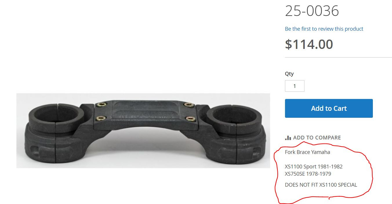

    I have a couple questions for you fine folks. I want to add a fork brace to my 1980 Standard. Will this one fit? The sales guy said they do not know if it will fit an 80 Standard.... https://www.fastfromthepast.com/25-0036

    Regarding the fork brace, I can see the fitment desciption does not have all it's marbles:
    Click image for larger version  Name:	Fork Brace.JPG Views:	0 Size:	91.8 KB ID:	876302
    Theer is no such thing as an XS11 "Sport", makes me think they mean "Special", but then they specifically say it doesn't fit an XS11 Special.
    There is no XS11 in 1982. It becme an XJ in 1982.
    They show XS750SE as 1978 and 1979. The SE is is a 1978 Special. The 1979 XS750 Special is the SF. The XS750 Special and the XS11 Special have the same fender and forks.....therefore the brace might be OK for the XS11 Special and not the Standard?
    Honestly, there are so many mistakes in the fitment description I am not sure what it will fit.

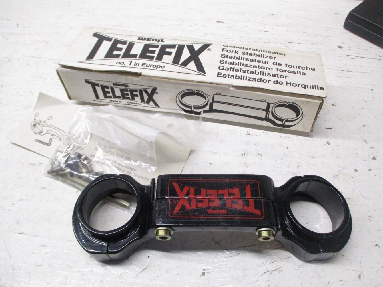

                This is an XS1100 Sport from Europe. Note how "Special" the front fork is. Mike's comment on the product ad is spot-on.
                Click image for larger version  Name:	667db491edb9822078d61ab1b53e088b.jpg Views:	0 Size:	172.4 KB ID:	876311

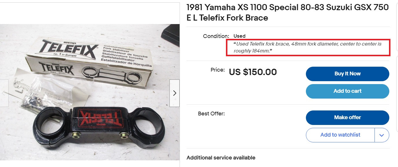

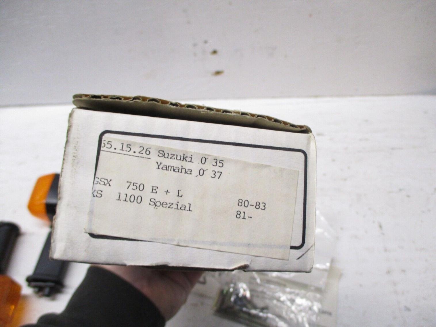

                  One on eBay for a Special. Includes measurements! I believe they meant 18.4 CM/184MM.
                  https://www.ebay.com/itm/23531077738...Bk9SR9yYnrOMYw
                  Click image for larger version  Name:	s-l1600 (4)[url]www.jpg[/url] Views:	0 Size:	147.0 KB ID:	876313 Click image for larger version  Name:	s-l1600 (4)88.jpg Views:	0 Size:	127.9 KB ID:	876314
                  Click image for larger version  Name:	Brace.jpg Views:	0 Size:	167.9 KB ID:	876315

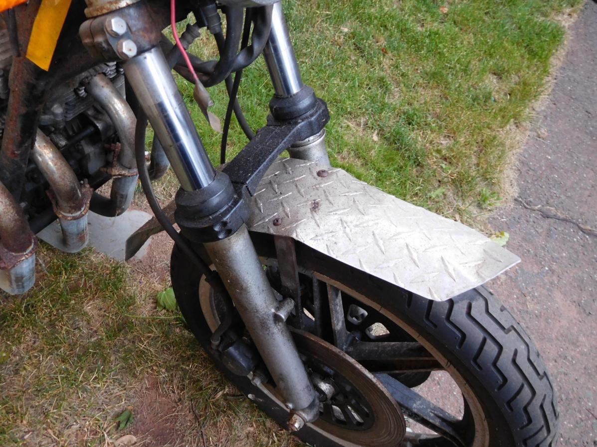

                    This is a fork brace on a 1980 XS11 Standard. Same brand but the XS11 Special unit shown before has a higher hump. The triple trees are different.

                      I measured about 18.6 centimeters on the standard Telefix fork brace.
                        I think the Special front end is what we refer to in the Harley world as "Narrow Glide". The Standard is the "Wide Glide". Can anyone confirm this with a triple tree from each bike? I measure about 140MM between the aluminum sliders for Standard.
                        Click image for larger version  Name:	image_4522.jpg Views:	0 Size:	163.7 KB ID:	876323
                          They should be both the same.
                          I measure about 148MM on the Special.
