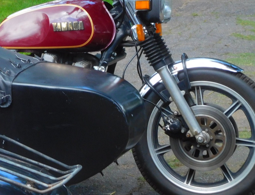

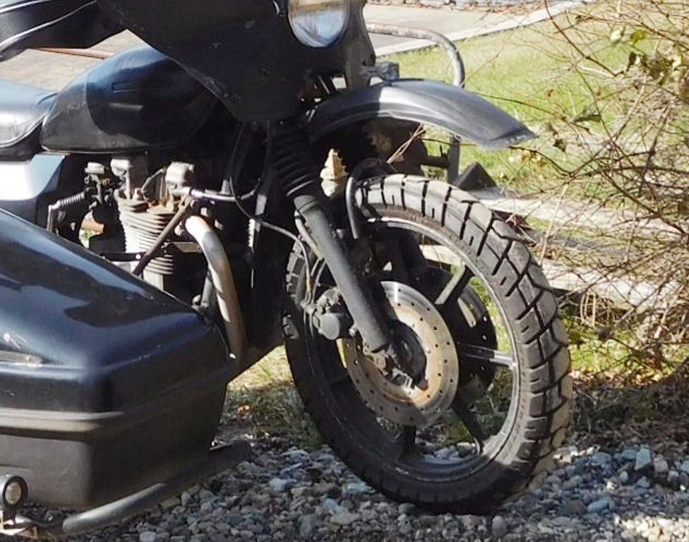

                  I like "The Road Warrior look" so I use these San Jose type fork braces. They work great. Very rigid. Much needed on sidecar bikes. I find them cheap at swap meets and eBay. These are popular with the Airhead BMW crowd.
ID:	875733 Click image for larger version
                        Are those made as application specific or are you looking for a particular length between the fork tubes? They look to bolt up at the fender mounts.
                          • 2011
                          They do bolt to the fender mounts and they are application specific. The XS1100 units are totally different from the KZ1000 units. The KZ750 twin units are also unique.
