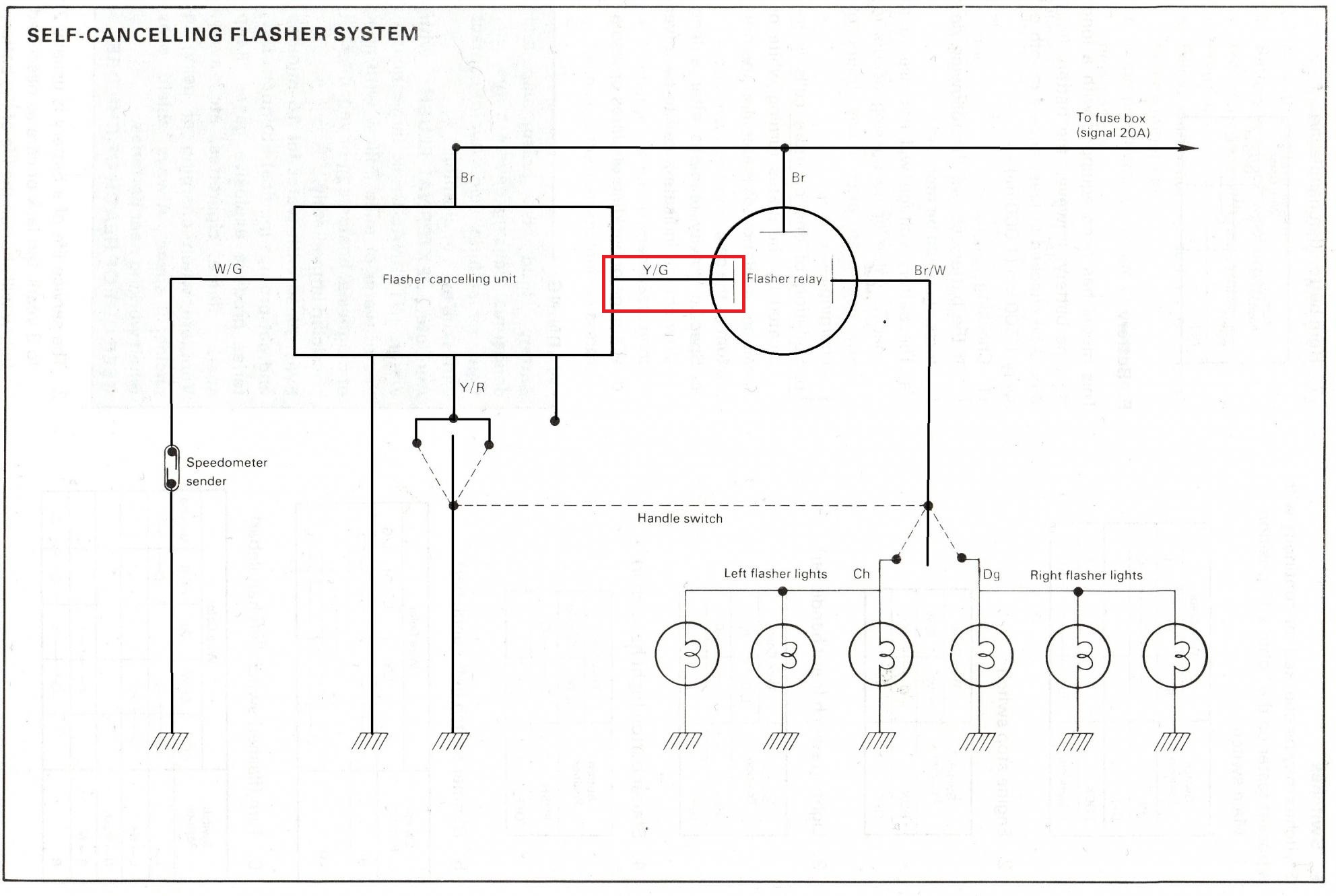

      The area in red shows the flasher cancel feature. Your circuit could be stuck in cancel mode. If you can disconnect just the yellow/green wire from the flasher and the flasher works, that is where your problem is.
        if i disconnect that wire it won't do anything.

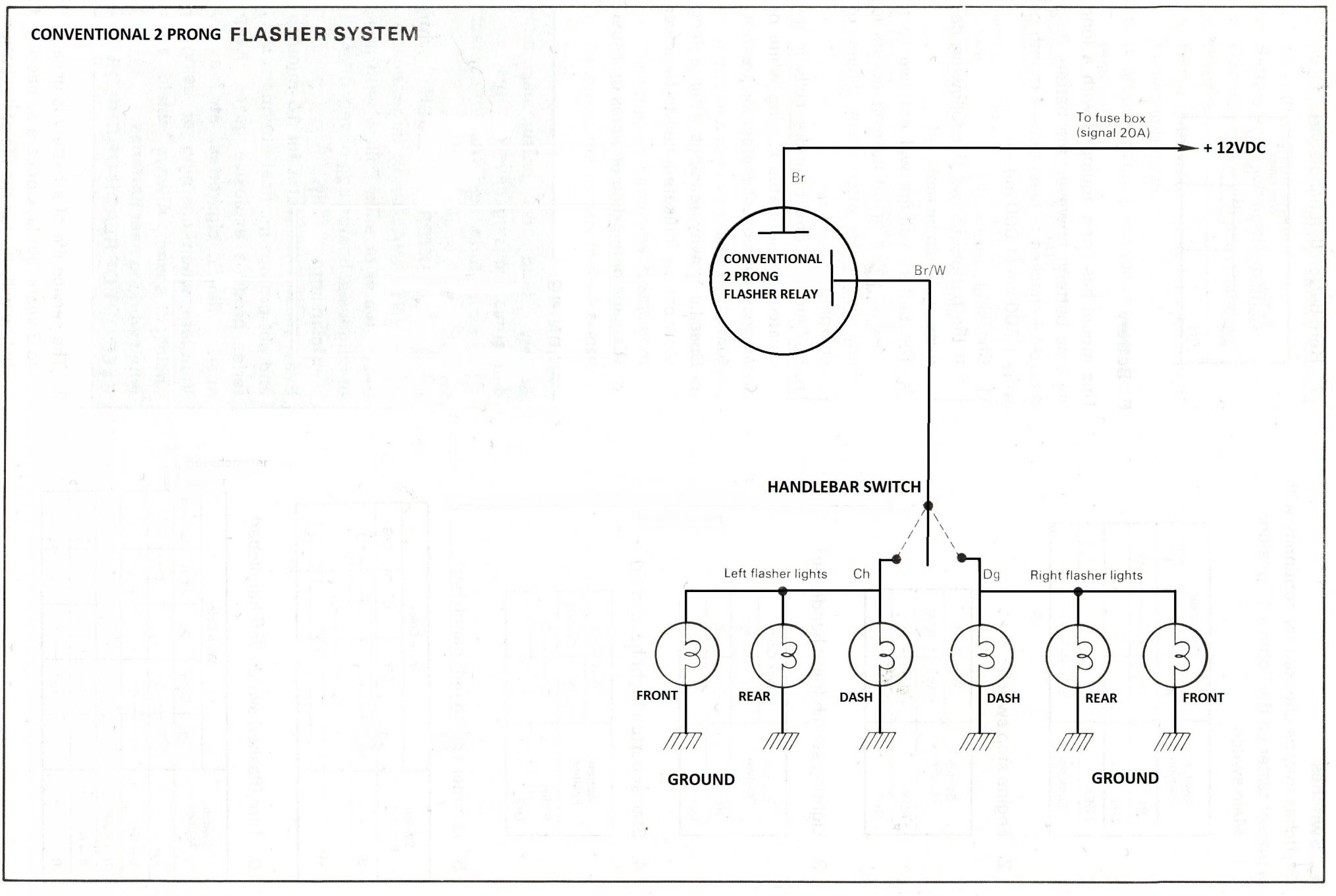

          Sounds like a bad flasher. I believe you hooked up the 2 pole flasher like this? And it flashed OK?
Name:	Standard Flasher XS11.jpg

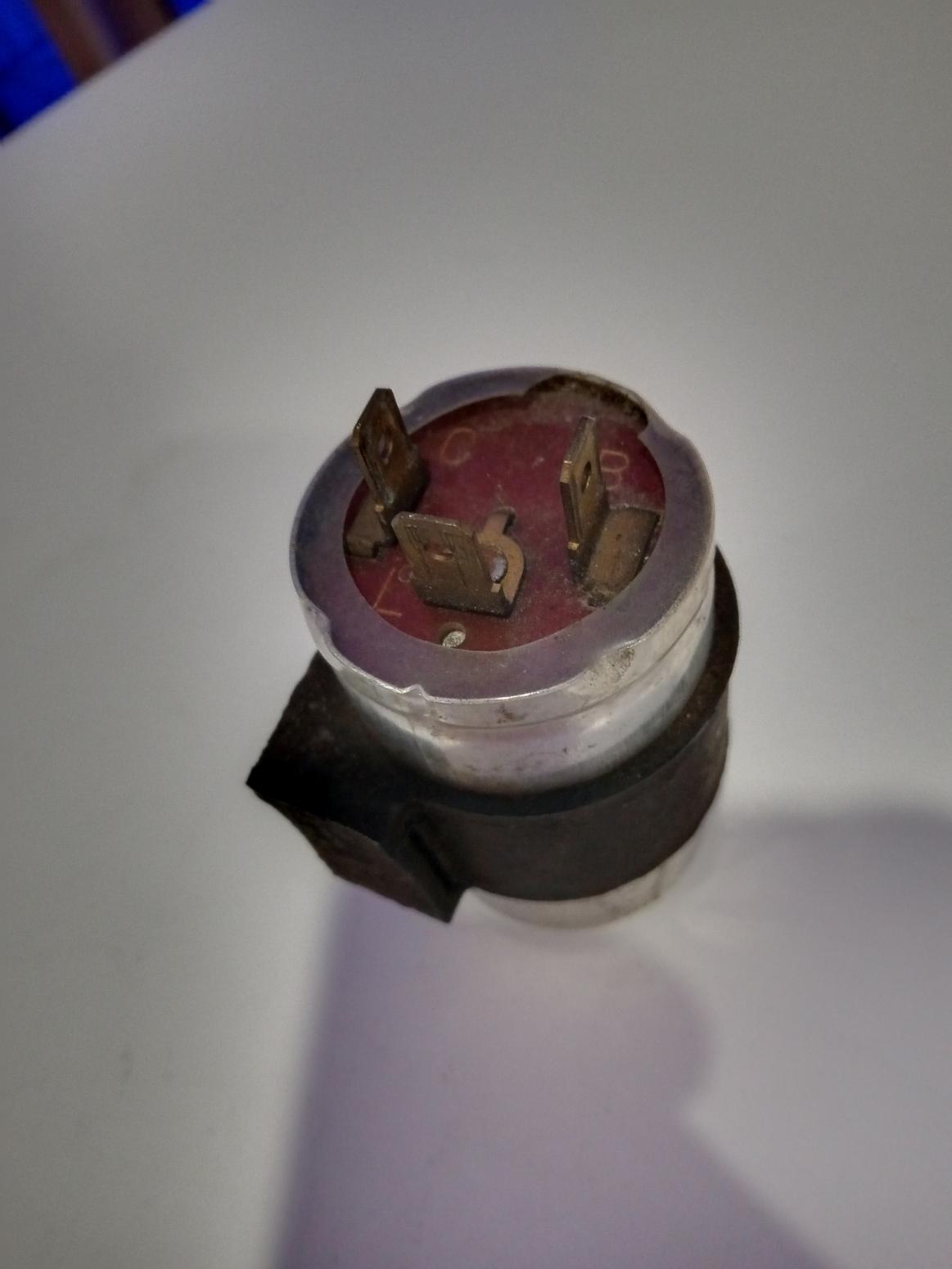

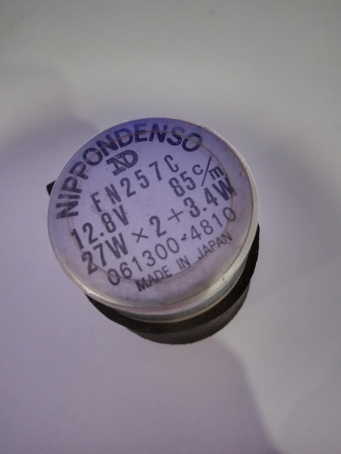

            Hey Roger, I have an extra one here. Send me a PM if interested.
