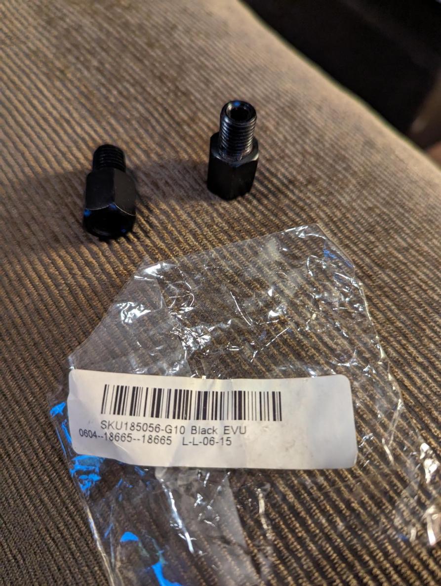

      Another option may be to use these righthand to lefthand thread convertors.

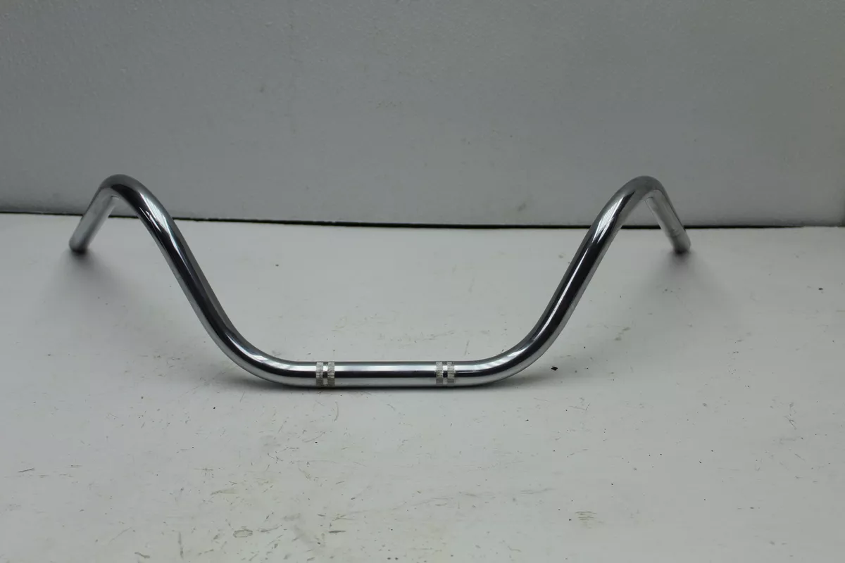

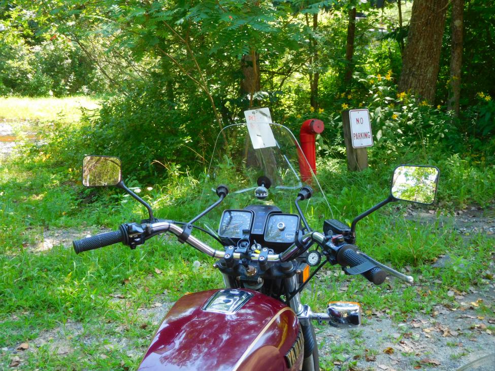

          XS1100 Special handlebars will fix it. It will get the mirrors right on out there.
            • 8049
            I’m sorry. I know that’s not helpful. Post a picture of your bike, so we can see what you’re working with.

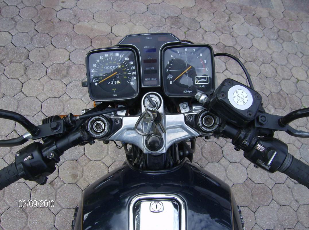

                On a more constructive note, I drill out the left hand mirror mount and Helicoil a 10mm right hand thread in it so it is conventional. Mirrors need to be convex so you can see around you.

                    Originally posted by skids
                    .Awe, tell the truth, you took a picture of your wheelbarrow's handlebars!
                    I certainly could have. I’m rocking those bars on my Special. My XS650 as well. My mirrors work fine without a view of my elbows.
