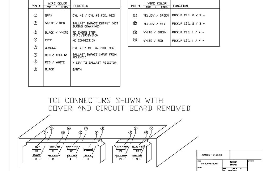

    I found this digging around the forum.

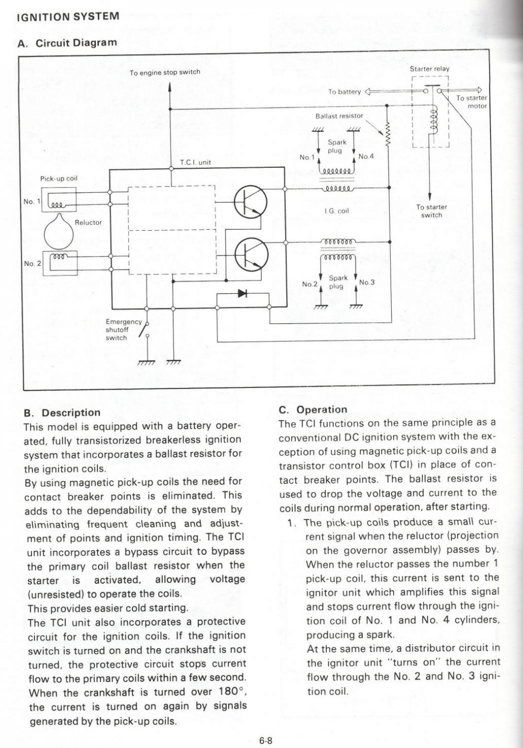

      • 2009
      From the manual.
        • 812
        Wouldn't it be nice if that's all a TCI is made of is two transistors and a diode?

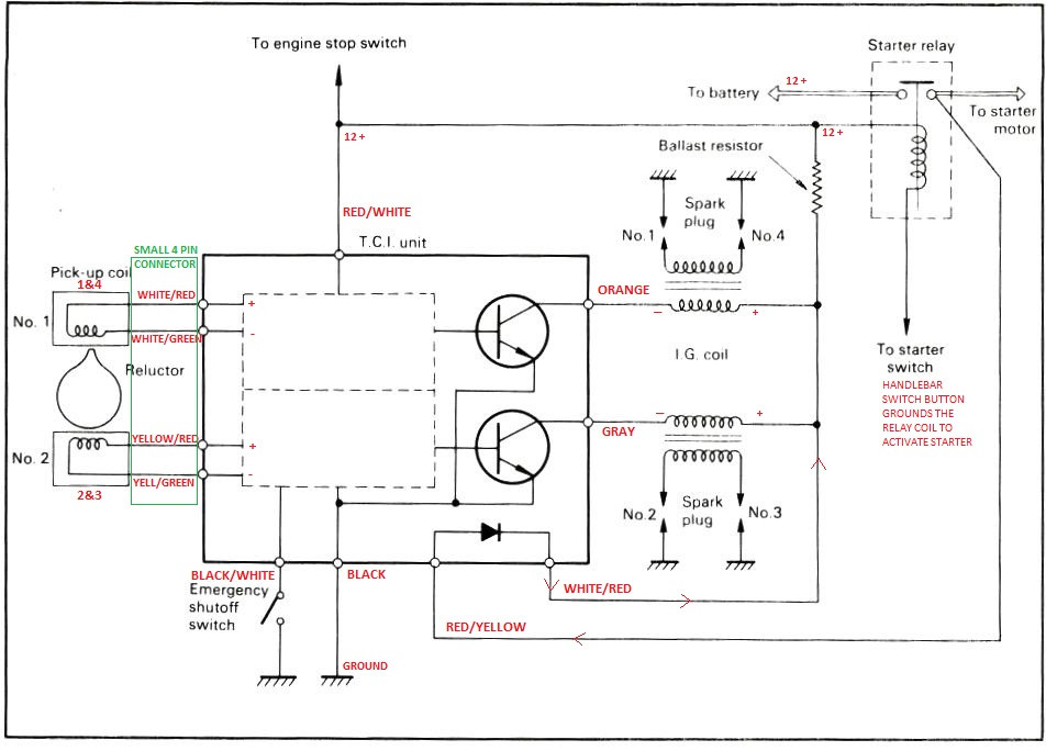

          • 2009
          LAB3. soon I'm going to disassemble a TCI to see what is exactly inside including parts and part numbers if possible. Here is a better schematic with wire colors and polarity explanations.
