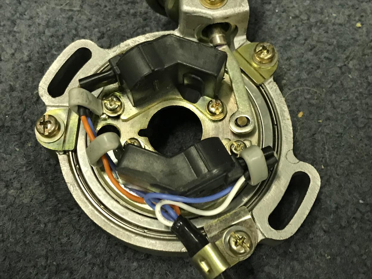

    Yes, you do need to put the pickup coil back in the same position. I cannot find the specs in my books, but I think it was about 0.014" clearance between the pickup coil and the tab on the crank. Check the clearance on the one still installed, and match it would be best for now.
      • 8930
      #47
      P/U coil gap is .7MM (.027")

ID:	874583 I used this wire- same gauge and colors.
            80 G
              • 2160
              #51
              Same here- I used solder/heat shrink, but I kept it at the end ends where it doesn't need to flex.
Name:	Wire for PIck-up Coils.JPG

                        The only thing that's ever made my bike backfire are breaks and possibly shorts in the pickup wires, once those where properly repaired there hasn't been a problem since. A quick look at them only points out the obvious, you really need to go over them with a fine toothed comb. The last break I found (before replacement) was a spot where the wire appeared thin, sure enough when I cut the wire in that spot the copper inside the insulation was like powder from flexing over the years.

                            Seems like my pickup coil fix failed... I painted the new crimps with liquid tape. I put the meter on them, infinite resistance. Pulled the cover, the two crimps had melted together... will perhaps try heat shrink, although it will be tough now with the crimps on. When I separated them, no issues on the meter.
                              • 7830
                              #59
                              Did you give the tape the proper time to dry? You can just put a bit of electrical tape around them, Loop around one, then finish by looping the second wire.
