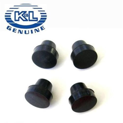

          Some versions of these carbs have a rubber plug that goes in the pilot jet tower. I notice your carbs don't have the rubber plugs.
          Do you know if there is a passage between the main jet tower and the pilot jet? If there is no passage , then you are OK. If there is a passage, you need the rubber plugs.
          I think the pilot jet is the same size in both cases, so it doesn't seem like this issue would be related to your poor idle.

            In my 1980 standard carb rack the was one pilot screw that was broken in the #3 carb. I put in a used #3 carb body but found it was from a Special and had the hole that needs the rubber plug. So three of my carbs have no plug and one does. Bike runs like fuel injection. Here is what the plugs look like.
            https://www.ebay.com/itm/29349348355...temCondition=3

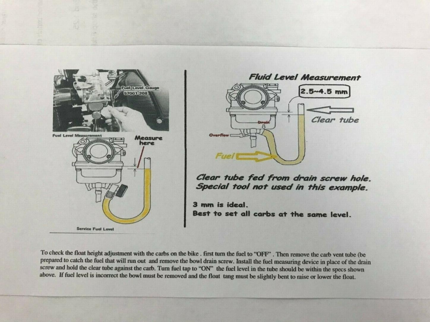

              Your first picture of the float height shows me you are NOT measuring it correctly. The measurement needs to be from the lip, not the lower flat between the two lips. This will give you a high float and rich mixture. My guess is you are about 1.5mm off.
              This thread shows exactly how to set the height - https://xs11.club/forum/idle-talk-fo...s1100-sg/page2

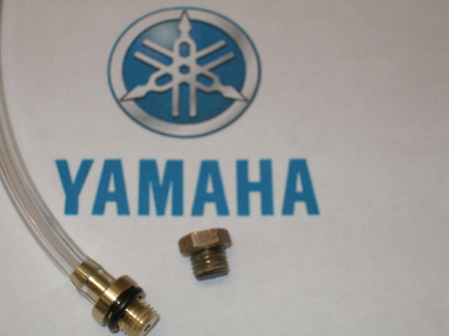

                Here is a valuable tool for this:
                https://www.ebay.com/itm/274881260720
ID:	874528 Click image for larger version

                  I have those rubber passage plugs. If one wears out and falls in the bowl, the bike won't run right.
                  80 G
                    • 8908
                    The bowl should have a post on it to prevent the passage plug from falling out.
                    Now if it rots away from ethanol, that's another story.

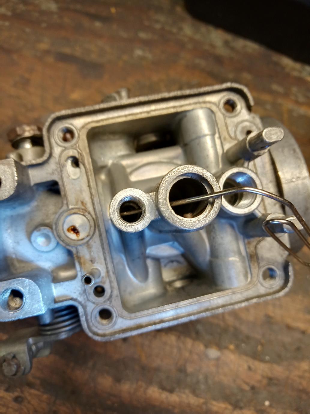

                      I am confused... What lip? I see a very very small rise on the rim there... almost imperceptible with the micrometer. Every post I have seen using calipers or a guage shows measuring of the metal gasket surface. Here are some photos... as for the plug, I don't see a passage between the jet passages? Not entirely sure where that would be.
                        • 8908
                        Passageway

                          Passageway
                          Ok, no passageway on these carbs.
