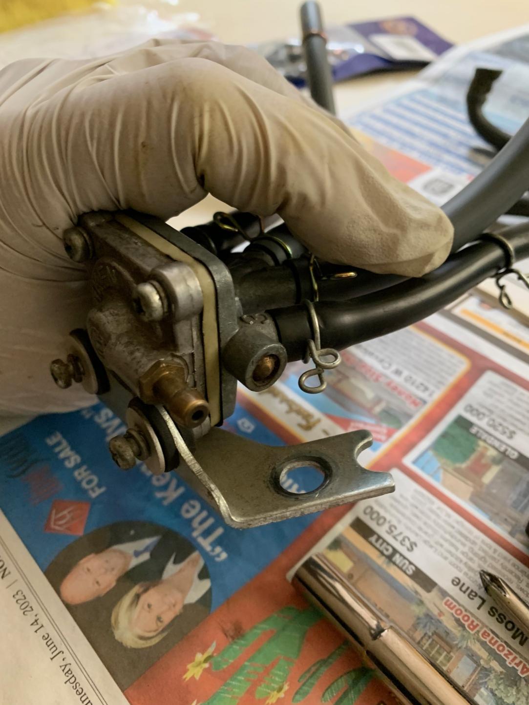

      OK...I lied. Twiddling my thumbs here while I wait to leave and said, "I'll take the tank with me to the shop out of state and do the petcocks there". Then I had the tank off, took a look at it and said, hell....let's just do it all now. Cut new fuel lines and swapped old rubber gaskets. The left side O-ring came apart when I took out the petcock-that explains why it was SO HARD to turn.
      Done. Much cleaner looking now, too. Click image for larger version
Name:	No hole.jpeg

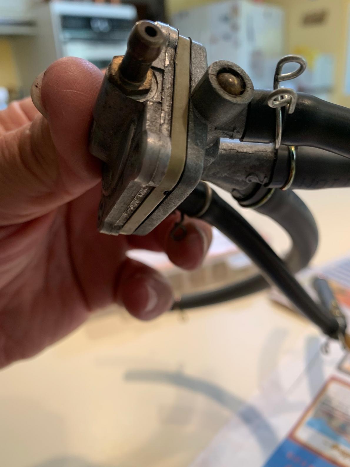

      Only question is on the "spider" ( as George called it ) that all the lines run off....which direction is the little "vent groove" that is sandwiched between the rubber diaphragms supposed to be? I only took one pic of it before I took it apart and it doesn't show it. I put it back together the first time and it was on the left side which it's clearly not in my pic. SO... I switched it to the bottom.
      Anybody know? Click image for larger version
Name:	Hole to bottom.jpeg
ID:	874274 This pic shows the location of where I decided ( 50/50 chance I was right ...or wrong. THough once I thought I was wrong. But I was mistaken. )
      THanks guys!

        Don't know for sure JonnyO, but one may figure that slot would be adjacent to the bleed hole in the diaphragm and/or the vacuum hole in the end cap. I haven't taken one of those apart in 15+ years. Not too many people still running those, Marty probably is, maybe he'll chime in.
          • 2160
          It might not matter which direction the vent groove faces. When you have it apart just make sure there a clear path for atmospheric pressure to equalize.
          All other being equal, less water intrusion if it faces downward?
            • 8930
            After watching a video of a similar valve being rebuilt (XJ vacuum petcock), the vent groove is on the same side as the vacuum port.
              Hmm. So flip mine around then. Will do it when I get back in a week or two. Thanks!
                • 8930
                Yep, hopefully the fella in the video assembled it correctly...

                  Well... I have mine like that...except it's at the bottom and not the top. Think I'll leave it as is. Thanks for the pic!
