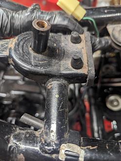

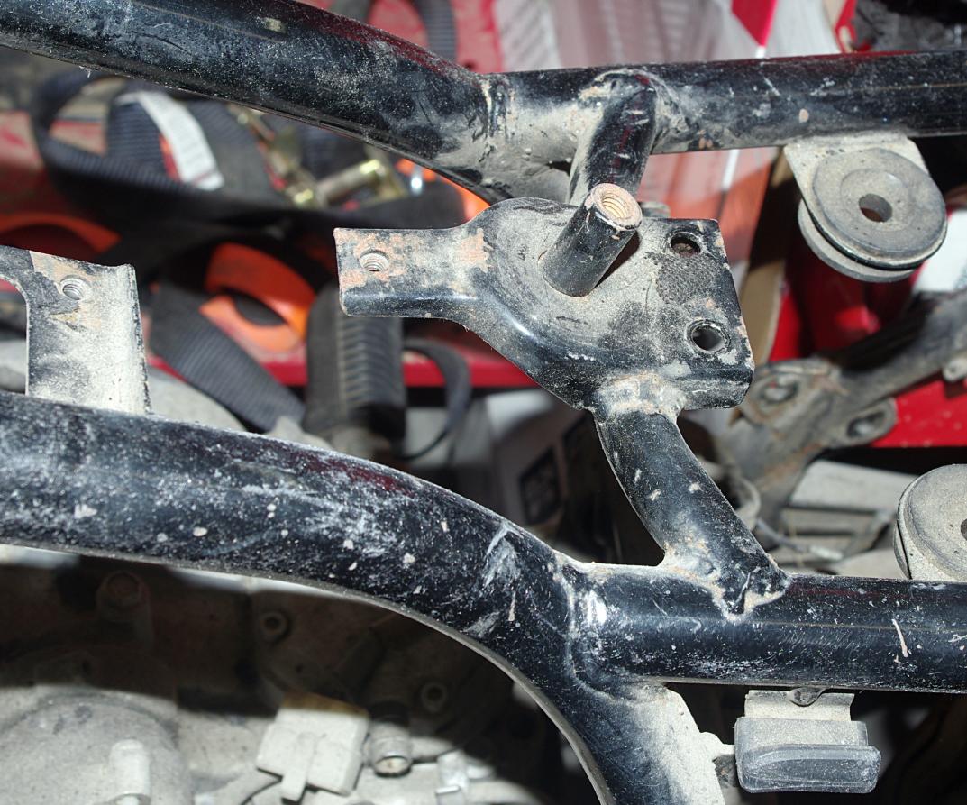

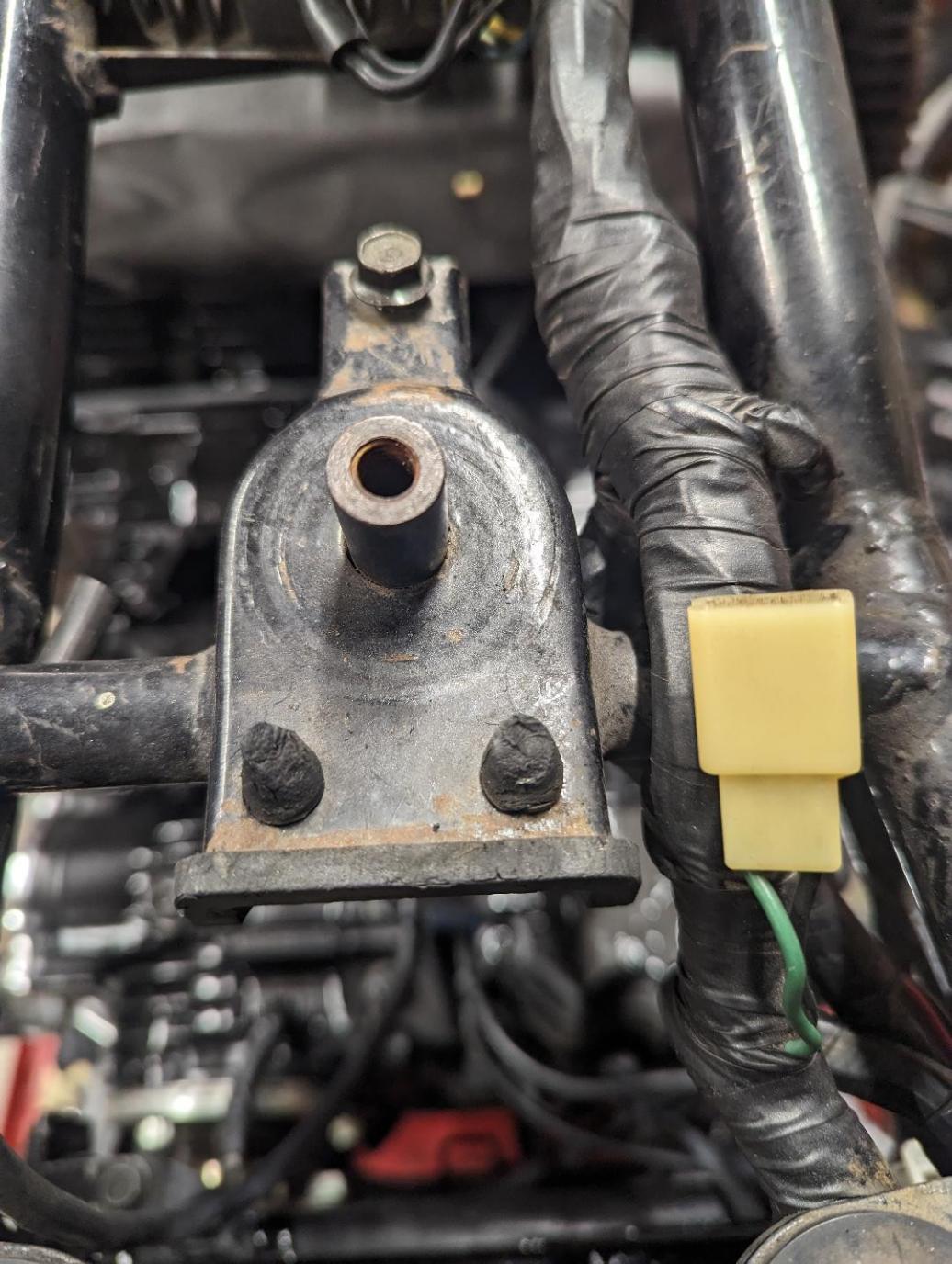

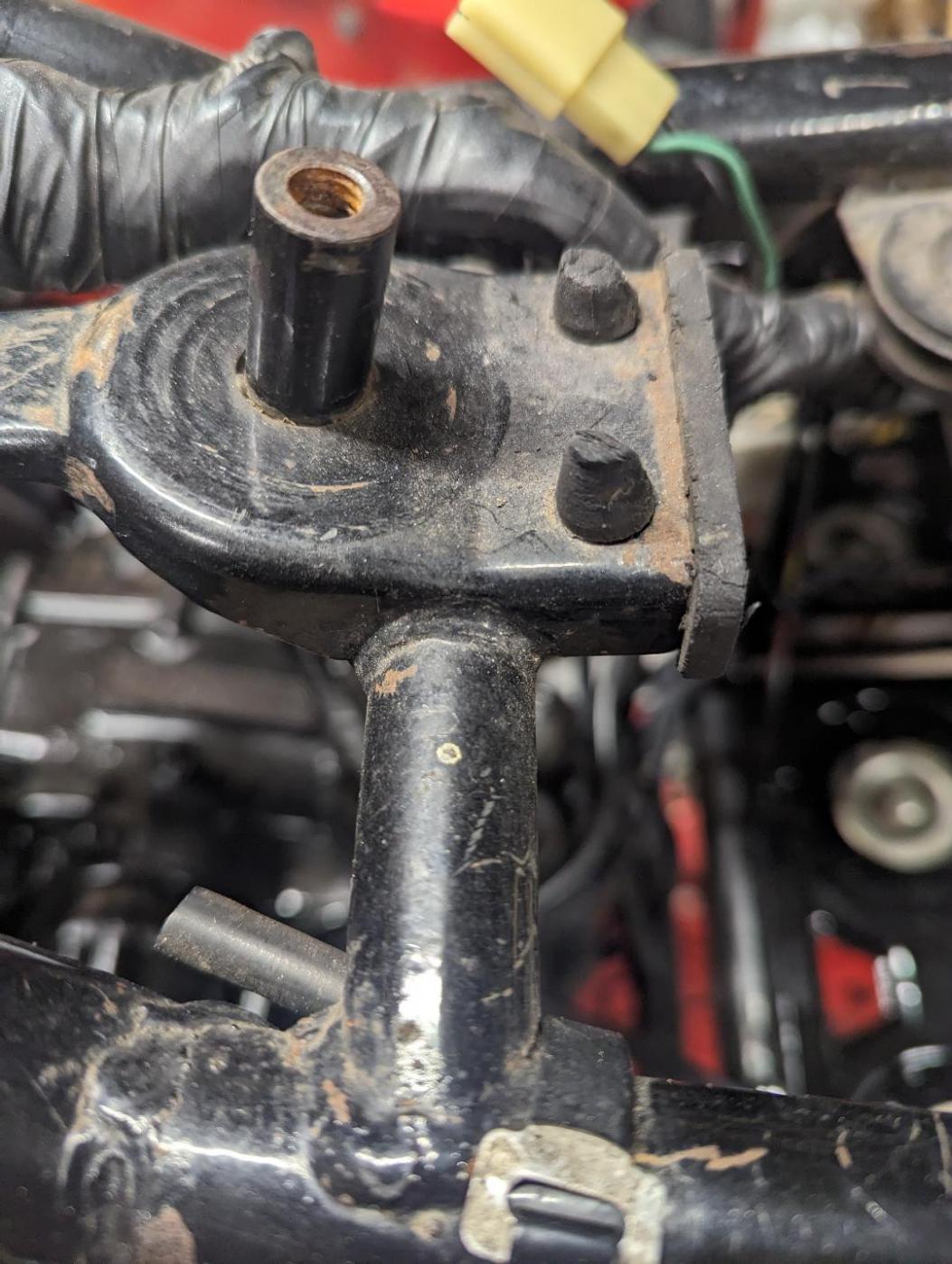

    Can someone take a picture of how the fuel tank is mounted by the seat? I have an 80 SG that I believe the piece was tack welded and broke off. I basically have a bolt that goes through the rubber grommet and a thick spacer and it kind of rests there. Since I work in a steel factory and am certified flat position MIG welder, I can weld this. I might still have the piece to weld.I just have to know what it looks like.
    Here's a picture of the 79sf mount if that helps.

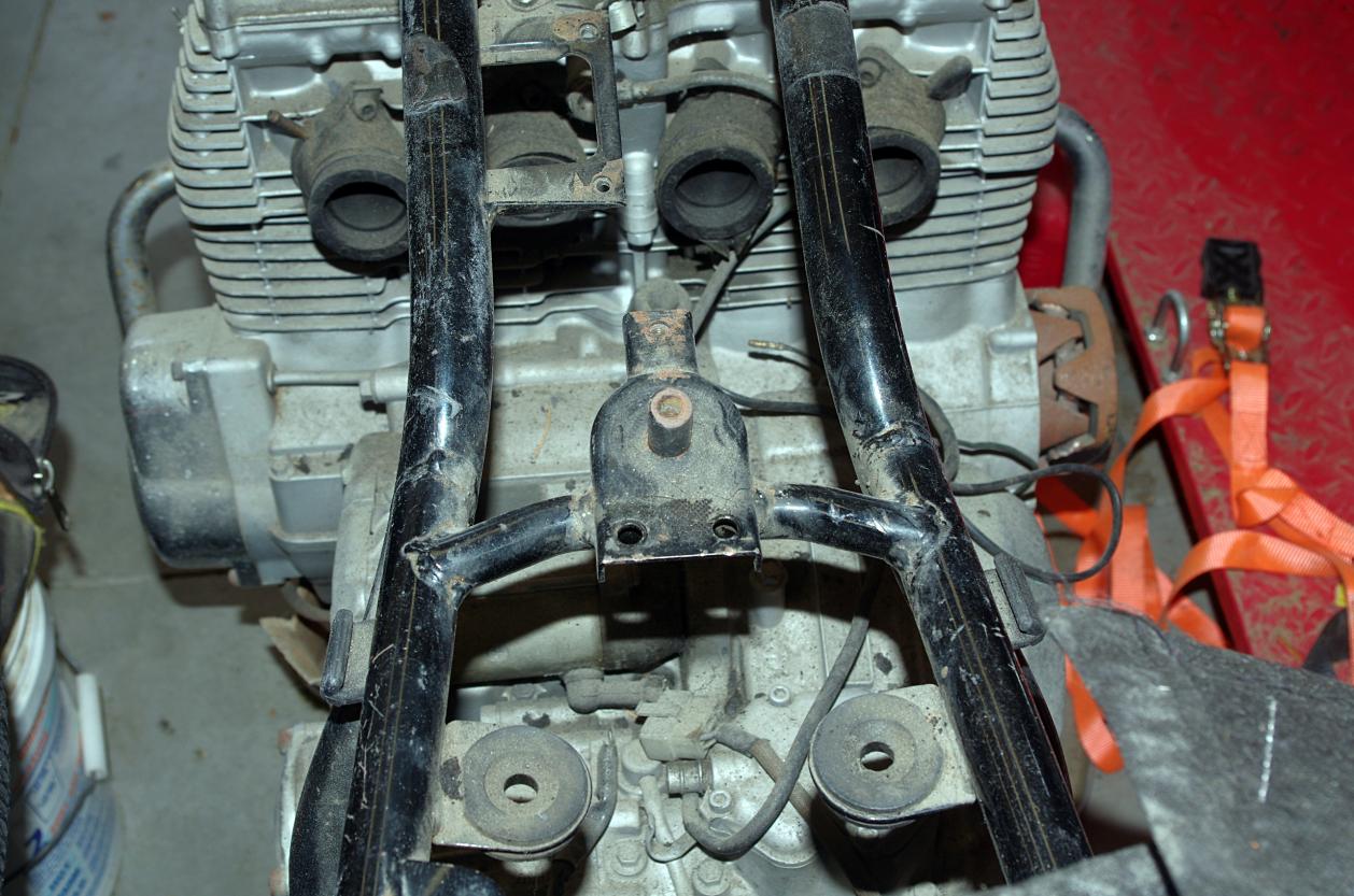

        Here are two from a '78 Standard. Mounts are the same, as tanks will interchange. Click image for larger version

          My SG mounting stud looks just like the above pictures. Do you need a picture of the tank portion/rubber grommet ?

            I think this part being tack welded came off. I just have to look for it.
              • 2117
              I found the part, it was on the grommet itself as I have a threaded bolt that goes through it. There is no tack weld whatsoever holding it on. I looked at it very closely. What holds it on?

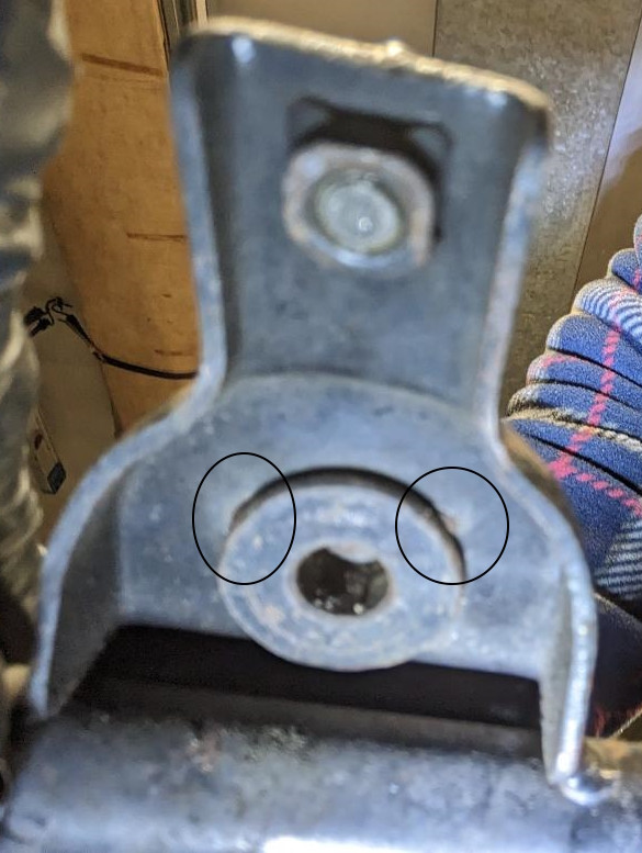

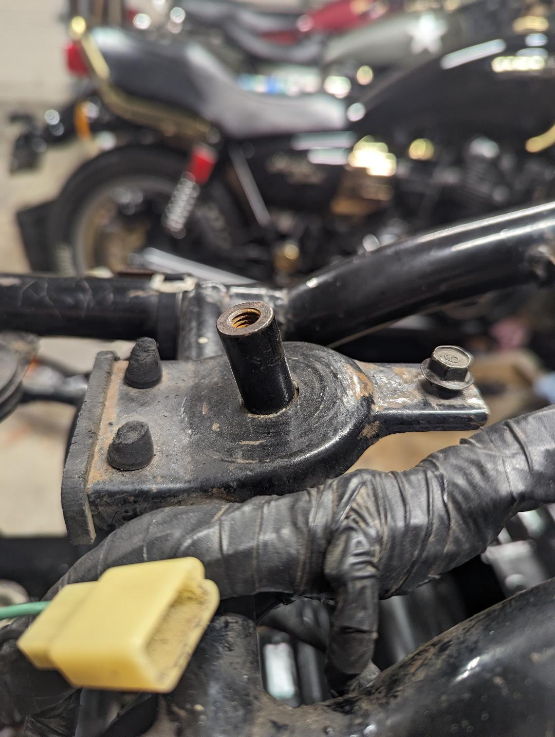

                I assume you are talking about the threaded post that goes up through the flat bracket piece that is welded to the frame? If so, it's hard to see up underneath there, or to get a good clear picture. But here it is for what it's worth. I circled two spots that looks like the underside of the post is tack welded at 10:00 and 2:00 o'clock and probably one or two more spots that doesn't show in the picture. Hope this helps.

                  • 2117
                  Ranger-yes thanks for that pic. I have the threaded post and its very lightly tack welded froim the factory on mine. I can tack it with the MIG gun after I clean up the area, but would tack it on top as underneath not too much room and working against gravity. I need a spacer so my Pingel petcocks don't hit anything. Been pouring here in NJ and just waiting on that one nice day to ride. Thanks for the pics everyone!

                    I'm now thinking that the threaded post maybe can get by without taking it in place. The bolt that goes through the grommet will keep that threaded post from falling out-correct? I will need to buy a new bolt as the one i used has seen better days.
                      You could probably save yourself some grief by doing it "quick and dirty" by tacking in place on top then cutting away a small chunk of the grommet to clear the weld.
                        Correct, it will not fall out if you can tighten the bolt. But it seems like the post will turn with the bolt every time you try to install or remove the tank. The acronym PIA comes to mind.

                          True Ranger. I will find a way to mount this-I can bring it to work to do but dont want to take off the tank. I have an idea and will see tomorrow.
