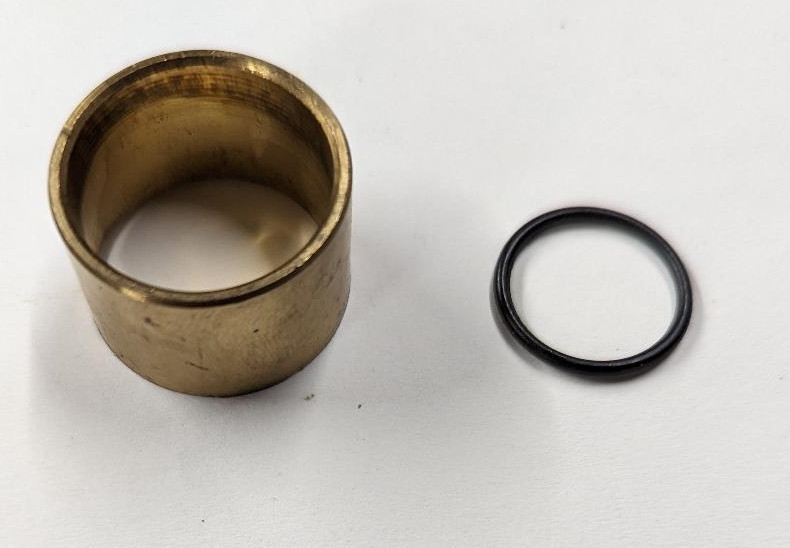

      Thanks Ray, The spacer is still on the shaft and I also have an extra spacer and o-ring that the previous owner gave me to use for a future swap. But I don't know what the o-ring is for or where it goes.

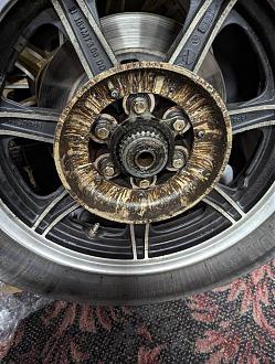

      The problem I am having with the final drive is oil/grease being slung all over the rear wheel. So I'm guessing the drive is leaking at the seal. Since I have another xs750 drive, I want to just swap it in, rather than mess with the old one.
      Could he have made an error when modifying the xs750 drive that would cause an oil leak like I have?

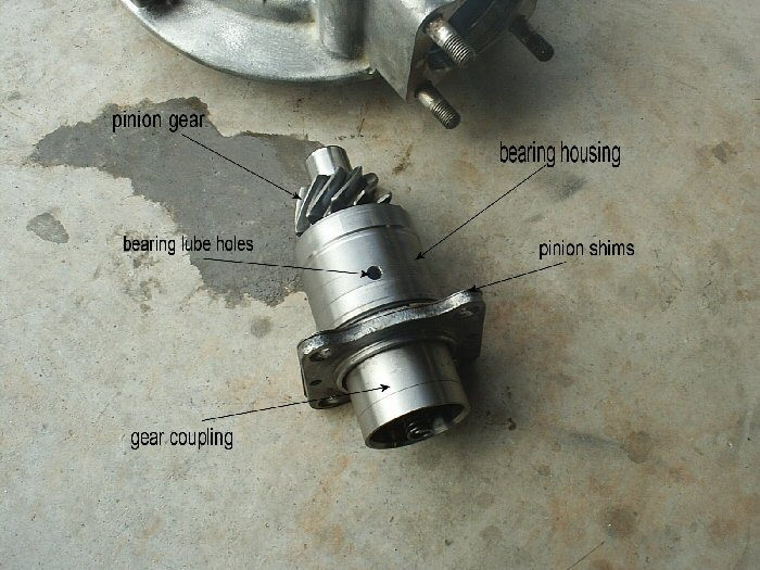

      In the final drive swap mod instructions, which I believe are incomplete, they show the coupling gear, housing, and pinion removed but it's not clear why they removed it and what needs to be done with it.

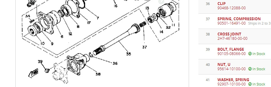

      The drive shaft clip #36 is missing. Would that have been removed for the swap mod?

          Yes, the clip is removed and the "O" ring is used instead of it.
          There is NO reason to disassemble the final drive. I never did on my swap. If I remember, you do need to pull the nut on the input shaft side to place a large washer with sealer for the two oil holes in the 750/850 final drive.
          Oil leak is the seal! I've had seals go out on different final drives, not just the 750. It was an easy fix to just put in a new seal as you are working on it.

                    A hacksaw is all you should need. A vise would be helpful. Copper pipe fitting, cut it to 5/8". Easy enough. Wrap masking tape around the pipe evenly at 5/8" to ensure a straight cut.
