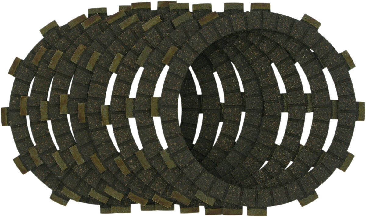

        I have had good results with Vesrah. EBC is also a good product. These are considered stock type replacements. It's tough to find OEM new although a set of used plates would work fine if you knew the history. Someone here in the club may have a good set available. I just did a 2020 CRF250L clutch (common weak area) with EBC clutch pads and the customer is real hard on his bike. He said he liked them. Like everybody said previously, soak them in engine oil prior to assembly.
        https://www.ebay.com/itm/19568973313...Bk9SR96J9cinYg
