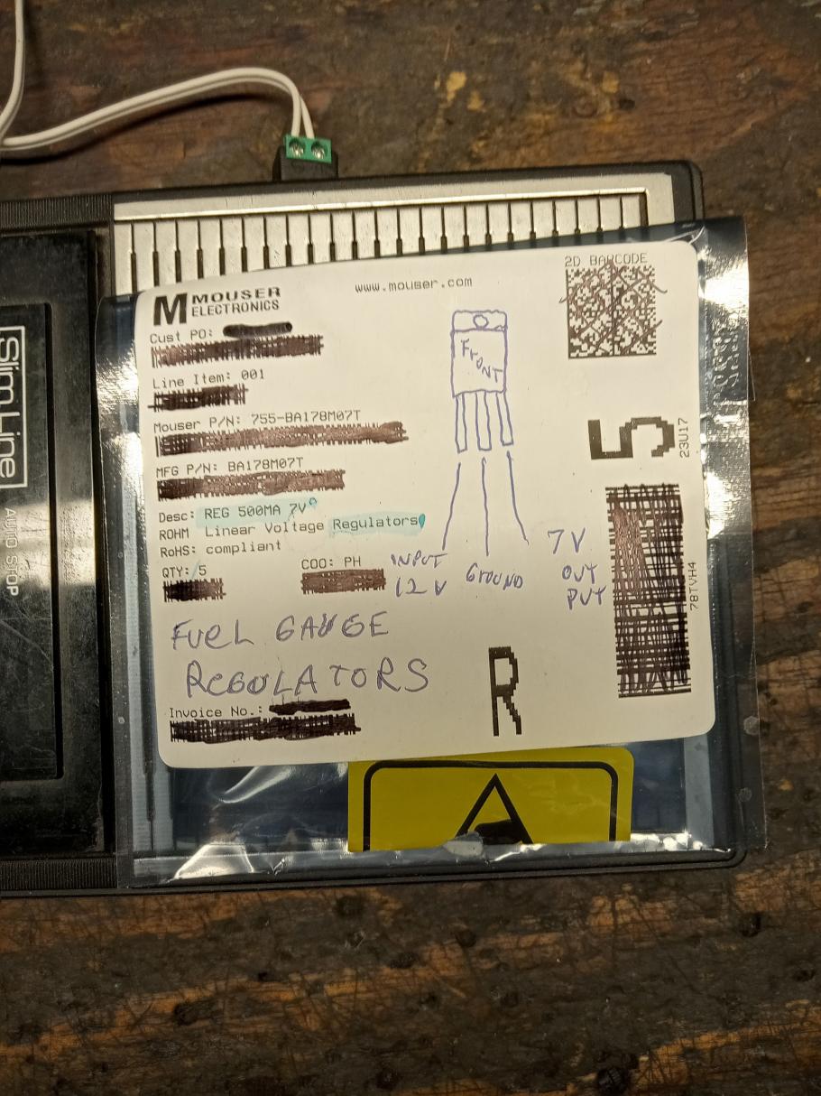

    Hi Phil, what voltage is that regulator? Do you have a part number for the IC?
      • 8893
      It is 7 volts...
      https://www.mouser.com/ProductDetail...1eF6wy4w%3D%3D

        • 2011
        Thanks Phil. It's great when you can spend $2.00 to avoid a $50.00 part. My problem was the sender and luckily I had a spare. However, when out on a ride I noticed my speedometer was showing incorrect speed and it ended with the unit getting stuck at about 50MPH. It has since returned to 0. I guess I will try the WD40 trick and try not to flood the interior of the meter.

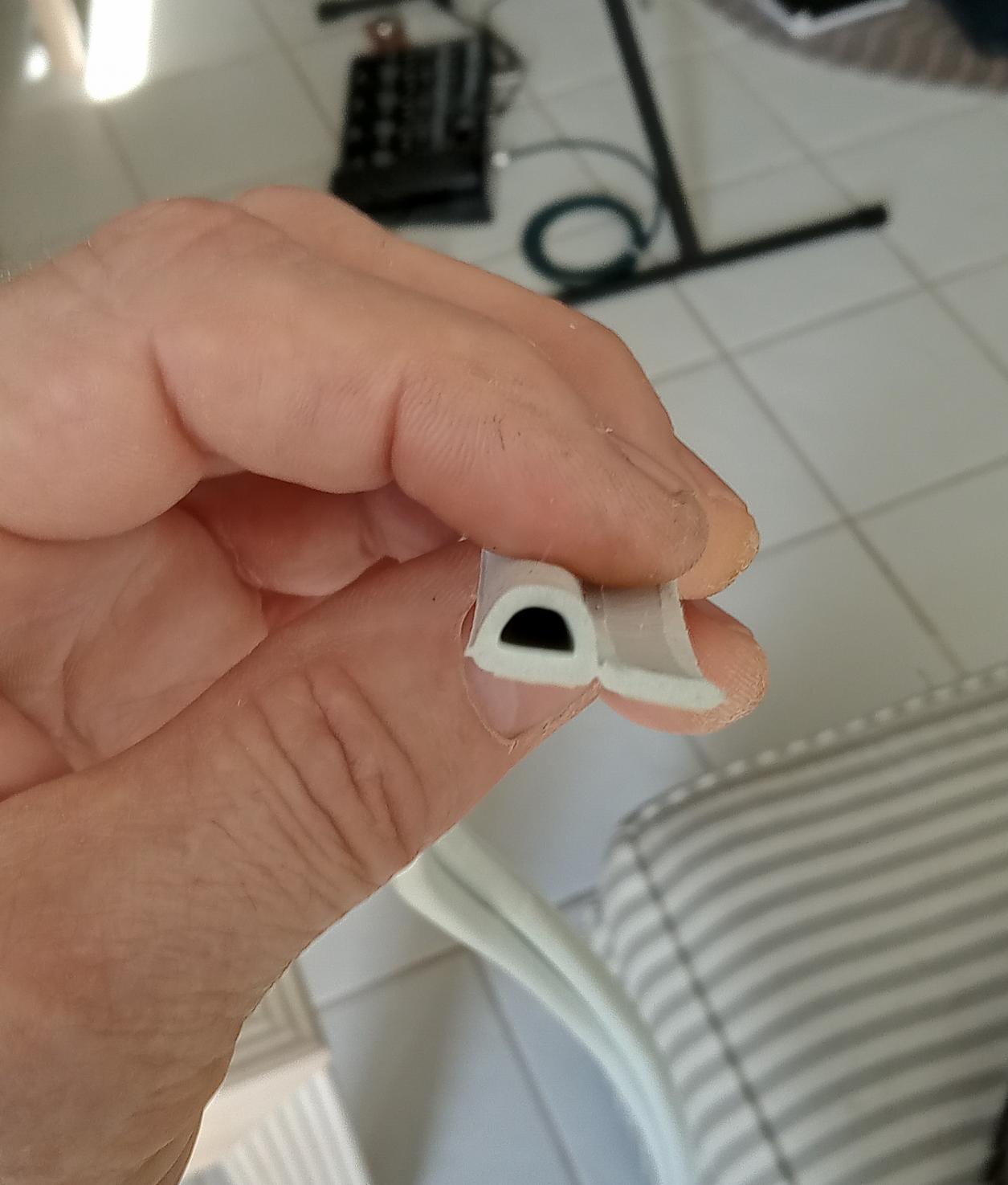

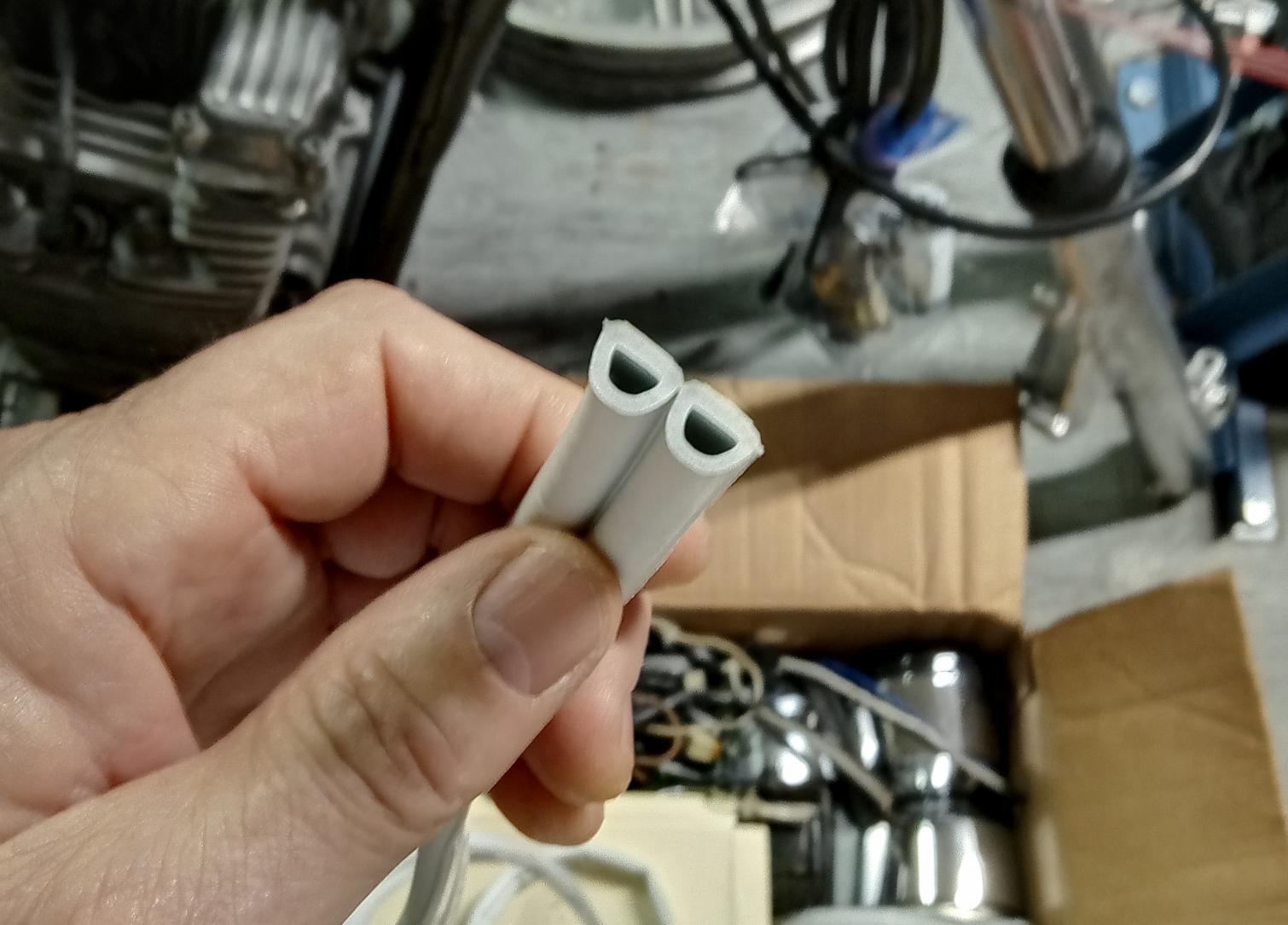

          • 2011
          Worked on the speedometer last night. Made the mistake of removing it from the cluster bracket and in the process ruined the rubber damper gasket because it was so old and brittle. It was only then that I looked around on-line and found that part is not available anywhere. Is there any alternative to the square shaped rubber damper (2H7-83513-01-00)for a standard XS11? Has anyone run into this problem when changing and instrument bulb?
            • 8893
            You can make one from rubber window gasket from Home Depot. It needs to be trimmed down with manicure scissors and it is white, so will need to be painted after installing.
