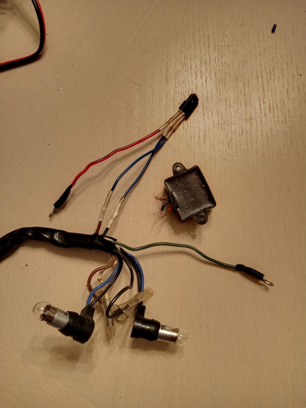

                      Also had a dead fuel gauge on my 80G and after all the test procedures (as per bikerphil's post) narrowed it down to the regulator (2H7-85755-00-00). Seen some posts regarding making one of these based on what it's supposed to do, but I'm no electronics wiz and didn't want to risk my tach bursting into flames in front of me while driving down the highway. It's a part no longer that easy to find but my fuel gauge works like new . (PS - that's a cooked one in the picture -
                      bought a used, untested unit the first time and got my money back)

                        Yep Len, the regulator is usually the culprit. I have 6 or 7 bad ones here, some read 10 volts, the others zero.
                        Shocker, if the regulator is your problem, I can make you one for about $2. With inflation it may be closer to 3.

                              Here's a pic of the tach harness with the new regulator installed. It's not plug and play, it needs to be soldered in.
                              The new regulator is the small one on top, the old one cut off and directly below.
                              Click image for larger version  Name:	IMG_20221001_221149.jpg Views:	0 Size:	131.3 KB ID:	870658​​​​​
