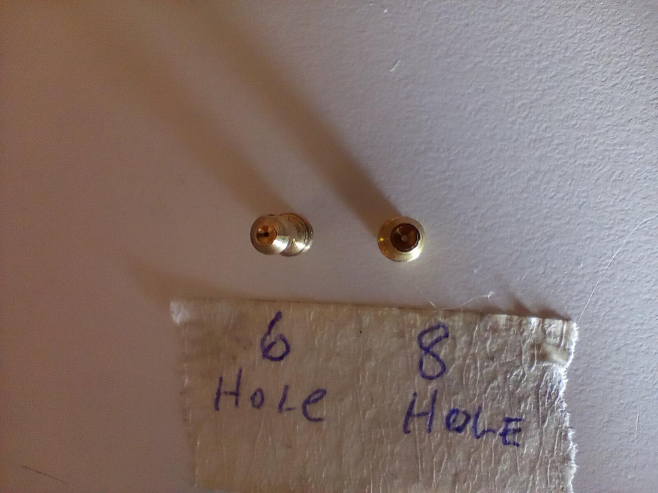

      Stock pilot jets should have 6 holes in the shaft like this. With a tiny hole in the end.
      https://www.mikesxs.net/200-3500-to-...ries-jets.html
      Not 8 holes like this.
      https://www.mikesxs.net/pilot-jet-vm...125-ebc-2.html
      I have no idea what a dynojet should have.

                  I think that TC solved the pilot jet bleed hole mystery back when he was sawing carb bodies in half with his band saw...good info for anyone who has never seen it, good refresher for those who have.
                  Billy
                    The nozzle end of the 6 hole pilot jet (BS type) and the 8 hole (VM type) are different and so is the jet hole size...
