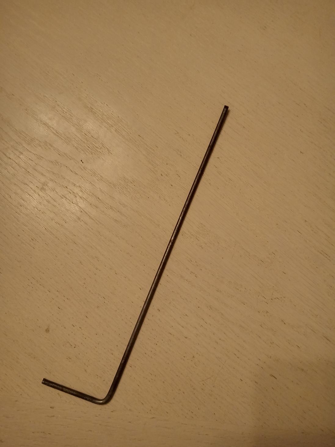

    Or make your own... Click image for larger version
