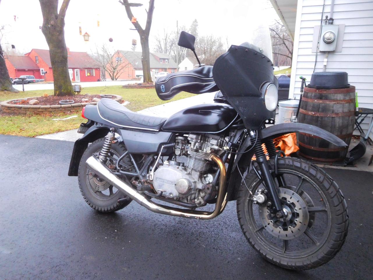

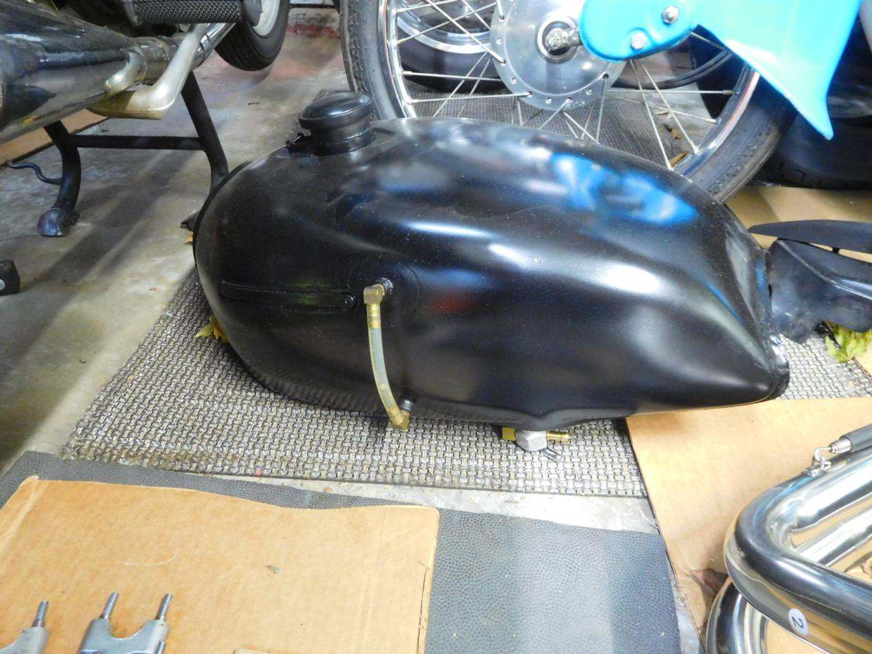

    I used the JB Tank Weld on my KZ750B snow bike fuel tank. It had some pin holes where the seat meets the tank from the road salt. Patched it and sanded smooth, primed and painted. It's been holding for several years now. I have also used POR Patch with good results on various projects.

      Four years later, the fix is still good. No leak.
      Thanks for posting and for the update---4 years later.
      Followed your lead w. the JB, anticipating similar results.
