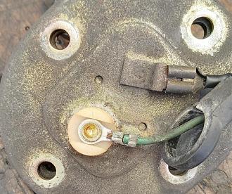

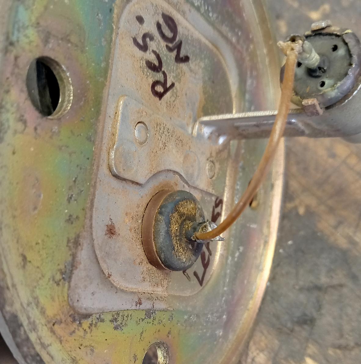

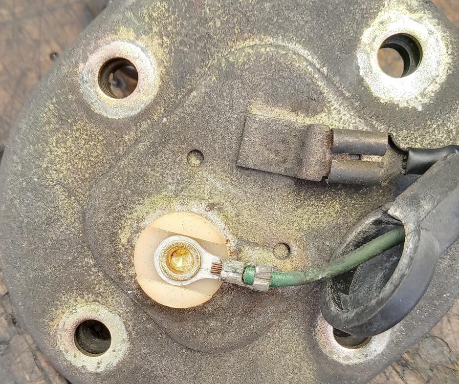

        It can leak where the wire goes thru to the thermistor, there is a fiber washer there. I had this happen but just replaced the whole unit with a donor from an extra tank.
          That's what I'm afraid of. Based upon eBay asking prices, I won't replace it. I'll fix it or replace with a blank plate.
            Yep, there is a rivet holding this wire terminal together. It may be repairable. A few pics... Click image for larger version

              Now that the tank is empty, I can see the leak path is through the sender. So, I'm going to have to come up with a fix.
                I'm going to think about a way to repair this too. Maybe drill out and use either a bolt or a large pop rivet with a new nylon washer, which should hold up to gas.
                  Maybe smear some fuel tank sealer over the inside of the sending unit. Sealed from the inside, and no more leaks.

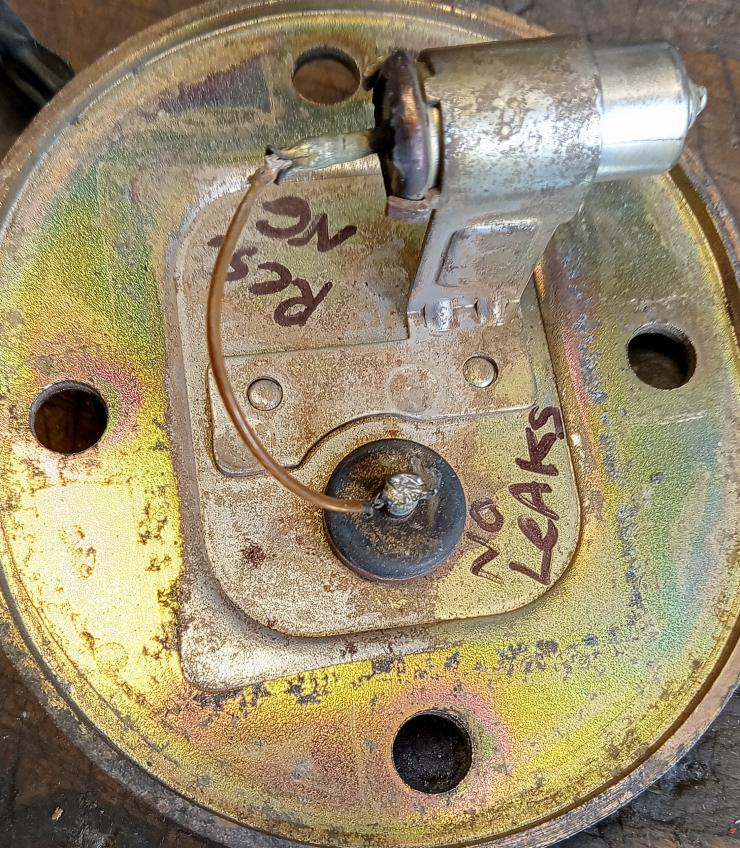

                        • 1262
                        Marty,
                        I'll take a look this weekend. I may have one I would send on over to you.
                        I'll check this weekend.
                        KURT

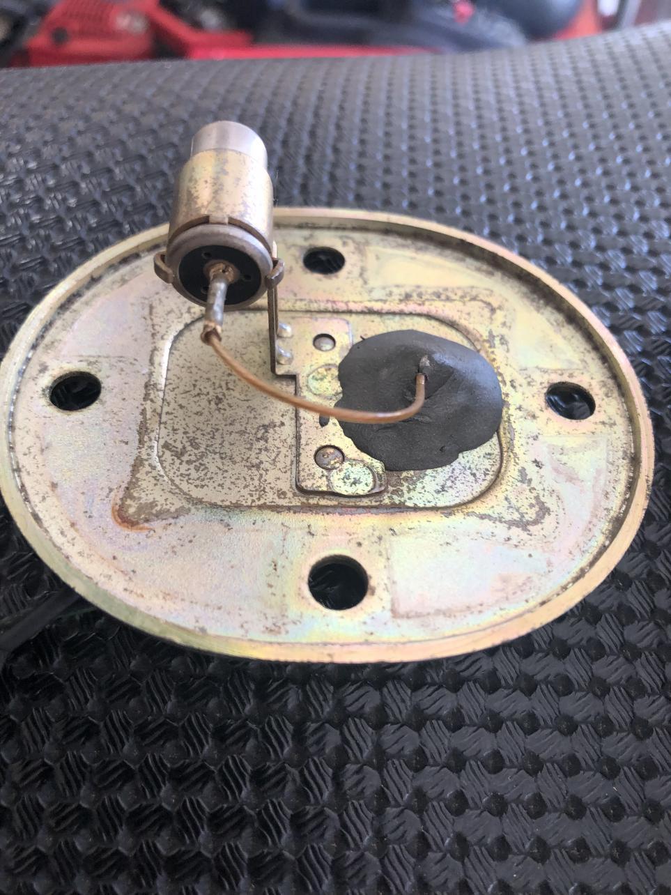

                          I bought this stuff to fix it. $6 If it does what it says it's supposed to I may not ever have to futz with it again. I just received a tracking number for the gasket. Maybe I'll have it fixed middle of next week. I'll update.
                            I've been fooling around with this repair but with one accidental spark from a short and, well you know the rest. That fuel light isn't that crucial. I remember now a while back when mine started leaking, I made a block off plate from an electrical box cover and ran with that. A year later, I ran into a replacement. I don't think it's worth the risk rebuilding.
                              I used the JB Tank Seal. There’s nothing left but the leak test. The bike is still on the lift with the wheels off.
