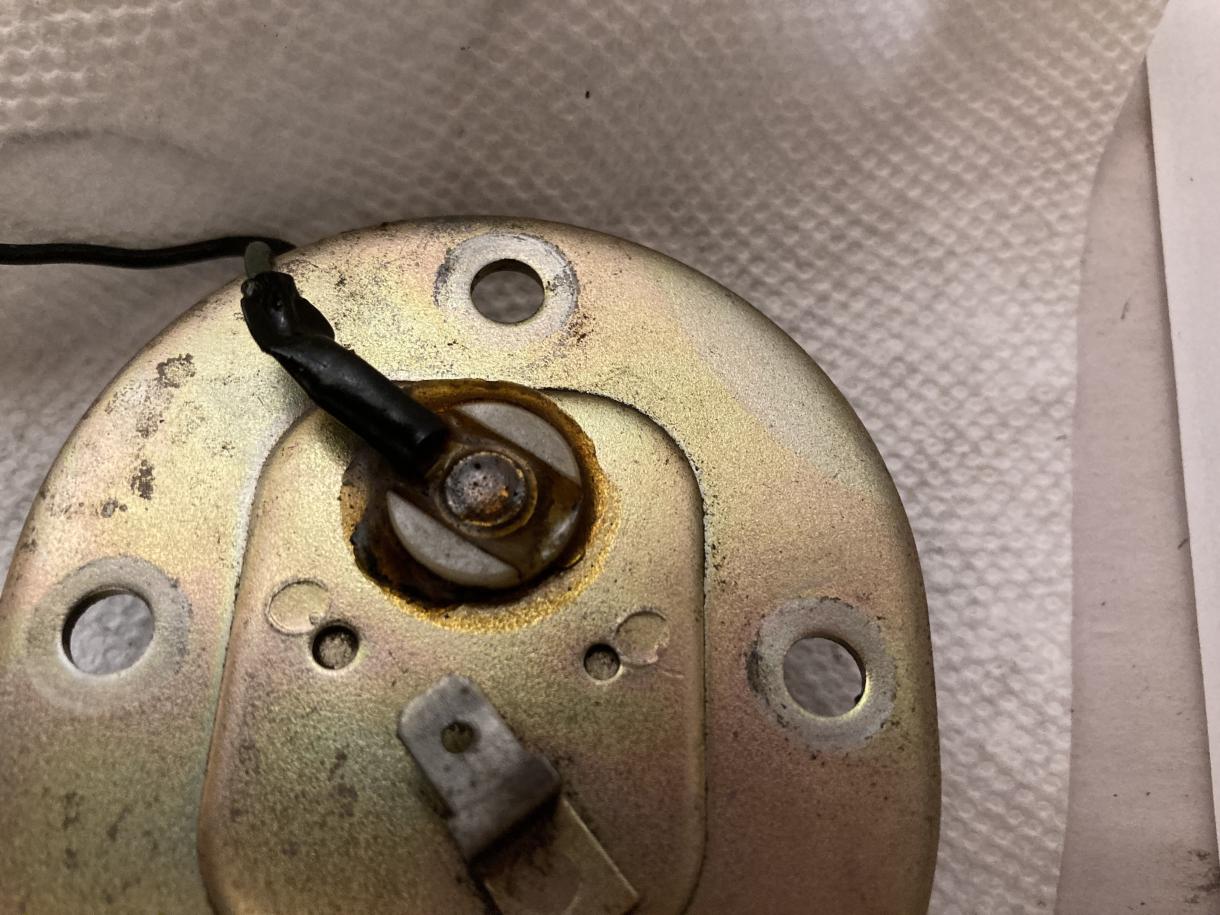

                          It took 2 weeks to receive the new gas tank sender gasket from Partzilla, so I pulled the sender out to replace the gasket.
                          Based on @jetmechmarty's experience, I scrutinized the area where the conductor passes through the plate. It definitely looked suspect on the outside:

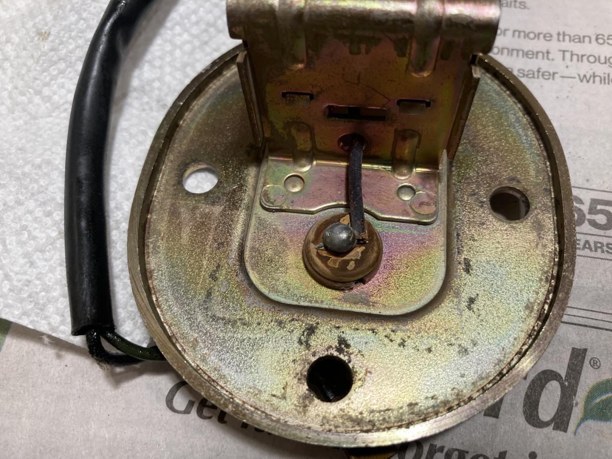

                          The inside had a plastic ring cupped over a rubber gasket. The plastic ring looks cracked:
                          I am debating whether to fix the outside only, or to gob sealer over the inside and the outside.
