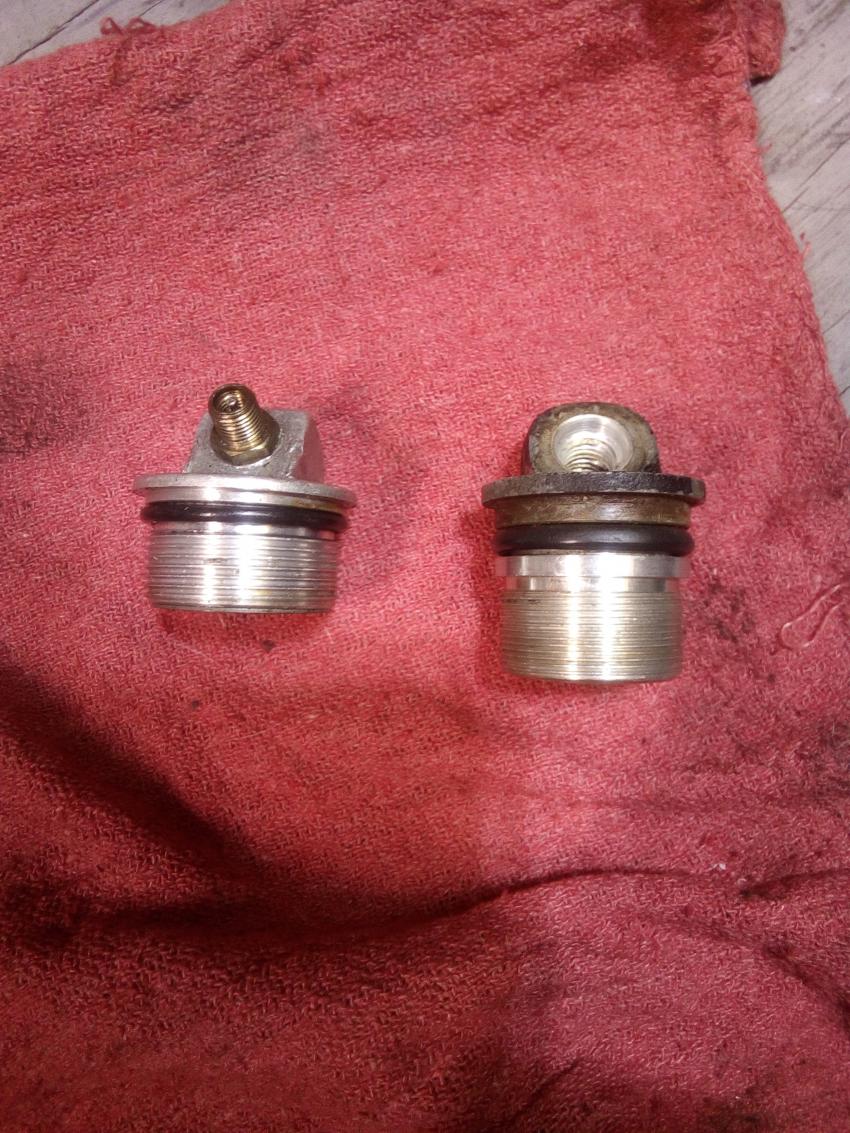

            I was pondering that someone who was searching for the origianal caps might be able to mount a schrader valve on those blanks.
              Apparently, the Kawasaki parts are also NLA.
                Those caps would fit a Standard only, they have fine threads, the Special caps have coarse threads.
                  Thanks! That means the air caps have to stay.
                    Click image for larger version  Name:	IMG_20211024_214924.jpg Views:	0 Size:	179.9 KB ID:	866905
                    Yep, just went and checked them to be sure, Standard (KYB) air caps are 1.0 thread pitch, Special (Showa) are 1.5
                    Special on the left.

                      I should have been more clear. The ones I used are for the standard model which use m30x1.0 threads.
                        You did state they were for a Standard in your first post...
                        I'm upgrading my forks on my XS1100G with Racetech cartridge emulators and heavier springs, so I'm ditching the schrader valve fork caps for solid ones. I had a hard time finding non-air caps that would work.
                        XS1100G is a 1980 Standard.
