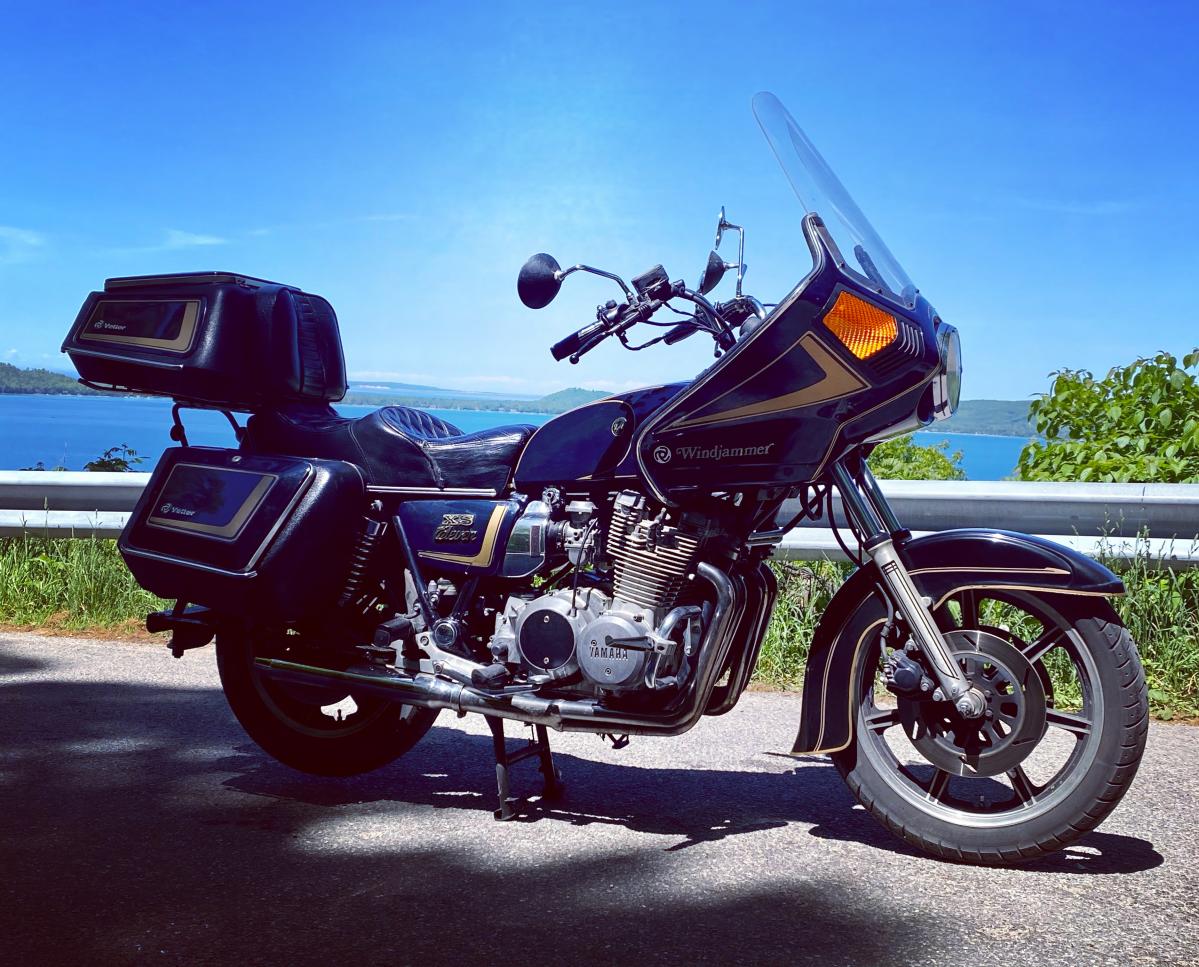

                  Originally posted by jpiombo67
                  Bikerphil... not quite sure it says it in the badge. I’m going to research the vin and see what I come up with.
                  That's interesting, would love to see it...... could you post a picture of that badge?
                  Thanks,
                  • jpiombo67
                    • May 2021
                    • 33
                    • Traverse City, Michigan
                    Here is the picture of the badge. Possibly an aftermarket build? VIN number reflects base trim
                    2017 CRF 250 Rally
                    1979 XS 1100
                    1985 Porsche 944
                    1991 Alfa 164
                      That's a cool badge and a great looking bike, thanks for posting pics.
                        With the color, I would guess Bob Jones had a hand in that bike. Check the rear shocks for a sticker from Merriam Cycles.
                          The gold detail on the side covers look like this bike, which was just purchased by one of our members in Traverse City, Michigan:
                            Mike, look at the tank, it has the same "logo". Karla may remember if Bob did something like that for a "touring" look machine.
                              And the same front fender and same seat... looks like the same bike to me!
