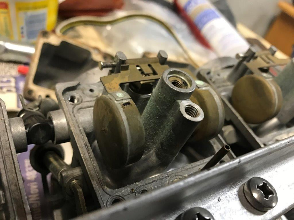

    I has a similar problem with two of my XS750's independently. They ran fine until the RPM got to 5k, the they would stumble and RPM would not increase.
    In both cases, the main jets were clogged with corrosion. It was strange because in both cases, the carbs had been rebuilt 2-3 years before the incidents.
    This happened during a period when I drained the carb bowls for winter storage. Believe it or not, I have not any more trouble (yet) since I stopped draining the carb bowls for storage about 6 years ago.
    I don't know if this is related to your problem, but it's more information for you.
