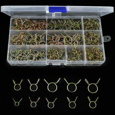

                I think my original clamps were the wire spring clamps with the 2 hoops at the ends. I bought an assortment like this:
                https://www.ebay.com/itm/23357165887...gaAv5nEALw_wcB
                You should get several feet of hose, it also works on most small engines. I also purchased a couple of elbows because the new fuel line wanted to kink when I copied the routing and length of my original octy. There are 90° filters available since your petcock screens may be on the way out if they aren't beat already.
