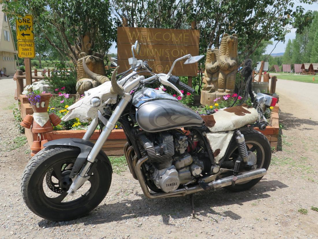

                          EL TORO will live on forever .......................
                          The most fun XS1100 ever made
                          Don't mess with the Bull
