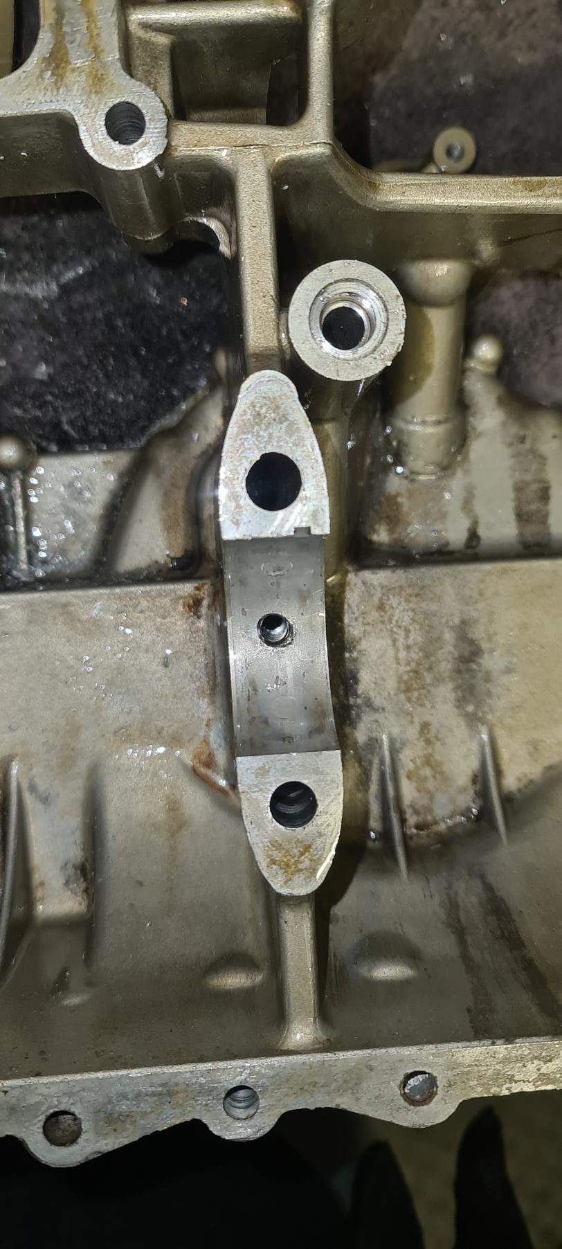

    Hello All, I have recently joined here. I have a 1979 XS1100 (very early serial number and matching frame.
    I have had it in bits for a while and now it is time to attempt a rebuild. Does anyone know if a scratch on the crankcase bearing housing renders the case junk? I have a stuck nozzle and the drill bit snapped and in turn scratching the housing. Getting another lower engine casing is not a problem but I would like to keep the original if possible. Any info would be appreciated. Thanks 😊

    It will depend on how deep and long the scratch is. If you post a photo with a pence next to the scratch, it would make it easy to figure out. The other way to look at it is under 1mm wide, .5mm deep you should be good.

                            You never know, you dig deeper you might find something. Right!!! Here is the pic.
                            Now I know I have messed it up so please be gentle.
