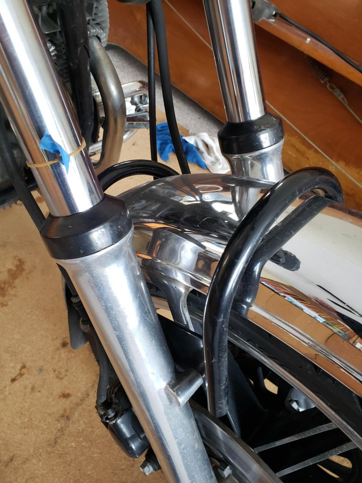

    Anybody recognize this?
    Here is a pic of my 1980 XS1100SG front end. I have not been able to find a fork brace like this in any XS1100 pics on the internet. The curiosity is killing me. Does anybody recognize this?

    It's an old school hoop brace, seen them on XS's before, don't see too many for sale, I guess they work.
      • 8083
      MikesXS has it in chrome. https://www.mikesxs.net/yamaha-xs650...5mm-forks.html XS1100 is not listed in the fitment guide. You'll have to trust me that it will fit the standard XS1100. It will not fit the Eleven Special.
      MikesXS also sells a Tarozzi brace for the standard XS1100, or you can buy it from Fast From the Past if you prefer.
        • 7837
        I have one of those here! They do NOT work as well as the aluminum brace, but are better than no brace. T-Kat showed me the difference years ago when he was still building his fork brace. If you put the front tire between your knees and wiggle the handlebars, you can see how much the front end moves. The hoop cut the movement about 20%, and the T-Kat cut it about 80%. The Tarozzi is as close as you can find to the T-Kat now. Bad news is it will NOT fit your special. Keep the hoop brace!
          • 8083
          The hoop brace will also contribute to a stiction issue if the fit isn’t precise.
            Cruiser, that fork brace was originally offered through Yamaha Accessories, back in the day. As Diver Ray stated, they ARE a definite improvement for front-end handleing, and DO save wear on the internal bronze bushing of lower fork leg, which are no longer available!

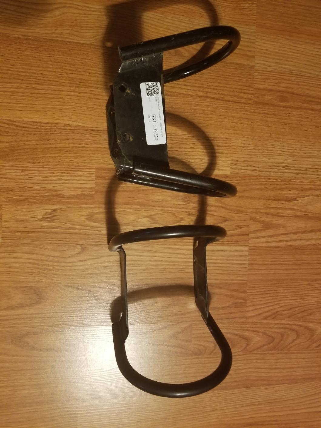

              I use the Telefix on my 78' and hoop brace on the 79's didn't like the high speed wobble.

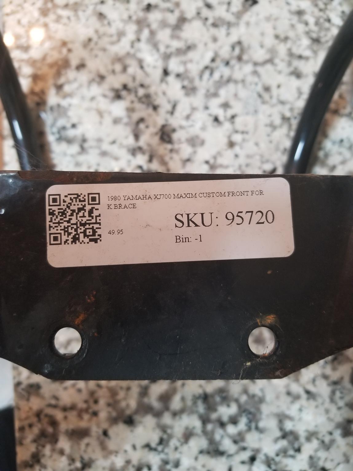

                He are pictures and still have Yamaha sticker. Was for 1980 XJ700 Maxi. Click image for larger version  Name:	20201218_175852.jpg Views:	0 Size:	136.2 KB ID:	862305 Click image for larger version  Name:	20201218_175700.jpg Views:	0 Size:	175.5 KB ID:	862306

                  Thanks all for the replies. Bike is a recent purchase. Front end wobble is pretty bad, but the fork seals are shot. Once I replace those we'll see where we're at. Does a plexifairing also contribute to front end wobble seeing as it mounts to the handlebars?

                    Check/replace the steering stem bearings first. That is what I find wrong wit ha lot of older bikes, even low miles. If it's been sitting on the bearings, not moving, for years the rollers will make indents in the race. You now have a wobble. The fairing will mostly show things like sidewind, but if the front end is sound, no real problems.

                        Those hoop braces also often introduce stiction to the front end and cause more problems than they solve. This can be helped somewhat by very careful fitment paying attention to the brace fit inside the forks and bending/shimming until you are happy... but...Tkat brace was much better. Anybody heard from RC lately?

                          somesuch, Tkat is no longer working, and not in San Jose, or on the West coast! I exchanged emails with him about two months ago. He is retired in Florida, and possibly still reading here now and then, but not posting. He is a great guy, had a great product, but the numbers went down too far for him to keep building it. His shop was in Santa Clara, near SJC. I've been there a few times.
