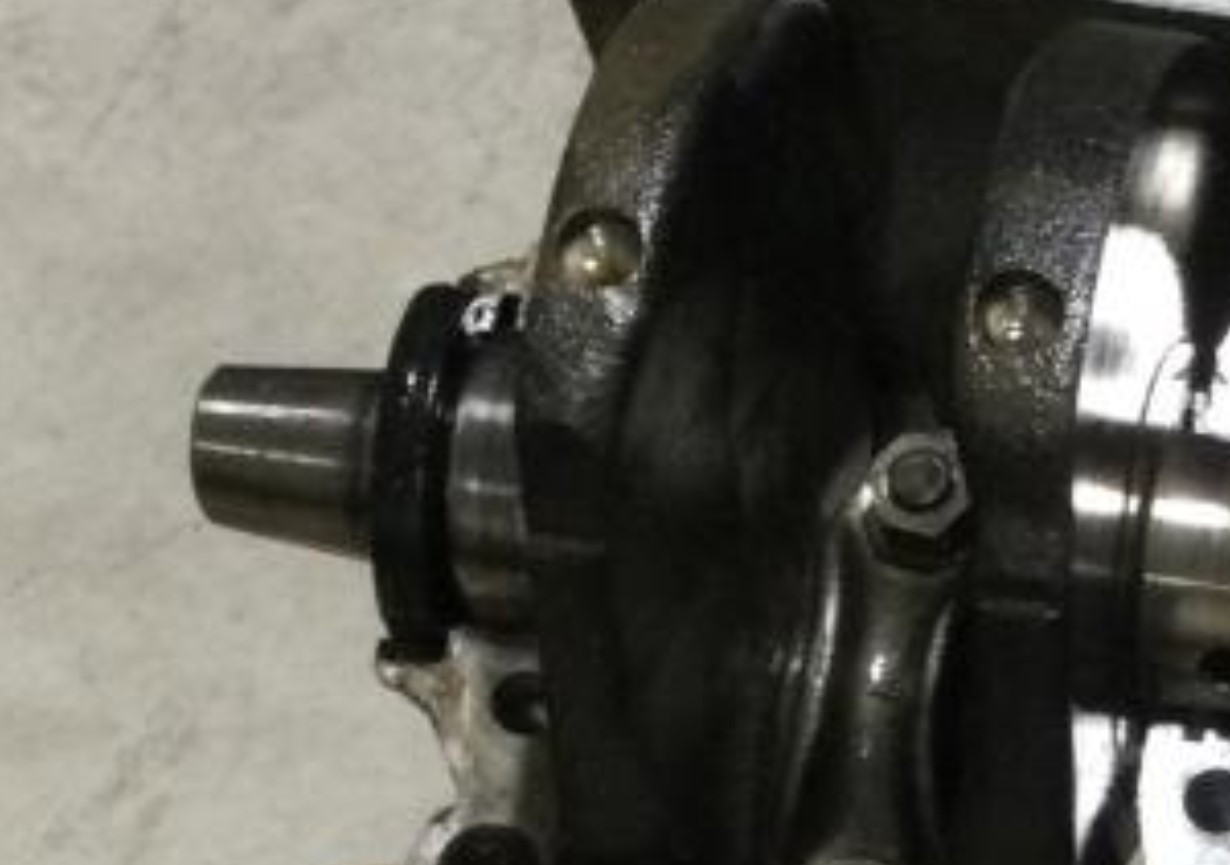

    Thanks giving blues.... spun #5 main bearing. Looks like POV ran it this way for a bit. Engine case is toast..

          Forgive my lack of understanding of what I am looking at in the pic that shows the spun bearing?

            It is kind of hard to see with the low-res picture and weird angle but you're looking at the upper case half so #5 is on the far left with the taper for the alternator rotor.

              Thankfully, I have a spare engine. When I pullled the pan I found a few foil flakes and obviously had to find the source. The first sign of trouble appeared when I inspected the alternator and noticed that the rotor had made contact with the stator. Curiously, there was no oil leaking past the seal even though the spun bearing had galled, scorched and deformed the bearing journal significantly. Anyone who has had to split the engine case knows this takes a while, but at times it is necessary. Too bad, because everything else is in pristine condition and now I won’t have a VIN match any longer.
