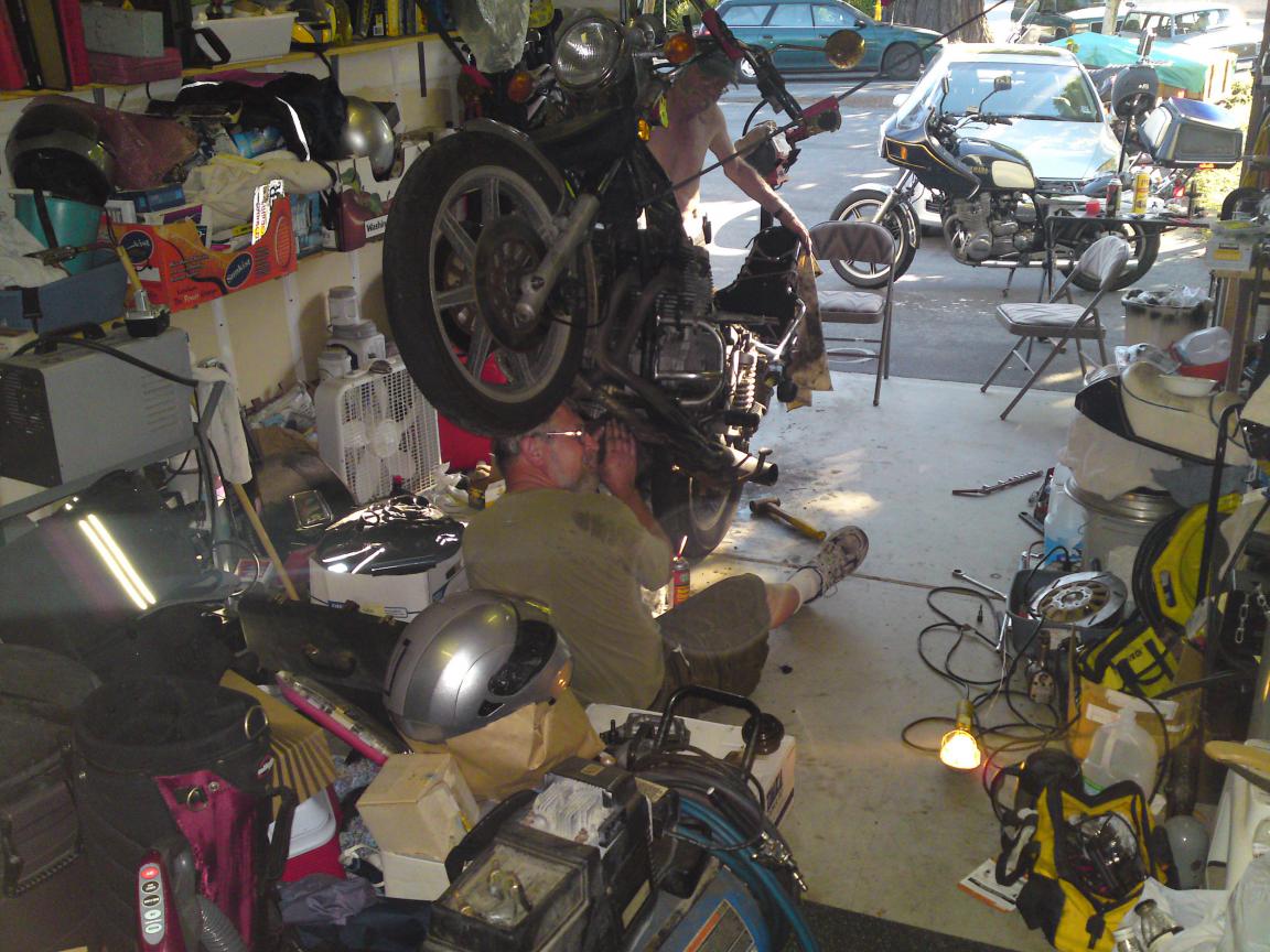

      There are lots of fnu and adventures in store for you once you get that 'Special up and running so you need pictures.
        That was Special Ed, NOT me! I just helped with the repair....

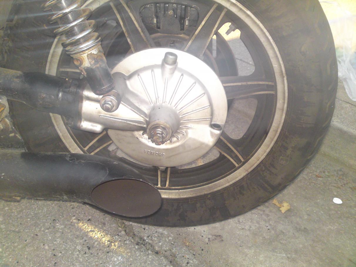

        Mine was the trans lock-up at 85mph leaving Yosemite a few years ago. about 250' black stripe, and a tire almost through the cords in just one place...
          Yep, you had to ride down with a spare final drive for Ed and put it on right there on the street. I think that was a year after you'd hung his bike from the rafters and done the 2nd Gear fix!

            Off topic but thanks for the picture of the 2nd gear fix. Mine will be hanging like that soon. I really wasn't looking forward to a backache working it with both wheels on the ground. Great idea hanging the bike!
            I can't wait to actually have a second gear.
