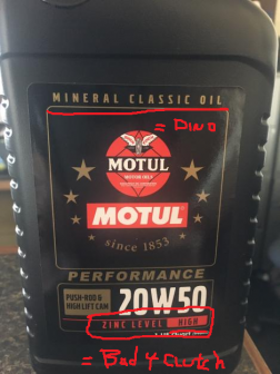

                            Thanks guys! The consensus was correct. I changed the oil to the Motul in the pic and first cold start this AM she turned right over! YAY! Cheap fix.

                              Hi JonnyO, Any oil SH or higher that has a listing on the API badge lower rocker "Energy Conserving" or something like that will have additives that will plate your clutch. For the XS its both the starter and the drive clutchs. Most HD models have 3 sumps so the engine sump can take a high zinc formula and not affect the clutch plates in the primary.
