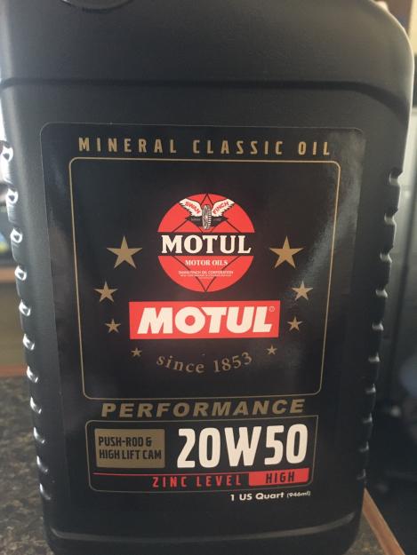

        Thanks guys! The consensus was correct. I changed the oil to the Motul in the pic and first cold start this AM she turned right over! YAY! Cheap fix.
        On a side note ( that should get some good laughs ) I was a cussin' and a fumin'!!! -as the first plug I removed was the middle-drive drain plug! What a f'n idiot! OF COURSE then I had to top that back up...AND OVER-FILLED IT ...and then had to get a little out. :-D Serious idiocy on display yesterday. It's hell gettin' old.

        ANYWAY...thanks again! Click image for larger version
