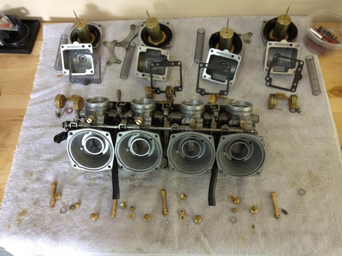

    I would like to add…. Be sure and keep the old parts you will be reusing separated so you can put them back into the carb they came out of. Like floats. I lay them all out on a towel and in separate piles linked to a carb. I trying to add a picture. Jeff

      To verify what Phil said, here is a picture of the rebuild kits for your year model carbs. Notice the float needle seats only come with the metal washer that they sit on. The other big differences are the float needles do not have the rubber tips on them and the pilot jet tunnel screws thread into their respective tunnels with the heads exposed.

      Thanks, not my first rodeo but appreciate it. I use egg cartons. I would be certain to catch a fingernail / tool / whatever and mix them up hopelessly (or worse, dump them on the floor) if I laid them out loose like that...
            I would have to agree with Marty on getting genuine Mikuni as far as the jets go. the float needle seat and float needles, washers and gaskets are generally ok. I have used them with no real problems. The jets I always stick with genuine Mikuni. I only posted the picture I did for reference on the parts themselves.
