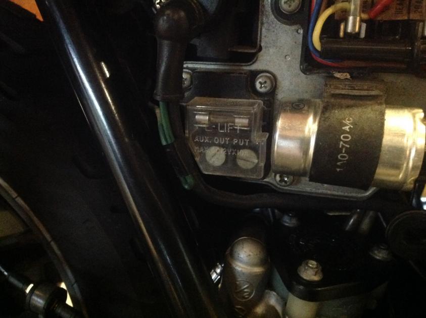

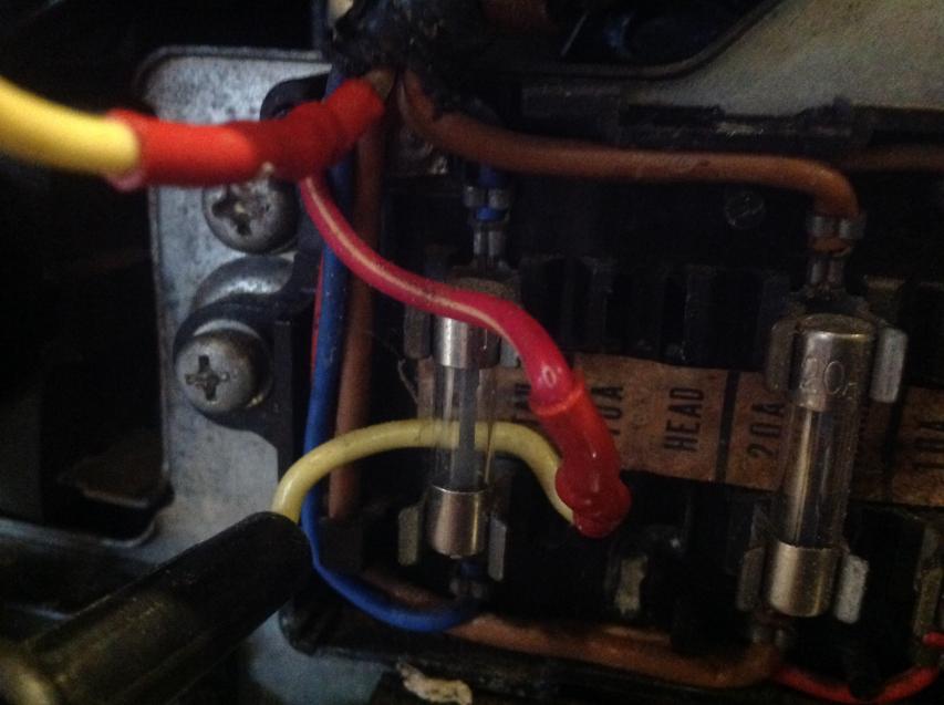

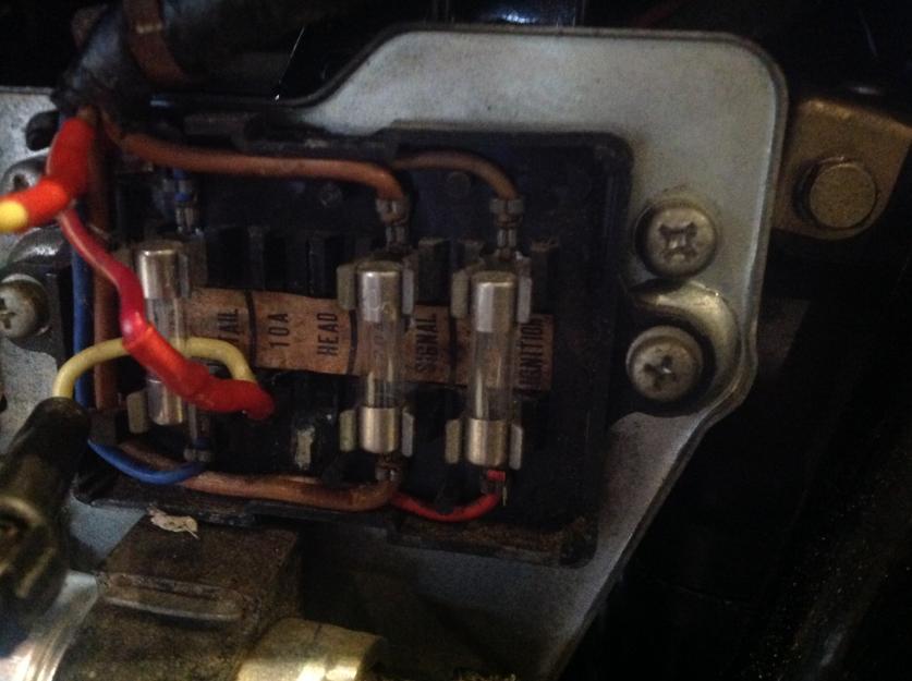

                    I have a SG that has the original fuse box still in it with only one holder bypassed...... Have the upgrade kit form Len at XJ4EVER probably getting installed this wknd. I'll take a few pics for you of the original wiring scheme when I get home.

                        I seem to remember that the English translated color codes on the electrical schematic in the manual had listed brown and chocolate as wire colors, nothing could go wrong with that...... Hope this helps

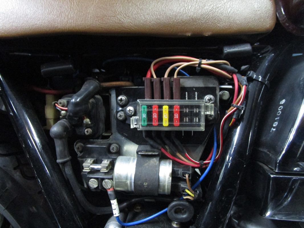

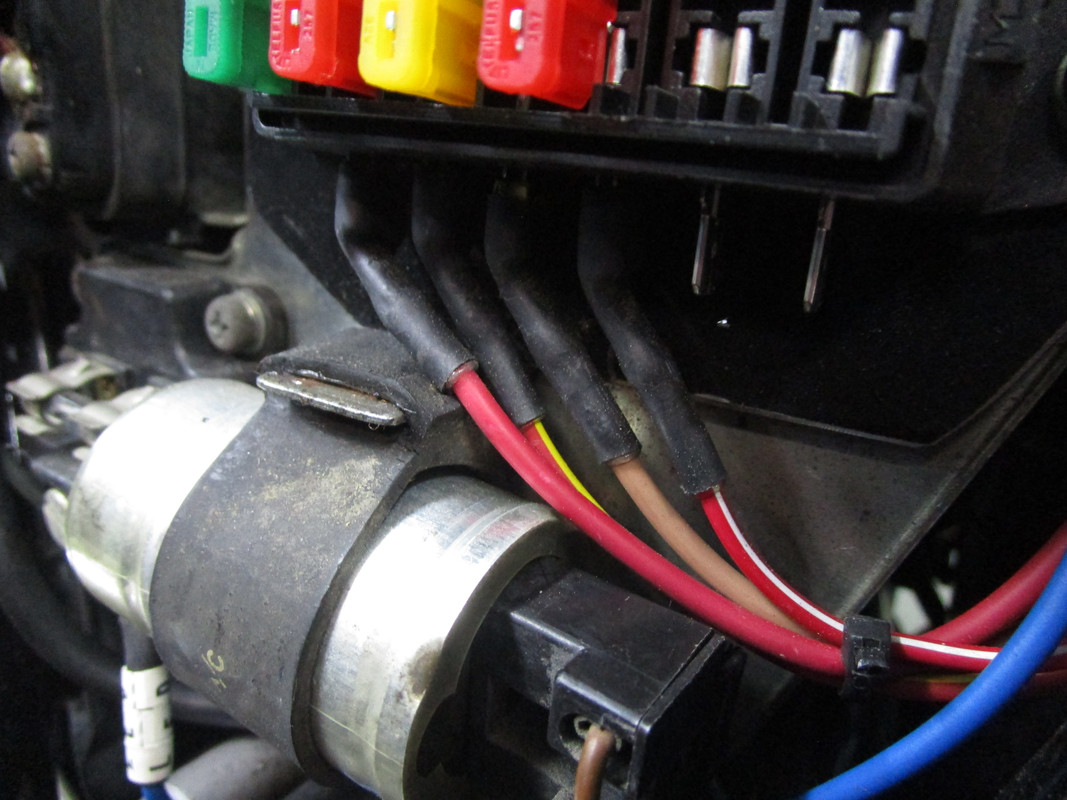

                            Hope that helps. This is my '79 with full LEN conversion.
