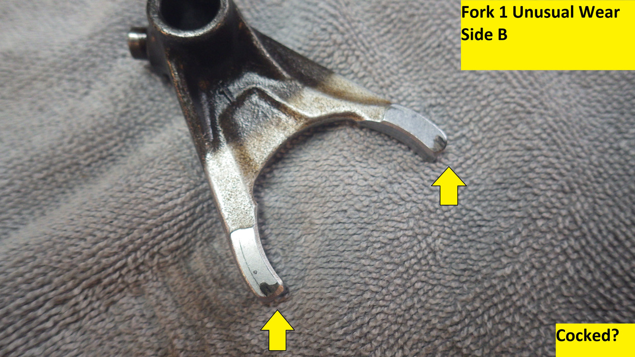

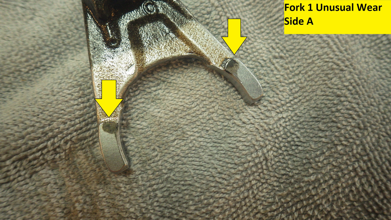

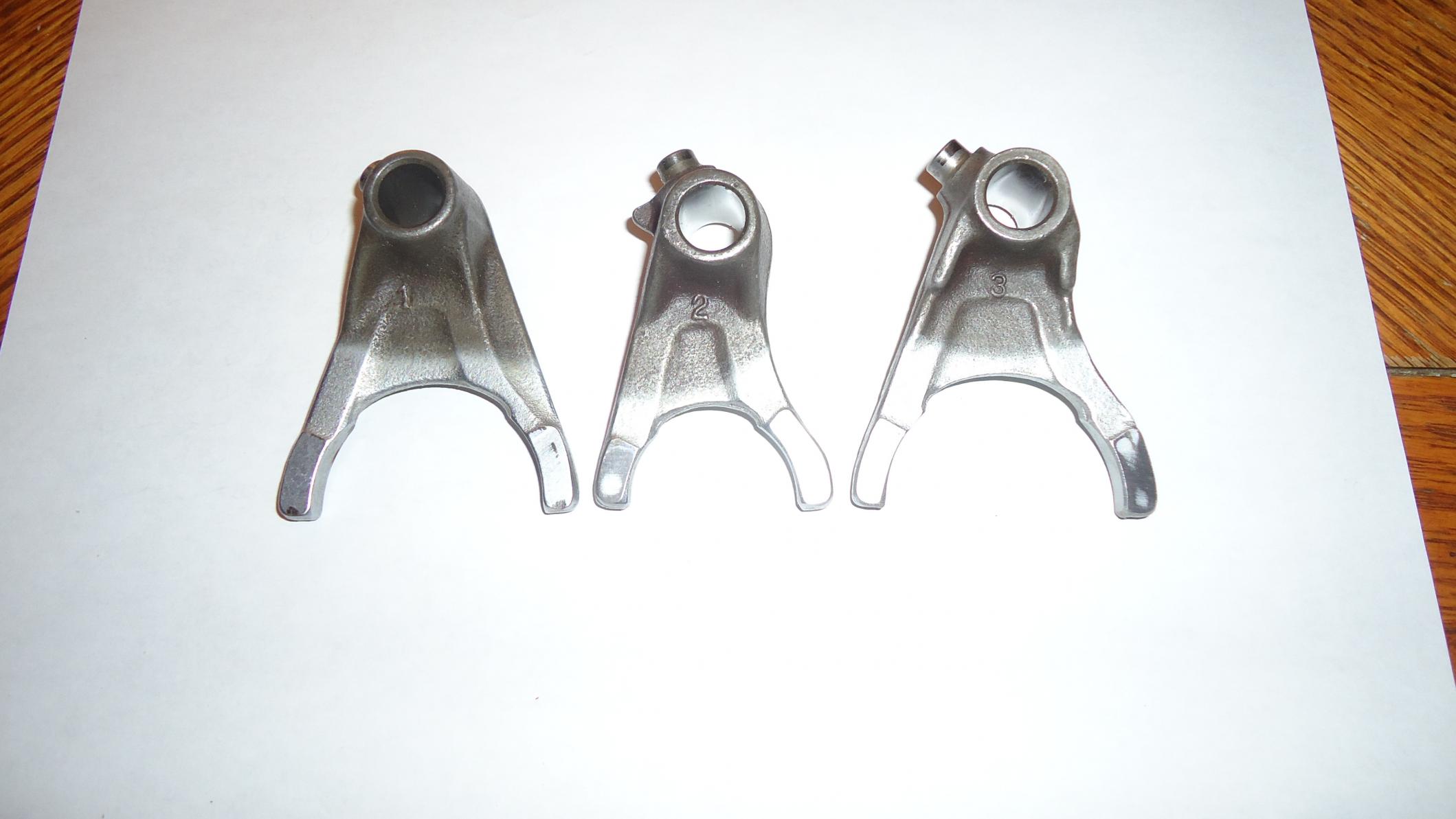

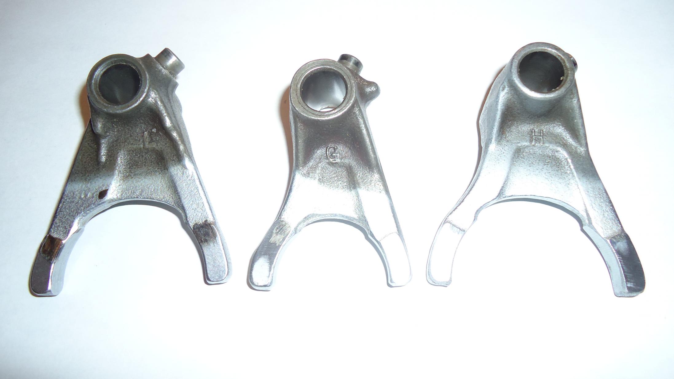

    Guys, just looking at some spare shifter forks and they are definitely unique - if PO swapped forks or didn't do the shim swap properly that could be the cause of that advanced wear. Forks are clearly labeled 1,2,3 on one side and L,G,H on the other - at least from my 80G and the trans I got from an '81.
ID:	867681 Click image for larger version
    1980 XS1100G (one owner-me)

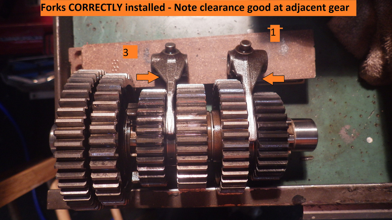

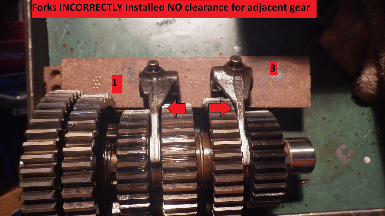

      XS11 Friends,
      Thanks for all the quick input. There is no doubt something was assembled incorrectly..... just trying to figure out what/how is the problem.
      I've done a bit of detective work and found the forks were installed in the correct positions. It's actually quite impossible to install them wrong. The #2 (Center) fork has a much smaller I.D. which will only fit in the correct position. If #1 & #3 were incorrectly inverted there would be no clearance for the adjacent gear. The impact would be significant and much worse damage had they been beaten into the incorrect positions.
      So, there is certainly a problem but not the major event of swapping the #1 & #3 fork. My detective work found yet another fork issue.... The #1 shows very abnormal wear as if it was "COCKED" .
      This made me a bit suspicious of the shaft that holds the forks.... I found nothing unusual as it isn't bent or wasn't installed incorrectly since it will only go in one direction.....
      What the heck is making the #1 act like it is cocked and the #3 is getting eaten up by the adjacent gear?
      Some additional info for my fellow detectives:
      • This transmission issue DID NOT act like a "Typical" 2nd gear issue.
        • In my experience the "Typical" 2nd gear issue the trans falls out of 2nd.
        • You can normally shift past 2nd and the bike sounds/rides pretty normal.
        • I know some folks have driven years by just skipping over 2nd.
      • The bike was very difficult to get into gear BANG! (much worse than the Russian Tractor we're use to), and extremely difficult to shift from 1st up to 2nd.
        • The "Typical" 2nd gear issue doesn't create this difficulty.
      • In addition, "Bad Gear Noises" were heard continuously.
      • I ASSUMED this was bad 2nd left too long without repair.
      • OBVIOUSLY, with the #3 fork not holding the adjacent gear in proper position, it was possibly partially engaged in the wrong position.
      Something is not correct with this shift fork, shift drum, fork shaft, etc....
      Thoughts?

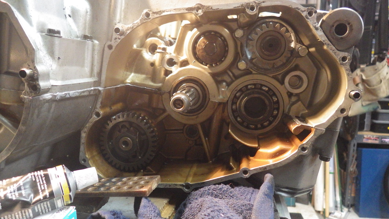

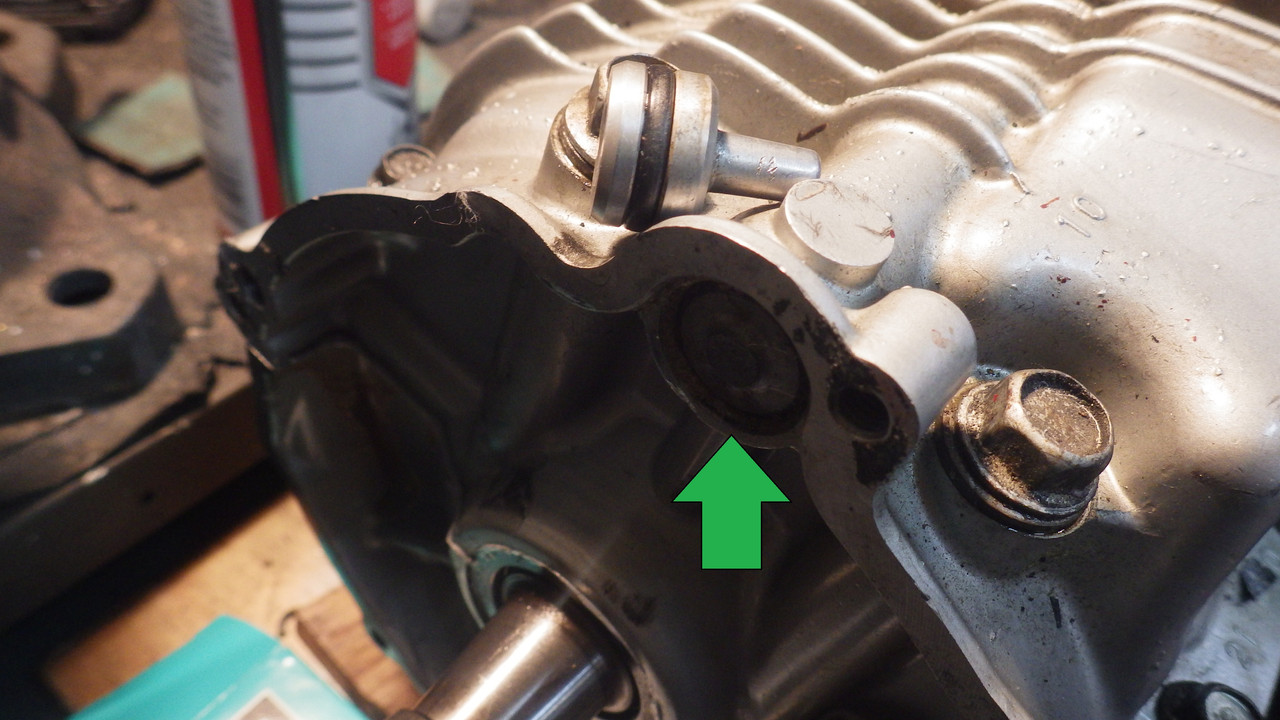

              Got the case sealing edges all cleaned up and coated with YAMABOND #4. Just applying a bit of assembly lube to the main journals before assembly.
              The internal color difference of the case halves and internal components is amazing.... Looks like someone was changing the oil while someone else wasn't! This could also be a indication of mileage as well. This '79 has 69k of REAL miles on it, the donor '80 bottom half had barely over 33k on it (I have the speedo and checked). I picked up the '80 for something like $200 up in Bowling Green, KY it provided the saddle bags for my blue XS11, a $350 SOLD beautiful fuel tank, and now the bottom half of it's blown engine.....of my many very poor spending choices this was a good one.

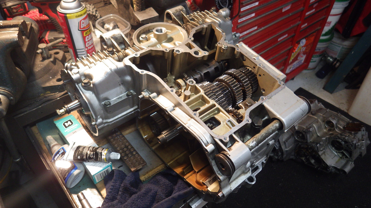

              Assembly of the gearbox is partially complete and all the original gears are back in there. I have several donor 2nd's but none looked any better than this one (some looked worse). I've used the gear selector drum from the '80 and will replace the #3 fork with a really nice one. Seeing the condition of other parts inside and the discoloration, I'm leaning more and more toward a clutch problem. I have yet to inspect the clutch components but have several spares and new springs should they be needed.
              Tomorrow I'll get the shift forks and etc. all back in there and install the bottom end into the frame. It'll be much easier to lift the motor and avoid scratching the powder coated frame with the smaller and lighter bottom end.

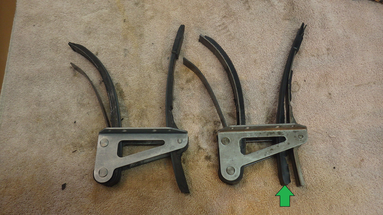

              I found that the chain tensioner was about to fall into pieces so a donor (probably also from the '80) will be used instead.
              There was one minor casualty with the '80 bottom end as at some point the little "Tit" on the oil galley plug was busted off. The donor motor had been pushed around the garage for a couple years so I'm amazed no other damage happened. I'll need to drill it and pop the broken one out with a seal pick or similar. Fortunately, the plug from the '79 lower case pulled right out without any problem.
              Hopefully...... be running and riding before the end of the weekend.... THAT'S THE TARGET ANYWAY!

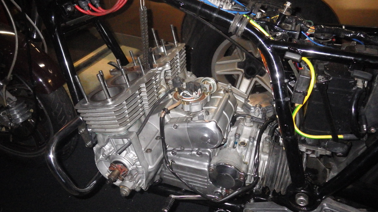

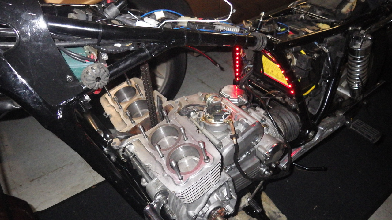

                Making progress........ But my plan to be running by the end of the weekend MAY have been a BIT too aggressive.
                Finished the transmission assembly and installed the motor in the frame.
                • I was able to find a couple much better condition shift forks
                • The shift drum was replaced with another spare.
                • I replaced the shift fork shaft (just in case).
                The transmission shifted through the gears very nice and smooth.....and I could find no additional discrepancies.
                • Nancy helped me load the short-block into the frame and get it secured
                • Pistons & Cylinders are installed..... I'm thankful Yamaha put a nice little taper on the bottom of the cylinder making the install (rings) a breeze. They basically "squished themselves" into position.
                • Middle drive is back in and filled with gear lube
                • Starter is on and wired back in.
                • I noticed the shift pawl did not properly align with the drum so a minor adjustment was made to the eccentric pins and the side cover installed.

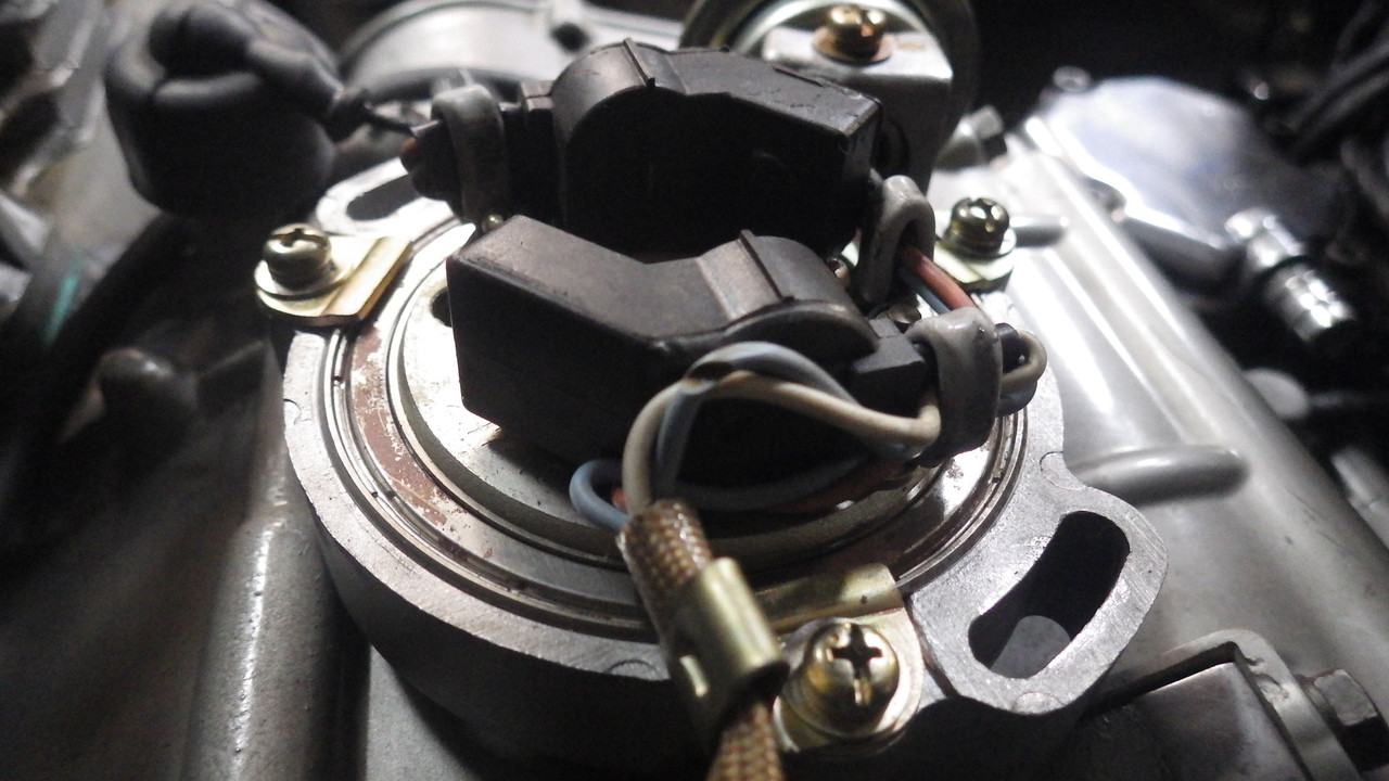

                Unfortunately another minor discrepancy was found which will slow down the progress..... I found some damage to the pick-up wires in two locations so I'll have to pull the ignition pick-up off the bike and repair the wires. No point installing if there are exposed conductors. I think I can pull the plug apart and slip some hat shrink over the wires. They are damaged in an area where they transition UNDER the back of the mid-drive and I also see a small problem directly under the pick-ups.
                I put the motor back in the frame after the powder coating so I'm likely responsible for pinching the wire behind the motor. Not sure what damaged the wire in the pick-up area.
                Although this is NOT a super-duper rebuild like I might perform on my favorite XS11 (Ugly Duckling), I won't put it together with something that is clearly wrong. I'm thoroughly inspecting everything as it goes back on the machine.
                I need to take a break. I THINK I'm getting too old for this kind of work!!
                KURT

                  It's alive.... or so it seems.
                  The "Motor" rebuild appears to be a great success. Swapping in the bottom half didn't (YET) appear to cause any difficulties with MOTOR operation.
                  • Started right up!
                  • I was expecting a super cloud of smoke with all the oil in the cylinders but none seem.
                    • There was some burn off from the oil that was all over the exterior of the motor.
                  • Idle was nice once warm
                  • No overflowing carbs,
                  • Timing appears very close (although I didn't actually check it correctly).
                  ON the center stand the clutch seemed to have absolutely NO EFFECT on the driven rear wheel when in gear. I also heard some funny noises gear noises . I'm getting suspicious of the middle drive on the gear noises...
                  Need to get it in the street in a day or two and check the transmission. It did shift up/down very clean and much better than before.... But the clutch seemingly doing nothing is a concern,
                  Kurt

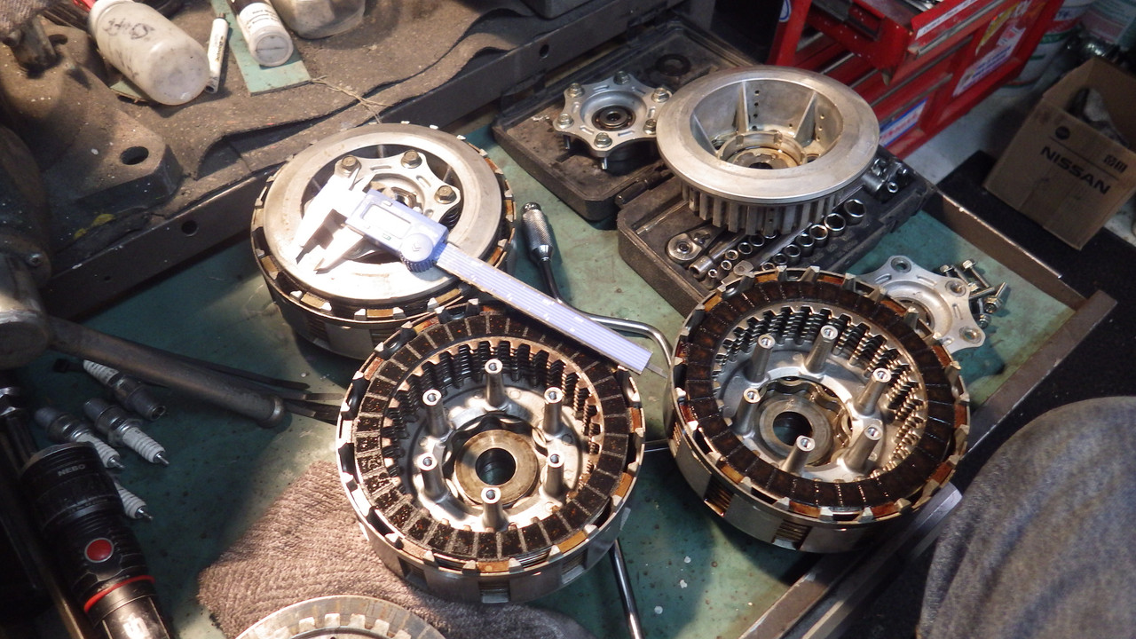

                            When I started the bike last night it was on the center stand. When I put it in the gear, as stated, the clutch SEEMED to do nothing. I put my foot on the back tire in gear and with the clutch fully pulled and the tire nearly took my foot off when I attempted to hold it still! It SEEMED as though something was wrong. In addition, as I ran through the first couple gears it didn't sound too good from that gear box. I'm guessing that lack of weight of the bike and no butt on the seat didn't give the clutch much resistance. Running through the gears with a shaft driven bike on a center stand and the gear lash in the middle drive & final drive was PROBABLY the noise I was hearing.
                            Today, sitting on concrete with my butt on the saddle, the clutch worked just fine. The clutch installed in the bike is from another '79 motor I grabbed up in North Georgia a couple years ago for $50. I had several spare clutch assemblies (photo). The clutch I picked had the best fibers at nearly .12" on every plate, the removed/original was close to (or below) the minimum standard of .11" on all of its discs.
                            I've made sooooooo many changes inside the motor & gearbox I'm at a complete loss to determine what EXACTLY fixed the issue with the transmission that started this whole event. I suspect the clutch was a big part of that problem. With marginal discs, it may not have ever been completely "Grabbing" as all the discs were thinner than preferred specification.
                            • Replacement Clutch - Better Condition Used.
