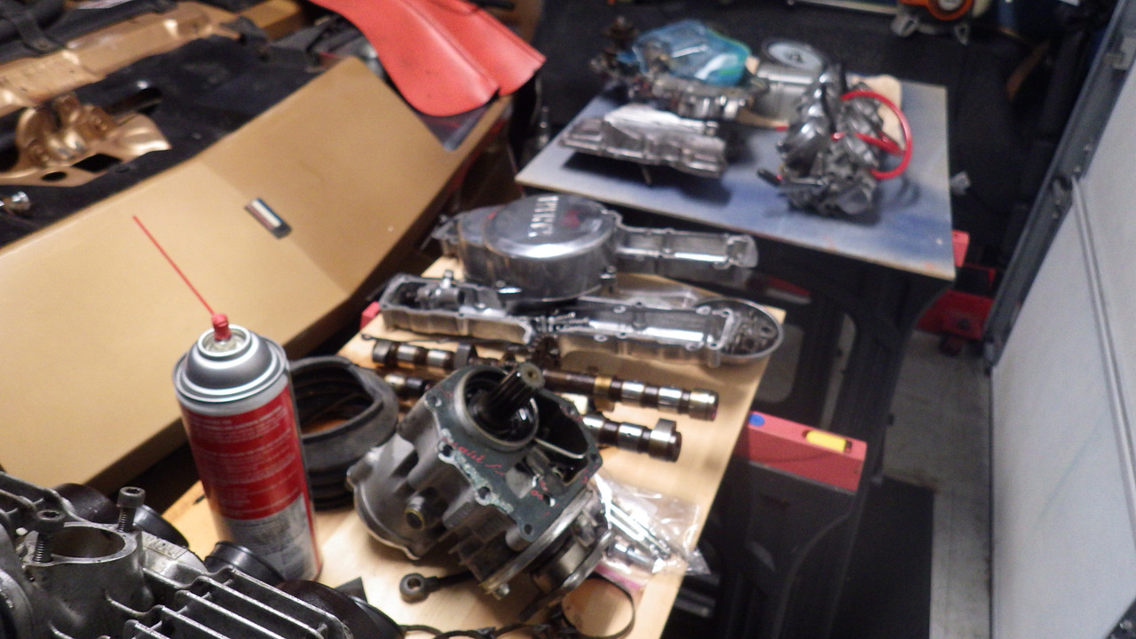

          XS11 Friends,
          Motor disassembly has begun and this 43 year old b****h is fighting me at every nut & bolt! The head/cylinder studs were all rusted into the aluminum head making removal and absolute nightmare! Several days pulling and prying, soaking with KroilOil and more pulling, prying, and smacking with a rubber hammer, dead blow, and then an ACTUAL HAMMER! Finally, the head and the cylinders are OFF. YES, there was some minor fin damage, but probably be invisible without being pointed out.
          I managed to pull the motor without damaging any of that beautiful powder coating. I pulled more off than I usually would to make the motor light enough to pull myself without help.

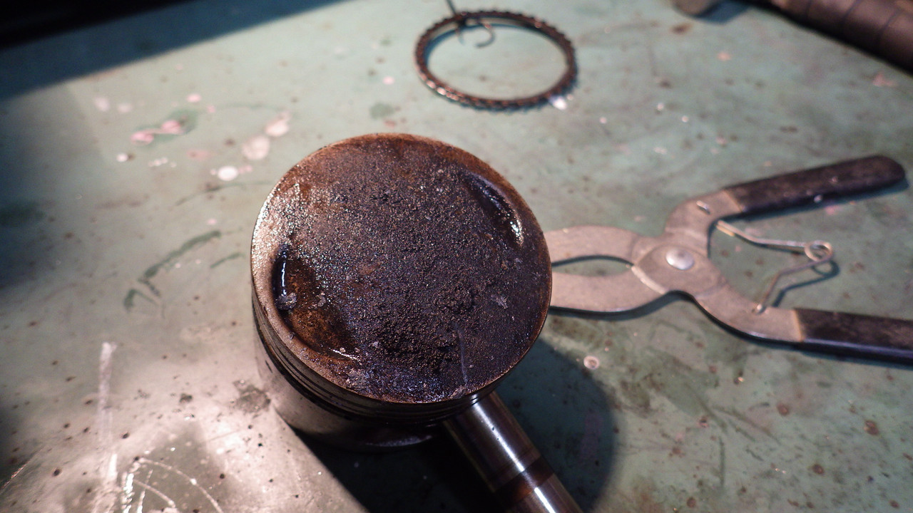

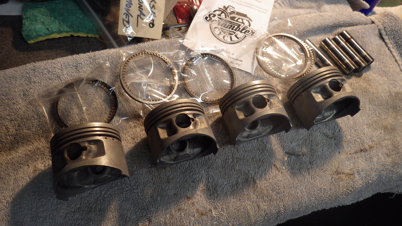

          The machine had good compression at ~125-130 across the board, although I have no idea how she managed that! Several of the rings were absolutely STUCK, end gaps were misaligned, and the oil ports in the oil ring grooves and the skirt ports were all completely full of crud. I gave the pistons a nice bath in 70c Simple Green & water mix in the Ultrasonic Washer and they look like new. The pistons will be new rings (STD) and I'll double check the end gaps to make sure they're pretty close (file only if necessary). I have a decent bottle-brush hone and will try to give the cylinders a little cross-hatch pattern.

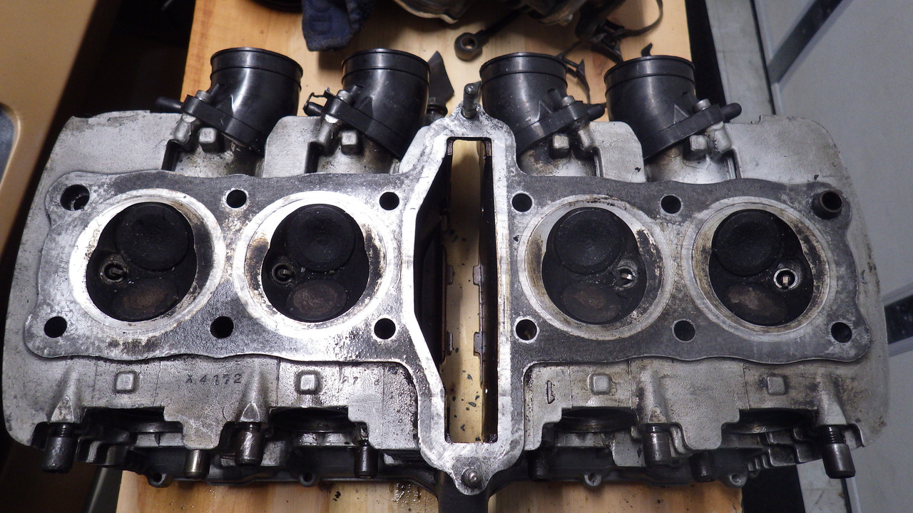

          The head/valves look pretty crappy with 69k miles on the ticker the valves will all need to be cleaned and then the head will get new valve seals. Otherwise, the head seems totally serviceable with good looking cams, nice exhaust studs, new intake boots, and only one slightly damaged fin. Fortunately, all my VERY AGGRESSIVE removal methods did not cause any damage to the cylinder head sealing surfaces.

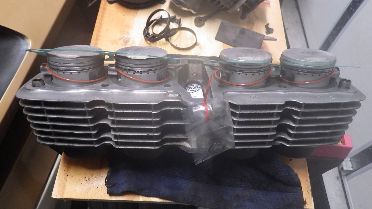

                  The EASY stuff is done.....
                  New rings installed on the pistons, cylinders have been cross-hatched with the bottle brush hone, and the SOB gasket completely removed from the base.
                  Head sitting ready for install with base o-rings and gasket.... THIS CHORE IS DONE.

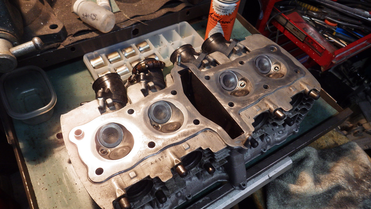

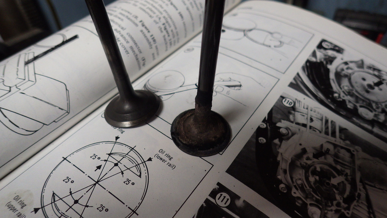

                  All new valve seals installed on the Intakes and Exhausts. Cleaned all the valves on my BRASS wire wheel to get 43 years of carbon off of them. Valve seats looked good and I read somewhere that lapping valves on these heads is a bad idea so with no obvious defects a little cleaning and back together she went. the OEM '79 Valve seals were HARD AS A ROCK! I'm certain now that with new seals and new rings any smoking will be a thing of the past!
                  I was cautious not to take any real material off the head but the ONLY way to clean this up was with a mild scotch-brite on the die grinder. Most of the internal combustion chamber cleaning was done with a mini wire wheel on a Dremel. I still plan to run a drill bit through the mounting stud holes to make sure all the rust from the mounting studs is gone for good.

                    The amount of work you get done in one day takes me 3-4 weeks.
                    I realized the same thing about lapping valves- that you don't want to wear down the three facet shape of the soft valve seat. I still did a light lapping when I did the head on one of my Triples; just enough to see a consistent grey ring around the perimeter.
                    I had trouble bending the shaft of my brush hone when I used it. I ran it at 1200 RPM and pushed it in and out almost as fast as my arms could do it. Turns out I moved it in/out too fast and ended up with 70-90 degree cross hatching instead of 45 degrees. That engine was fine none-the-less.

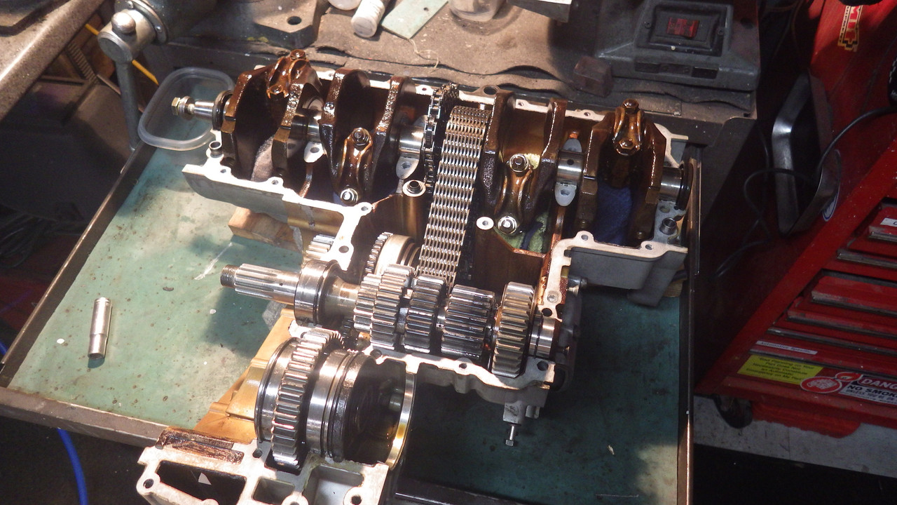

                        The cases are split....... if you ever wanted to see the guts of an XS11 ..... Here's your chance - LOL
                        The spare bottom end looks serviceable and doesn't have a broken oil pump flange...
                        The bearing callouts stamped in the base appear to be IDENTICAL to the original '79 base.
                        The main bearings in the '79 show some wear but nothing down to the copper as I've seen in other motors.
                        I'll pop the main bearings out of the old case and transplant into the '80 donor bottom case and start re-assembly.

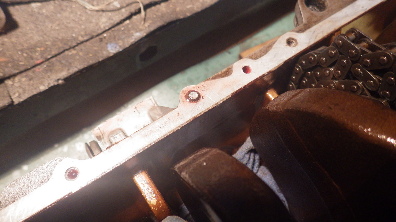

                        There is one minor casualty which should be an easy fix......one of the edge seal bolts snapped off... A little work and this one will come out....
                        NOTE; Someone has absolutely been into the gears before and performed the washer swap. None of the gears look too bad (I've seen MUCH worse). I do see a LOT of unusual wear on the 5th (?) gear shift fork, it must be replaced and I have the spares somewhere. I'm beginning to wonder if my original problem is related to a frozen or damaged clutch..... I'll inspect everything very closely but suspect something else is going on in here to make this thing ack like it's eating gears......
