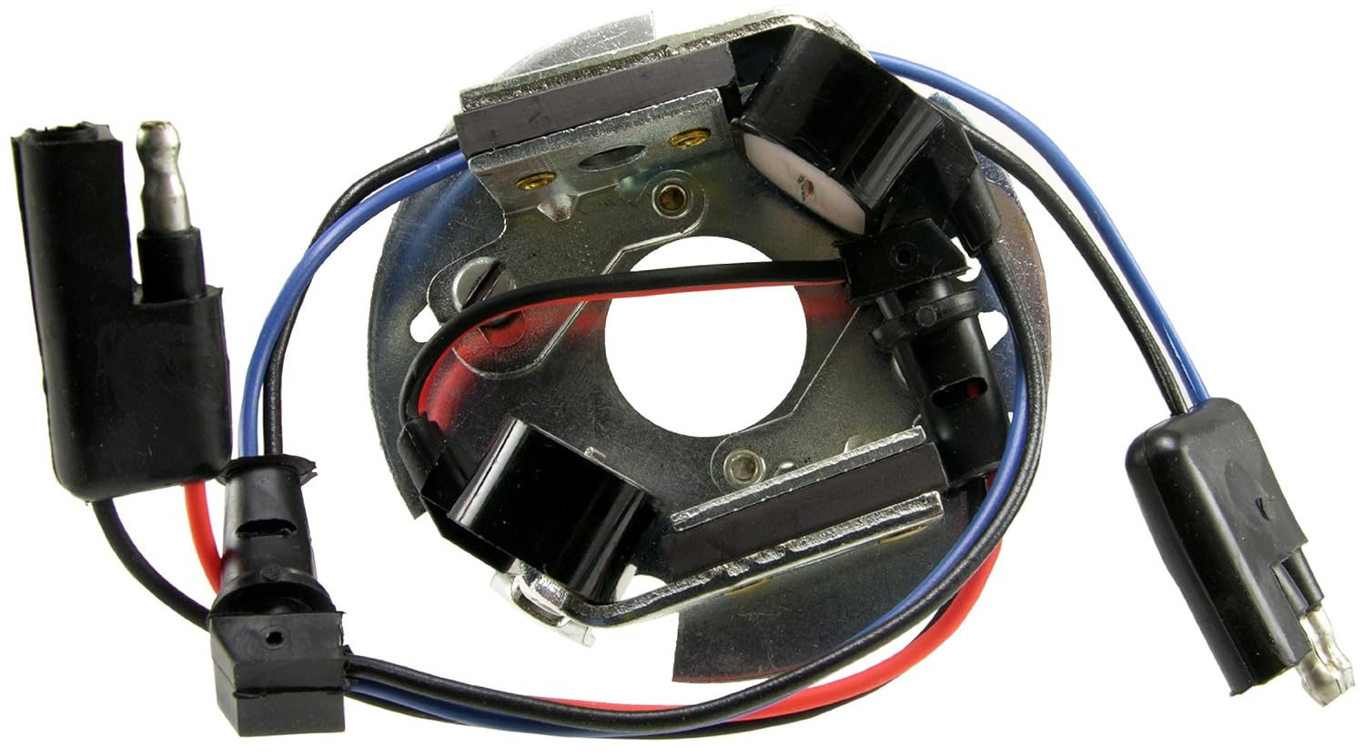

                        335 Ohm Wells CR-117 Dual Pick-up Coils - Maybe
                        T.C., I picked up the pick-up coils this afternoon. The new pick-ups are 180 degrees apart, they're not too tall and they're not molded in plastic.
                        The coils and permanment magnets are backward from the XS1100 part.
                        If the coil polarity is reversed, I can just switch the wires and it's all good.
                        The sad part is that you're correct, Yamaha wants a 20%, 575 Ohm minimum on the stock pick-coils and 337 Ohms for the new CR-117 is low
                        It might might work and it might not work, everything else requires minimal modification.
                        The black mark I made on the original timing plate
                        lines up nicely with the CR-717 pick-up coil inductor tip.
                        Coil #1 is 337 Ohms
                        Coil #2 is 339 Ohms
                        The slideshow with more pictures.
                        Wells/Duralast CR-717 dual pick-up coils and the XS1100 timing assembly

                          Would it be possible to add a resistor in line to bring it up to 720ish? Would something like that work?
                          79 SF parts bike.
                            It's not that simple but I like the positive thinking.
                            The low resistance means there might not be enough copper wire in the pick-up coil to make a pulse that can trigger the TCI. It might be like that infamous amusement park game where the hammer swings but can't ring the bell.
