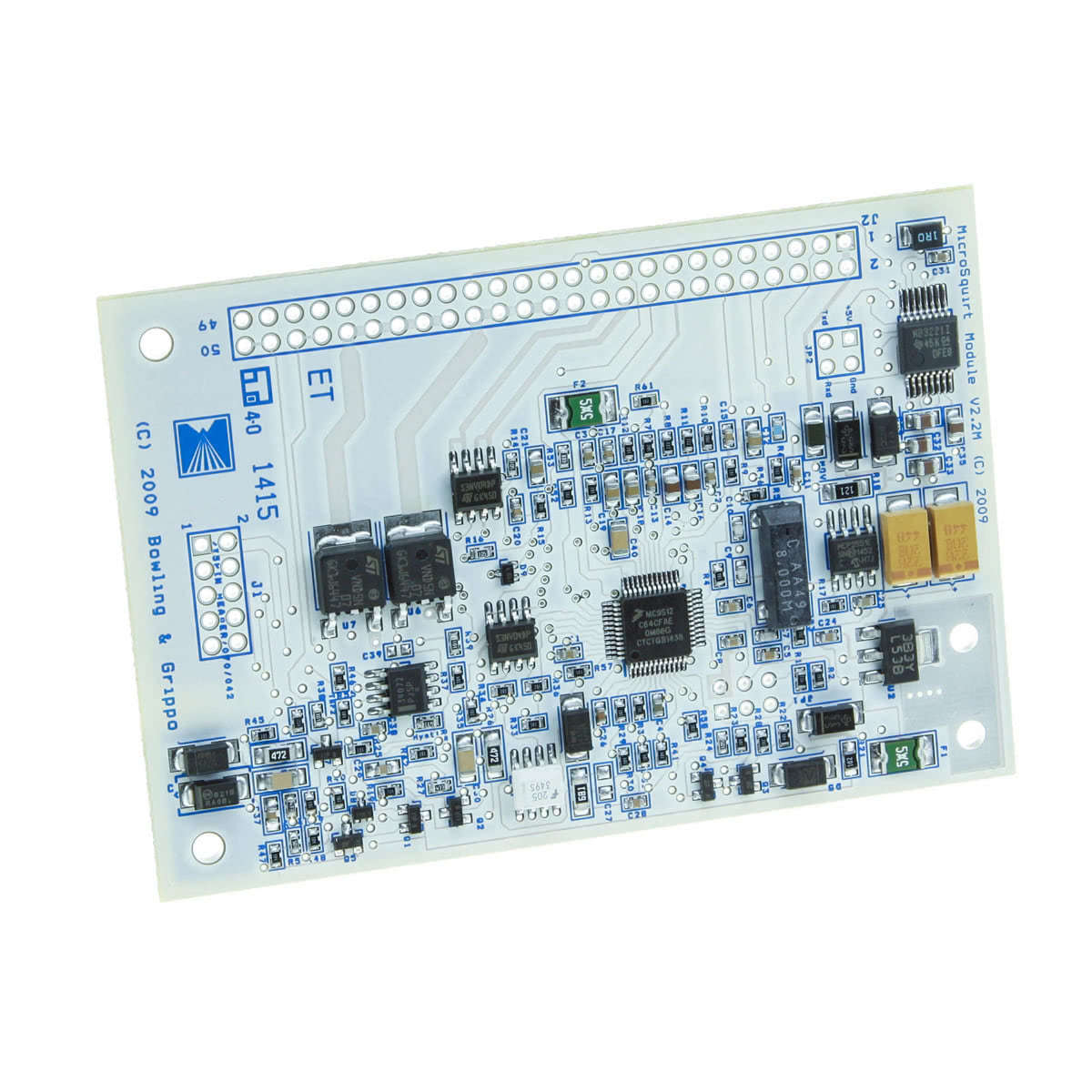

                MicroSquirt Module - a tiny core for building your own engine management!
                Thoughts?
                MicroSquirt Module is a credit card sized engine management board! This board packs all the features of the MicroSquirt except high current ignition drivers into a 3.5″ x 2.4″ PCB, with all components installed. This tiny ECU opens up unprecedented possibilities – there’s never been a standalone this tiny, or this adaptable. Got a racing series that allows any modification if you can fit in the stock ECU case? No problem! Want to make your own expanded I/O circuit board? Go right ahead – this board already has many of the key features you need for engine management, so simply add your own extra circuits and a connector! The possibilities are limited only by your imagination.

                  Anyone have a good quality picture of this?
                  i need one... for science.
                        The terminals shown on your diagram are on the right end of the pictured TCI in the top picture. The bottom picture shows the leads from the spade terminals at the point they are soldered to the board. The chart in your post describes where each lead goes in the bikes wiring.
                        There is a circuit in the TCI that shuts off power to the coils if the engine has not turned over for a few seconds. (The timing is via a capacitor, so the time varies , depending on the condition of the cap). Does the MicroSquirt have that feature?
