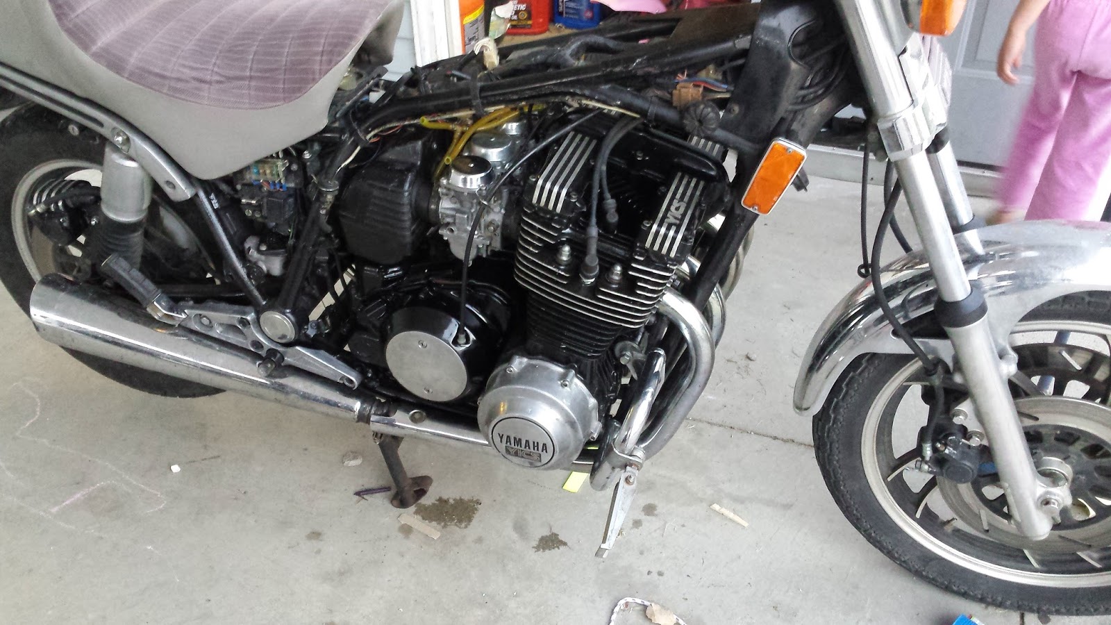

        Here is the before with my broken case:
        Here is the after with the new case painted.

                      Nice work!
                      The only possible problem is where you used the taper at the bottom of the jugs to slip them over the pistons and rings.
                      Sometimes that works so you don't need to use the ring compressors with blocks for the pistons and you sing and dance a little hornpipe, sometimes you snap a ring and you sing and dance an entirely different tune.
