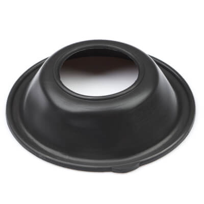

    I'm replacing the diaphragms on another members carbs and since this is my first experience with it I thought I would ask anyone here that has done it a couple of questions I have about the instructions in the repair section here.
    1) It says nothing about it in the instructions but should some sort of glue be used to keep the slides from spinning inadvertently in the replacement diaphragms?
    2) In the closing statement of the instructions it states that to check for leaks to hold push the slide up and hold your thumb over the vent and the slide shouldn't drop by itself. That makes no sense because there is a hole in the slide. The slide will still drop but not as quickly.

    Hey Greg- No glue necessary. If I remember right, those inserts are like a spanner, right? They just spin-on.
    And, the second part holds true. That diaphragm should drop very little if your thumb is held over the bell intake port. But, then again, you're the one whom has taught me most of what I am already telling you . . .

      They stretch over the groove the OEM parts fit into and must be properly oriented to work correctly when installed. I was just wondering if anyone who has done it had an issue with them moving.

                  The slides are different diameters on 78-79 and 80-81. The early slides are 28mm and the late ones are 29mm diameters.
                    • 4013
                    This top quality diaphragm is perfect to replace the old or split original. Suits 28MM slides on: XS750 & SE 1978-1980 Only N.B. The earlier XS750 uses a different diaphragm which is also available on our site.

                        I've used super glue on the ones I have replaced. No problems with any of them.

                          On the JBMIndustries site, they mention that the fitting "tire" section of the diaphragm is purposely made 1-2mm smaller than the slide...they are 25mm in diameter, because they are supposed to fit around and inside the slide groove where the OEM diaphragm sat.
                          So, take your calipers and measure the diameter of the groove of the slide, and as long as it's larger than 25mm, then the inexpensive ones will fit/work. And IF the inner groove is just 25mm, then their website also states the use of superglue will work to secure it to the slide so that the slide doesn't spin inside the diaphragm. I also thought MACK had fitted these to the early model carbs/slides a while back as well as posted a guide to it!?

                            I have a bunch of early slides that need them. Ian posted a source for the early (28mm slide) replacements, the ones I got are for the later (29mm slide). The ones I got were about $20 each and it looks like the others are about the same. Actually pretty cheap considering the alternative of buying a complete assembled slide from Mikes XS for $97 each and for the later carbs only.
                            I went ahead and put them on without any glue Mike. They seated down nice and snug in the groove in the slide. I can still turn them but not very easily. Time will tell.
                            I'll mark the slides on the airbox side so that they can be easily checked by just dropping the airbox down.
