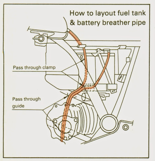

                                Clear pictures from service manual...
