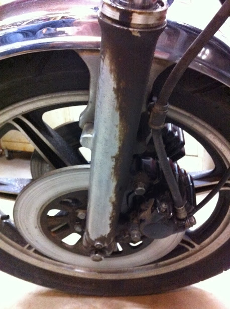

    excellent project, most stuff looks minor don't understand how someone can let forkseal go like that good luck with it

        I wish I could get one like that, cheaply. It's all minor stuff. Fork seals and cleaning the sliders is easy. Carb clean and diaphragms + float valves adds a bit to the cost. Brand new replica seats for this model are available in the UK but add further to the cost, of course

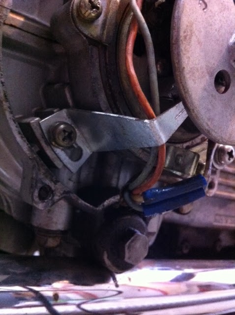

          I had some time to poke around at the bike. I got the cam cover off and did the chain tightener procedure and checked clearances but I forgot to check if the timing marks lined up. D-oh! Intakes are on the tight side of good (.0045) but the exhausts are on the loose side from .008 to .010 at the most. so it's pretty noisy.
          It starts great with the choke but won't rev well. I have to get the tank off and check the diaphragms and the synch.
          The timing indicator had been replaced with a flimsy chunk of sheet metal so I fabbed up a better replacement and set TDC with a dial indicator. I need to pick up a degree wheel.
          Hack job:
          Ahhh... Much better.
          Once that was all done, I set the timing. When I get it running better, I will check the centrifugal and vac advance.
