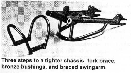

    Here's a photo from the XS650 site showing a braced swingarm, along with a FB.
    I did some bracing of my swingarm several years ago as well. I'll have to go upload the photos I have to my photobucket before I can post them. I used square tubing because I don't have a torch to be able to perform bending like that, and I thought that triangles would be stronger. It did seem to make the rear end stiffer, but I still have the hinge in the front of my frame/neck, along with my abnormally small trail due to my accident decade+ ago with a then unknown bent frame/neck! But I like the easier lighter steering, and I don't really need to go 100+ Mph much/often.

            Xs1100r
            It is similar to a 81 MNS but with the rare swirly 17" rear rim and no gold trim. Nice lookin' bike.

                      Okay, finally got around to uploading the other photos of my swingarm bracing to Photobucket. The welds are pretty, but you can see what I did. I tried to make the sections as short as possible=stiffer, as well as clearance for frame, and on the sideview they make a triangle, the strongest geometric shape from what I've been told!
                      These shots are of course with it mounted, showing the "lack" of wheel/tire clearance, but also clearance of other frame structures when mounted.
                      And it doesn't stick out/down that far so that it doesn't really detract from the STOCK look, since it's mostly hiding behind the footpeg mounts, and exhaust and such.

                        Heres a swing arm with decent bracing one of the UK lads has done
                        Hi Tom, would you have a pic or some dimensions of the underframe brace ?
                        Koni is now Ikon and I did some perusing on thier site which has a lot to offer.
                        That swingarm looks good but IMHO it could use a few more struts along the length and one in each corner.

                        The swingarm mod is worth considering and is completely reversible.
                        I googled swingarm bracing and there is some good info out there
                        Did you get a measurement of the space between the shaft and the inside of the SA ?

                          Here ya go Schming
                          And don't forget a point Errol (Eveready1100) made about the XS1100R's frame strength, the frame tubes were made of a slightly heavier gauge tube.
                          Yeah true, but I like the simplicity of it, its a beautiful thing that will give a huge amount of added strength.
                          The thinking behind the braced swing arm is to keep both sides of the thing fixed together, using twin shocks which may be unmatched can cause the rear wheel to pitch about with flex in the swing arm. Another way is to use a single shock and triangulation to the swing arm.
                          I also like the idea of mods that are reversable, I altered a swing arm to do my monoshock with even less changes (Yes the frame is heavily modded but it was scrap before I started anyway due to a major collision).
                          Tom

                            Thanxs for the pic of the brace, Tom.
                            Gives me a better idea of what I might be able to build.
                            I may have to solid mount the engine if the non-stock exhaust won't allow the brace to be fitted properly.
                            In your pic with the mono shock modded frame, I can't see how the swing arm still wouldn't flex under laterel force applied in a turn at speed with the final drive differential torque also.
                            I can see the balance you gained, with the mono shock, attaching the brace at the shock mounts. If the "U" bar brace was welded with strategically placed struts to the SA then IMHO T!Ts
                            The issue I see with the stock SA under bracing is final drive being part of the SA. Bracing, along the length should run from the SA pivot point to the axle equally on both sides.
                            The XS11's shaft side SA weld point is only half way to the axle.
                            Some tricky fabrication will be necessary to extend the bracing on the shaft side or just brace equally on both sides at a greater angle for maximum rigidity.
                              A bit like an anti roll bar on car suspension, on that one wheel may want to go up because its pushed up, the anti roll bar will pull up the opposite side. I simply used the original shock mounts on both sides.
