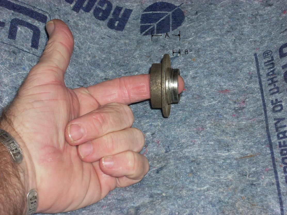

        Well. I have finally reached a minor milestone with this build, and it only took roughly eight years. I now have a rolling Chassis, sort of... The front wheel is good to go, just need to fab a thin spacer to take up some slack. The rear wheel is basically there in mock up. I have all the major components in there cept-n-fer the inner bearing cap that goes behind the cast caliper mount. As some of you may know I recently purchased some goodies from Andreas, and I am very happy with the deal he made for me. As fate would have it, I found a misplaced box of bulk hardware that I have amassed during this project. Low and behold, there was all the goodies that Andreas sent me. "how do you find a missing tool?... Buy a replacement".
        Many thanx to, Andreas, Bax, bikerphil, DiverRay and others.
        Like I said, I do not have the correct Standard Bearing Cap for my 17" wheel, fortunately I do have TWO Special Bearing Caps. Some may see where I am going with this... I want to turn down one of the Caps to the proper Standard size.
        Does anyone have the Standard Bearing Cap readily available to get some dimensions off? I need two dimensions, the overall thickness (A) and the distance to the step on the bearing side (B). B is just to be sure that there isn't a problem on that side. Here is an image of the Special Cap which I will cut down on my lathe. My calipers say, B = 5.95mm, we could assume that is nominally, 6.00mm. And A = 21.45mm for the Special. I am guessing the Standard (A) is about 5.00-6.00mm thinner. Can someone help me out here?

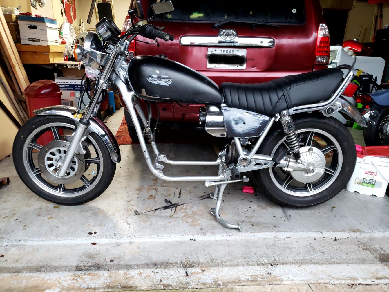

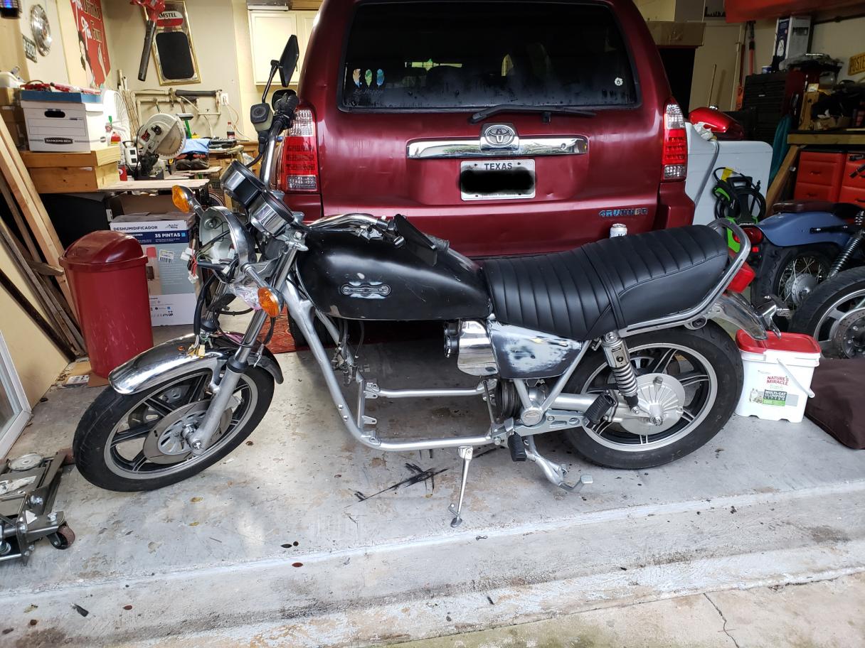

        And Here are a couple of shots of the bike, to date.
        On the Center Stand.
Name:	20210523_On Center Stand.jpg
        ...and on the Side Stand. (Nope, did not have the center stand spring handy)
Name:	20210523_On Side Stand.jpg

            Hey DiverRay
            I think you were measuring the outer spacer that goes next to the swing arm and the torque plate. I need the dimensions for the Bearing Cap.

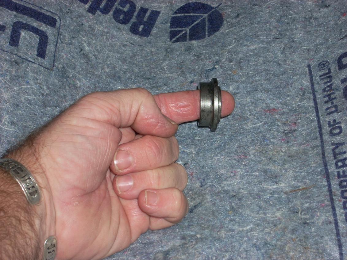

              #36
              Not this...

                Wolf,
                That 'inner' wheel side cap & spacer on a 78' E Standard I am measuring A = 13.5 mm B = 6 mm to the lip of the baseplate (B is 9.5mm all the way to the bottom of the baseplate as I think what you are showing is actually two parts Yama calls Wheel Collar and a Dust Cover)
                The overall OD of the entire piece should be 51 mm and I imagine your is same 51mm
                Unlike what you are showing for the Special the Standard Baseplate is just 2.5 mm deep. I image that 'left side' on your finger. 2.5 mm wide
                Would expect the other dimensions to be the same as the Standard as the right side you are showing goes into the bearing seal then up against the spacer in the wheel. The 51 mm OD fits over the seal.
                Hope that is helpful. Hope somebody and confirm.

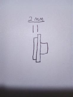

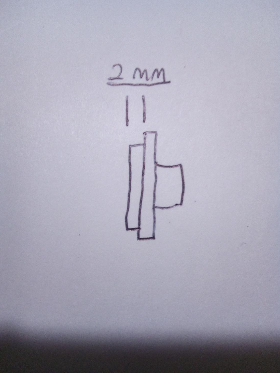

                  Measurement taken on the bike...
                  Click image for larger version  Name:	IMG_20210525_233959.jpg Views:	0 Size:	106.4 KB ID:	865030
                  I would make it 2.5MM to be on the safe side.
                  That is what Jeff got, the 2.5

                    That sounds good, I think you are correct, I had already figured to cut it a little long/thick and test fit, to dial it in. Bikerphil posted some images in my Brake Configuration post, the Standard image is a little fuzzy but it looks to be about two or so.
