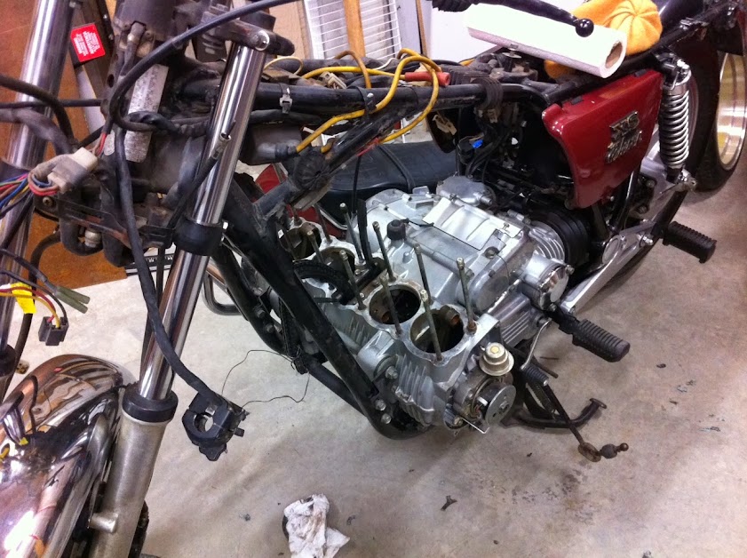

                Some progress
                Hi all,
                So I managed to get something done on my project over the last few weeks. I have cleaned up and polished some bits and pieces and flushed the brakes.
                I found the matching pistons to the cylinders I bought and they are in great shape. I got the old cylinders off and cleaned the mating surfaces and I took the glaze off the "new" set of cylinders.
                I am now making a copper head gasket partly because I'm cheap and partly because It's fun.
                Results of some cleanup:
                The jugs off. Luckily they came off without too much protest. Those pistons are pretty bagged but the small ends are still tight.
                No sign of original surfaces on those skirts. The rings are new though, just as the seller said. Go figure. Ring grooves are pretty loose.
                The "new" pistons from an '80 with minimal wear. Old '79's in the background. Now I can keep the compression decent.
                Patient awaiting transplant...
