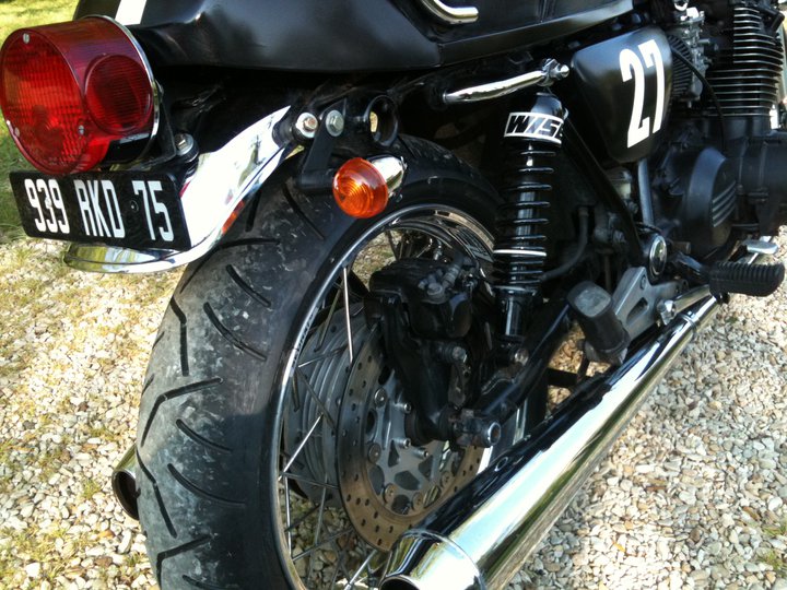

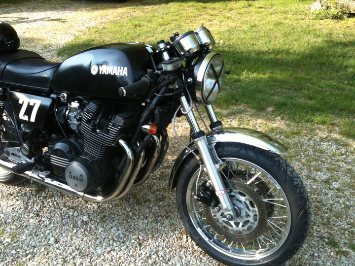

Hi Marcus,
like Nate sez, XS11 Specials have 16" rear wheels.
Also ANY year of XS650 disk brake front wheel will fit.
The pre-1977 34mm fork front wheels including my favorite deep groove aluminum rim wire wheels have a 2-part brake disk that's dished differently
but the disk's bolt circle is the same and later disks will fit perfectly.
My son's 1980 XS650 Special is wearing a pair of those right now.
