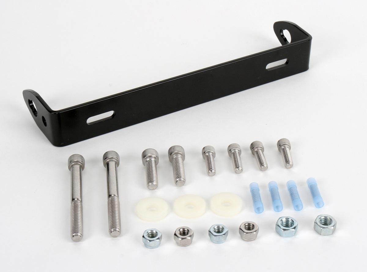

                    • scalded dog
                      • 458
                      ...Dragon, like that look....
                        Saddlemen Turn Signal Relocation Kit
